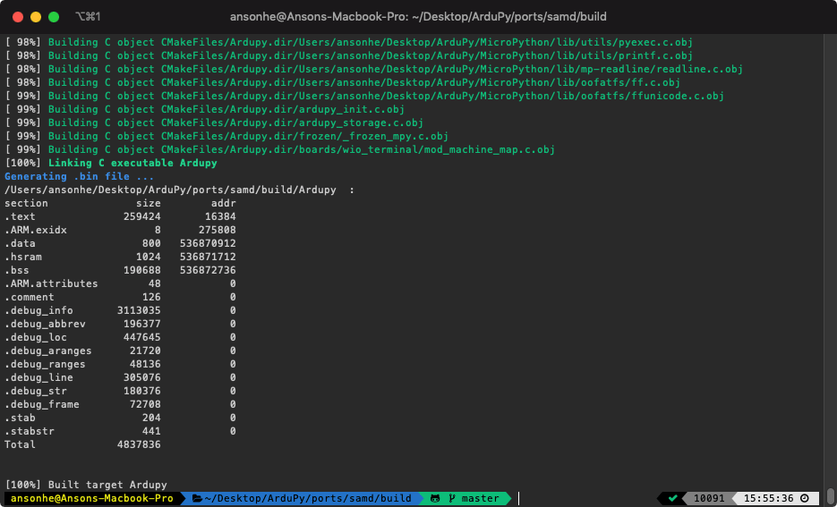

make
This will take a while to compile and generate the ArduPy firmware.

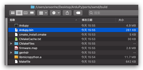

Now you can see that Ardupy.bin is created under the same location!

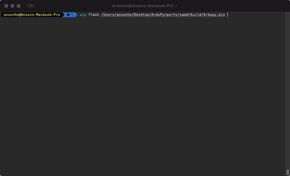

You can use aip to flash the self-built ArduPy firmware to hardware using the following command:
aip flash {path}
For example:
