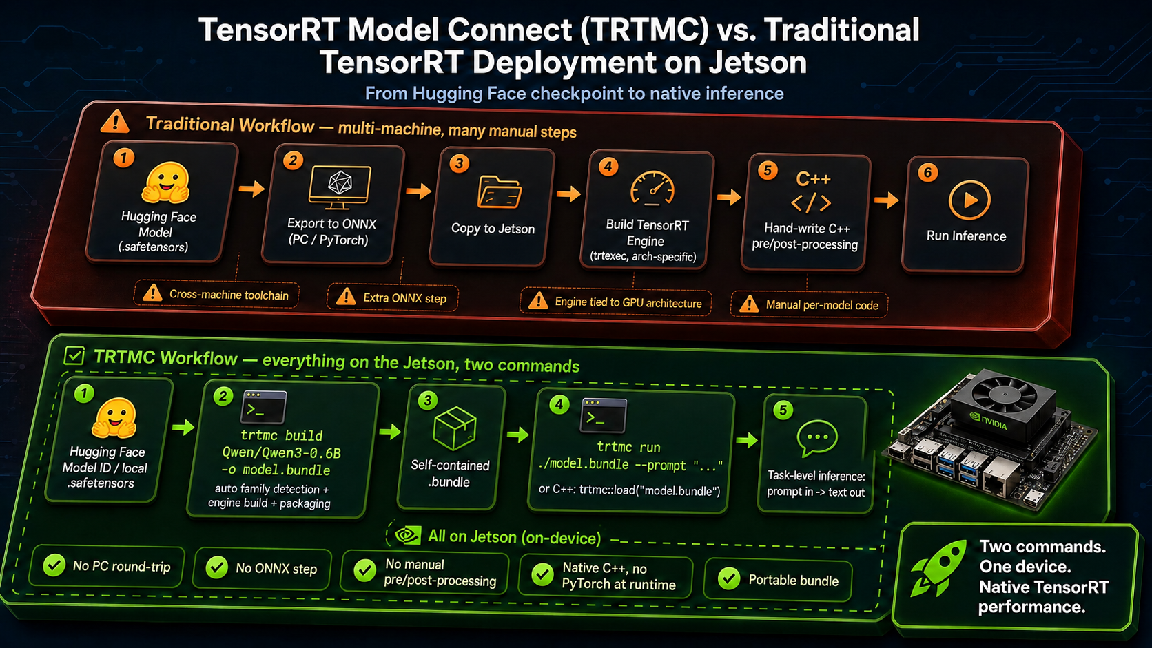

What is TensorRT-Model-Connect?​
TensorRT-Model-Connect is a collection of model-family reference implementations on top of NVIDIA TensorRT. A family-owned builder reads a Hugging Face snapshot, constructs TensorRT engines, and writes a versioned .bundle. The same bundle can be executed from the trtmc CLI or from native C++ task APIs such as text generation.
The practical difference on Jetson is the conversion path. TensorRT Edge-LLM still expects you to quantize and export ONNX on an x86 Linux machine with a discrete GPU, then copy those ONNX files to the device for engine generation. TRTMC builds the engine bundle on the Jetson itself.
flowchart LR
subgraph EdgeLLM["TensorRT Edge-LLM"]
A1["Hugging Face checkpoint"] --> A2["Quantize + ONNX export on x86 GPU"]
A2 --> A3["Copy ONNX to Jetson"]
A3 --> A4["Build engine on Jetson"]
A4 --> A5["llm_inference"]
end
subgraph TRTMC["TensorRT-Model-Connect"]
B1["Hugging Face checkpoint"] --> B2["python -m tensorrt_model_connect build"]
B2 --> B3[".bundle on Jetson"]
B3 --> B4["trtmc run"]
end
TensorRT-Model-Connect on-device conversion compared with an x86 ONNX export path
Why this path is easier on Jetson​
TopicTensorRT Edge-LLMTensorRT-Model-Connect
Where conversion runsONNX export on an x86 Linux host with an NVIDIA GPU, then engine build on JetsonHugging Face snapshot to .bundle on Jetson
Intermediate filesONNX graphs, often tens of gigabytes, copied to the deviceNone. The .bundle is the artifact
Commands after setupExport, copy, build engine, then run llm_inferencepython -m tensorrt_model_connect build and trtmc run
Host memory during conversionVendor docs: FP8 ONNX export can need about 18–20× model size in CPU RAM on the x86 machineMeasured on AGX Orin 64GB for Qwen3-4B FP16: about 30.6 GB host used, 41 GB container peak
Best fitProduction LLM/VLM deployment on JetsonTrying a supported model quickly on the same box that will run it
The memory row is not a same-model bake-off. Edge-LLM’s published ONNX-export numbers explain why that pipeline usually leaves Jetson and occupies a high-RAM workstation. TRTMC’s numbers below are what we actually observed while building Qwen3-4B FP16 on AGX Orin 64GB.

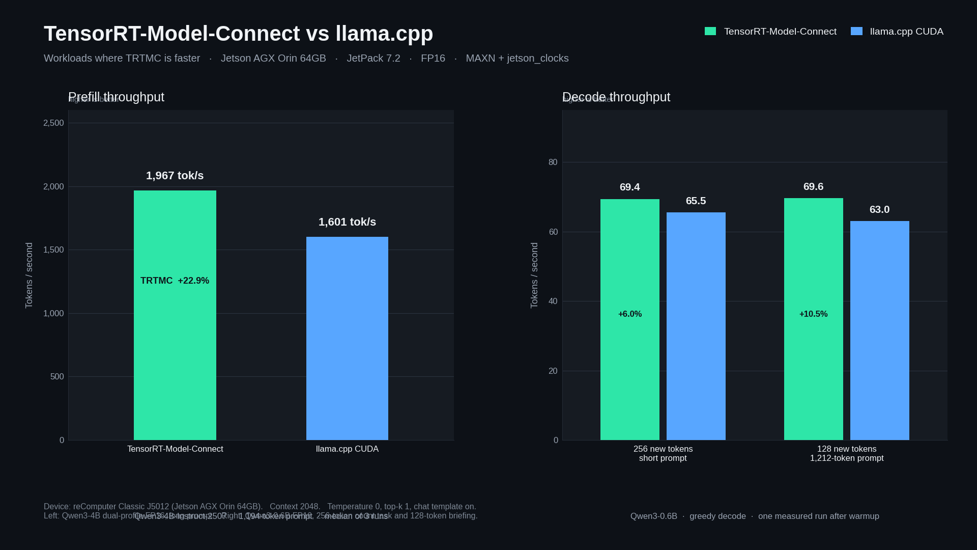

Inference performance vs llama.cpp​
Conversion convenience is only half of the story. On the same J5012 we compared TRTMC FP16 with llama.cpp CUDA + flash-attention FP16, both at context 2048. The chart and table below keep only the workloads where TRTMC is faster.
TensorRT-Model-Connect vs llama.cpp on Jetson AGX Orin 64GB: Qwen3-4B prefill and Qwen3-0.6B decode
WorkloadTensorRT-Model-Connectllama.cpp CUDATRTMC advantage
Qwen3-4B-Instruct-2507 long prefill1,967 tok/s · 606.9 ms / 1,194 tok1,601 tok/s · 743.2 ms / 1,190 tok+22.9%
Qwen3-0.6B decode, 256 new tokens69.4 tok/s65.5 tok/s+6.0%
Qwen3-0.6B decode after a 1,212-token prompt69.6 tok/s63.0 tok/s+10.5%
The 4B prefill result is the median of three measured runs after one warmup. The 0.6B decode results are one measured run after warmup, with the model kept loaded for the whole request so KV cache is filled once and then many tokens are generated.

1. Qwen3-4B long prefill​
This is the workload where a batched TensorRT prefill engine helps. Build the FP16 bundle from section 4 with --max-sequence-length 2048, convert the same snapshot to GGUF F16, then feed both runtimes the same long prompt.
Shared setup for this row:
  • Model: Qwen/Qwen3-4B-Instruct-2507, FP16, context 2048
  • Prompt: about 6,000 background characters plus a 70-word Paris question (1,190–1,194 tokens after the chat template)
  • Decode: 64 new tokens, greedy (temperature=0, top-k=1)
  • TRTMC: dual-profile bundle, chat template on, thinking off
  • llama.cpp: GGML_CUDA=ON, GGML_CUDA_FA=ON, -ngl 99 -c 2048 -b 512 -ub 512 -fa on --jinja
  • Warmup 1 + measured 3; use the median
Convert the same Hugging Face snapshot to GGUF F16 for llama.cpp:
python3 convert_hf_to_gguf.py Qwen3-4B-Instruct-2507 \
--outfile Qwen3-4B-Instruct-2507-F16.gguf \
--outtype f16
Write the long prompt, then run TRTMC. Read [trtmc-perf] Prefill (or the qwen prefill engine timing).
python3 - <<'PY'
from pathlib import Path
filler = (
"Transit planners track on-time performance, bus bunching, depot energy use, "
"and spare-ratio policy across a dense coastal city. Housing staff compare "
"permit latency, vacancy, and school-capacity constraints. Emergency managers "
"rehearse flood gates, hospital diversion, and radio fallback. "
question = (
"Write a 70-word factual paragraph about Paris. Include the Seine, the Louvre, "
"and why it became the capital of France. Do not use bullet points. "
"Do not stop after one word."
body = "Use the background notes only as context. Ignore them if they are not needed.\n\n"
while len(body) < 6000:
body += filler
Path("qwen3-4b-long-prompt.txt").write_text(body[:6000] + "\n\n" + question)
print("wrote qwen3-4b-long-prompt.txt", 6000 + 2 + len(question), "chars")
PY
PROMPT="$(cat qwen3-4b-long-prompt.txt)"
trtmc run ./qwen3-4b-instruct-2507.bundle \
--runtime-root "$PWD/build-sm${TRTMC_SM}" \
--prompt "$PROMPT" \
--use-chat-template true \
--enable-thinking false \
--temperature 0 \
--top-k 1 \
--max-new-tokens 64
Same prompt on llama.cpp. Read the prompt eval time / Prompt: tok/s line, not the process lifetime.
llama-completion \
-m Qwen3-4B-Instruct-2507-F16.gguf \
-ngl 99 -c 2048 -b 512 -ub 512 -fa on \
--jinja --temp 0 --top-k 1 -n 64 \
--no-warmup --simple-io --no-display-prompt \
--prompt "$PROMPT"
On the verified J5012 this is 1,967 tok/s vs 1,601 tok/s prefill.

Read TRTMC qwen decoder / [trtmc-perf] Decode, and llama.cpp eval time / Generation: tok/s. On the verified J5012 this is 69.4 vs 65.5 tok/s for 256 new tokens, and 69.6 vs 63.0 tok/s after the 1,212-token prompt.
What the numbers mean​
  • Fewer machines. You do not need an x86 GPU workstation just to export ONNX. The Jetson that will serve the model can also build it.
  • Lower conversion host RAM than the Edge-LLM FP8 ONNX path. Edge-LLM documents CPU RAM up to about 20× model size for FP8 ONNX export. The Qwen3-4B FP16 TRTMC build stayed around 31 GB host used / 41 GB container on Orin 64GB.
  • Faster long prefill on Qwen3-4B than llama.cpp FP16, which is the workload where a batched TensorRT engine helps.
  • Faster greedy decode on Qwen3-0.6B when the whole completion runs in one request (256 new tokens, or 128 new tokens after a long prompt).
  • A reusable artifact. The .bundle is what you copy, inspect, and run. There is no parallel ONNX tree to keep in sync.
