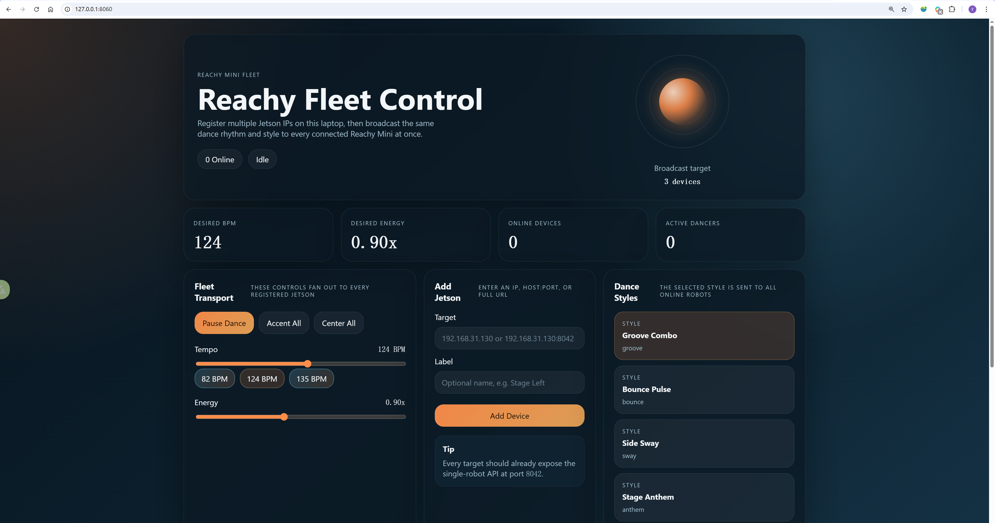

Fleet Dashboard Features​
The dashboard supports:
  • adding Jetson IPs, host:port, or full URLs
  • removing offline or unused Jetson nodes
  • monitoring online status and latency per robot
  • broadcasting dance commands to every registered Reachy Mini
  • keeping the device list in a local state file
The device list is stored locally on Windows at:
C:\Users\<username>\.reachy_fleet_control\fleet_state.json

Step 1. Add Jetson Devices​
In the Fleet Control page:
  • enter a Jetson IP such as 192.168.1.130
  • optionally add a label
  • click Add Device
Repeat the same step for every Jetson on the LAN.
Step 2. Check Online Status​
Each device card will show:
  • endpoint
  • label
  • online or offline state
  • current BPM
  • beat count
  • latency
If a device is offline, the dashboard will keep it in the list and continue polling until it comes back.
Step 3. Broadcast a Dance Command​
Use the shared controls to update all robots at once:
  • Start Dance
  • Pause Dance
  • Accent All
  • Center All
  • BPM presets: 82, 124, 135
  • style selection: groove, bounce, sway, anthem
  • energy slider
Step 4. Observe the Fleet​
When the broadcast succeeds:
  • all online Reachy Mini robots switch to the same desired BPM
  • the selected style is applied to all robots
  • the active device count updates in the dashboard
  • each Jetson continues generating motion locally, so small network jitter does not stop the dance loop
