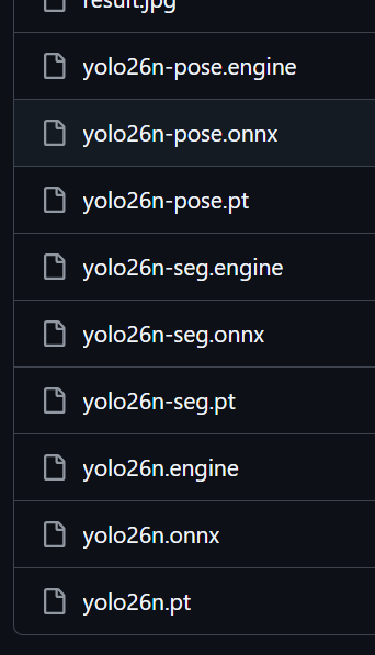

Step 9: Prepare Model Files
ls -la /home/seeed/ultralytics_data/
mkdir -p /home/seeed/ultralytics_data
If model files don't exist, download them first:
cd /home/seeed/ultralytics_data
yolo export model=yolov26n.pt format=engine device=0 half=True
yolo export model=yolov26n-pose.pt format=engine device=0 half=True
yolo export model=yolov26n-seg.pt format=engine device=0 half=True
ls -la
You should see the following files:
yolov26n.engineyolov26n-pose.engineyolov26n-seg.engine

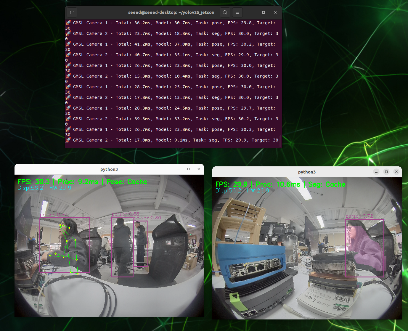

Step 10: Run Local Script
cd /home/seeed/yolov26_jetson
chmod +x run_dual_gmsl_local.sh
./run_dual_gmsl_local.sh
Configuration & Running
The system uses run_dual_gmsl_local.sh which is pre-configured for the SG3S-ISX031C camera.
Camera Configuration Details
| Parameter | Value | Note |
| Camera Model | SG3S-ISX031C-GMSL2F | Sensing GMSL2 Camera |
| Capture Resolution | 1920 x 1536 | Full Sensor Resolution |
| Capture FPS | 30 FPS | Native Frame Rate |
| Process Resolution | 640 x 480 | Downscaled via Hardware (VIC) for Inference |
| Pixel Format | YUY2 | Converted to BGR via Hardware |
Running the System
