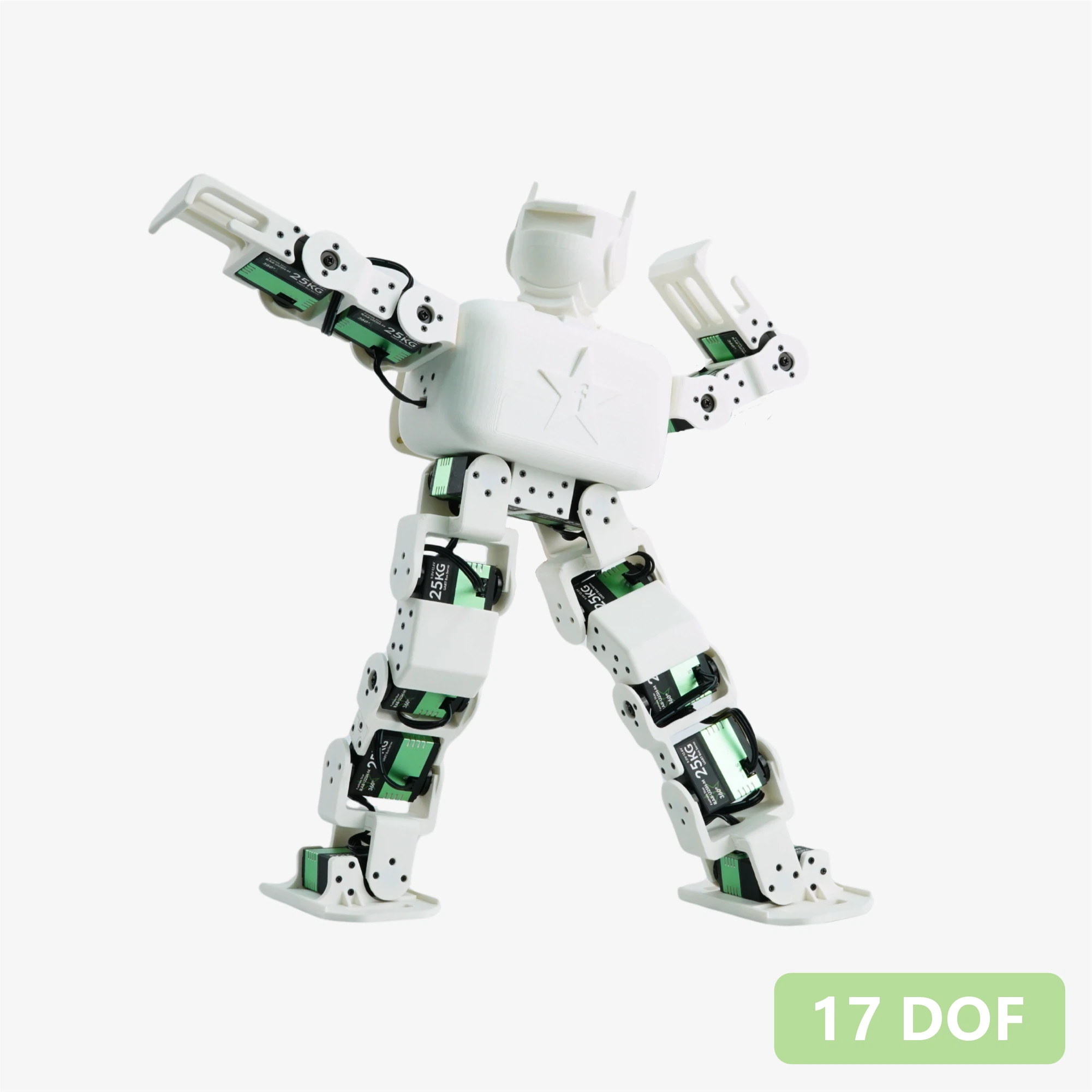

Atom X is an open-source 17-Degree-of-Freedom (DOF) bipedal humanoid robot kit designed for robotics developers, makers, and educational institutions. The robot is driven by 17 Fashionstar RA8-U25H-M bus servo motors, featuring a fully 3D-printed open-source structure. It is equipped with a Seeed Studio XIAO ESP32-S3 main controller and Grove expansion board, with complete control firmware pre-installed from the factory. Its Web visual motion editor supports browser-based real-time debugging, teach programming, and JSON export, facilitating cross-platform secondary development. The included RUC-01 adapter board provides regulated power supply and UART interfaces, and supports Bluetooth/Web remote control. Ready to use out of the box, it is an ideal platform for motion algorithm verification and desktop robot development.
1. Product Introduction​
  • DOF Configuration: 17 DOF in total, covering arm, torso, and leg joints.
  • Structure and Appearance: Fully 3D-printed structure with officially open-sourced STP/STL model files, facilitating part replacement, structural reinforcement, and exterior redesign.
  • Joint Actuators: Fashionstar RA8-U25H-M bus servo motors × 17 (supporting bus communication with simplified wiring).
  • Web Visual Motion Editor: Provides a browser-based control platform requiring no installation, supporting real-time servo debugging and teach-mode programming. Completed motion groups can be exported as standard .json format files for easy parsing and integration by various main controllers (such as Arduino, STM32, Raspberry Pi).
  • Ready to Use Out of the Box: Pre-configured with the Seeed Studio XIAO ESP32-S3 as the main controller, with factory demonstration programs provided.
  • Multi-Module Expansion: Paired with the Seeed Studio XIAO expansion board featuring onboard Grove interfaces for connecting Seeed Grove series sensors/controller modules.
  • Ecosystem Expandability: Through the Grove interfaces on the Seeed Studio XIAO expansion board, vision, environmental perception, and other Grove ecosystem sensors and control modules can be quickly integrated.
  • Cross-Platform Compatibility: To lower the development threshold, we provide the RUC-01 adapter board with onboard 5V/3.3V power output and UART interfaces. Any controller with serial port functionality can communicate with it!

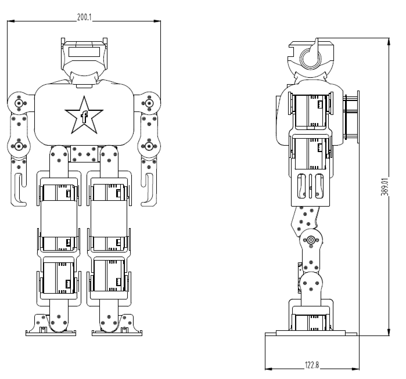

Dimensions200×122×389 mm

4. Dimensions​

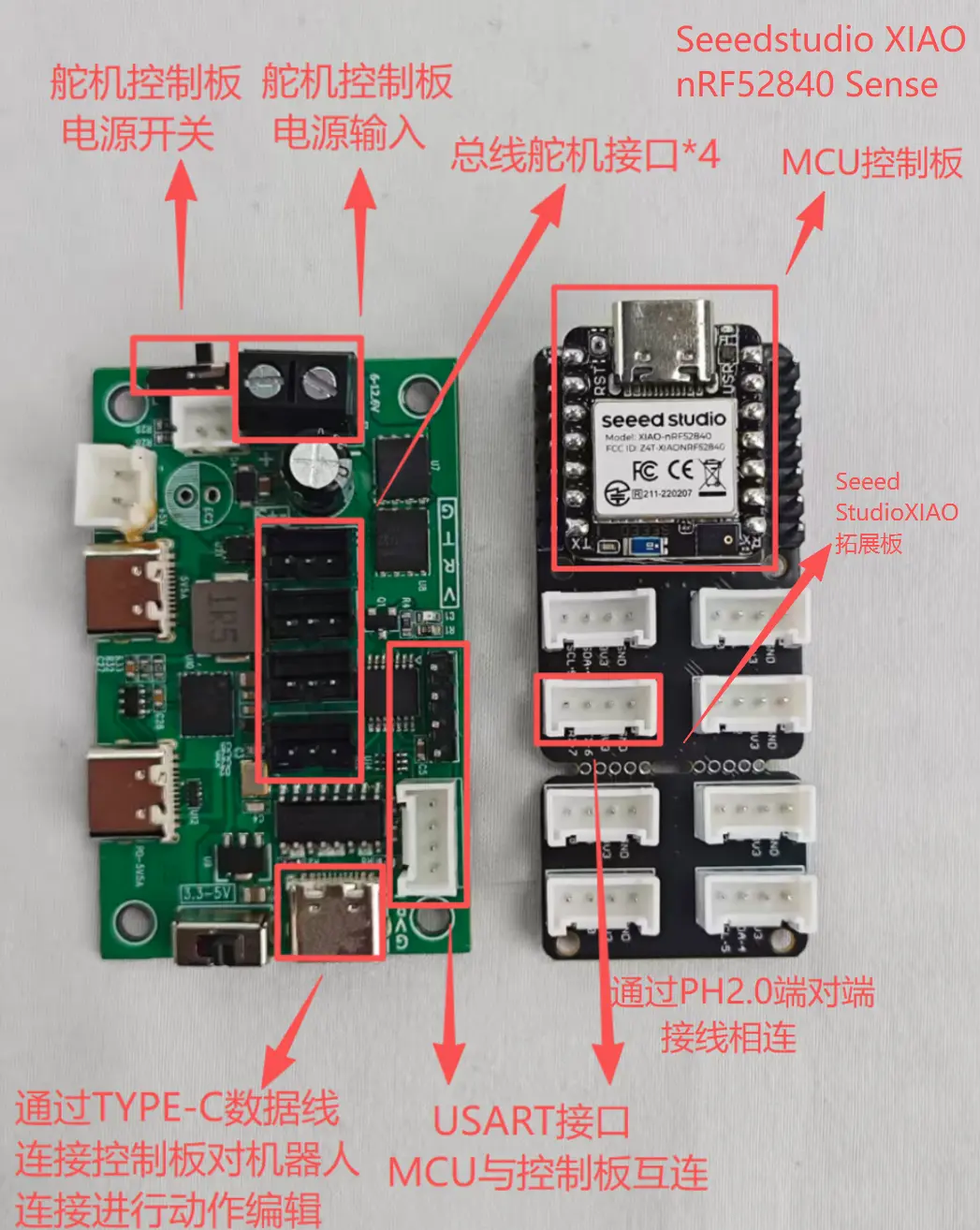

Drive and Power Management (RUC-01 Interface Board)​
Serving as the robot's power hub, the Drive and Power Management (RUC-01 Interface Board) module is responsible for bus communication management and power distribution:
  • Servo Communication: 4 onboard bus servo interfaces (supporting daisy-chain expansion) responsible for signal and power delivery to the 17 bus servo motors.
  • PC Debug Interface: Integrated USB Type-C port for direct connection to a PC host for motion group editing and debugging.
  • System Power Supply: Handles voltage conversion and provides stable power input to the main controller board.
  • Communication Interface: Provides a standard UART serial port for receiving control commands from the upper-level main controller board.
Logic Main Controller and Expansion (MCU + Grove Shield)​
Serving as the robot's "brain", the Logic Main Controller and Expansion (MCU + Grove Shield) is responsible for running control algorithms and processing sensor data:
  • Core Controller: Utilizes the Seeed Studio XIAO series development board, compact in size yet powerful in performance.
  • Ecosystem Expansion: Paired with a Grove interface expansion board providing abundant general-purpose interfaces.
  • Primary Functions: Runs robot kinematics programs and seamlessly connects to various sensors (such as ultrasonic, vision, voice modules, etc.) through Grove interfaces to achieve complex interactive functions.

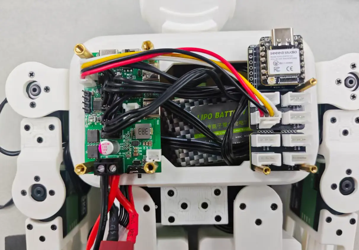

Data Flow Description​
Debug/Edit Mode (Debug Mode)
PC --(USB)--> RUC-01 --(Bus)--> Servos
Description: Directly adjust servo angles and save motion groups via PC software, bypassing the XIAO main controller.
Autonomous Mode (Autonomous Mode)
Sensor / Remote --(Signal)--> XIAO --(UART Command)--> RUC-01 --(Bus)--> Servos
Description: The XIAO main controller autonomously controls the robot's actions based on sensor feedback or pre-stored code.

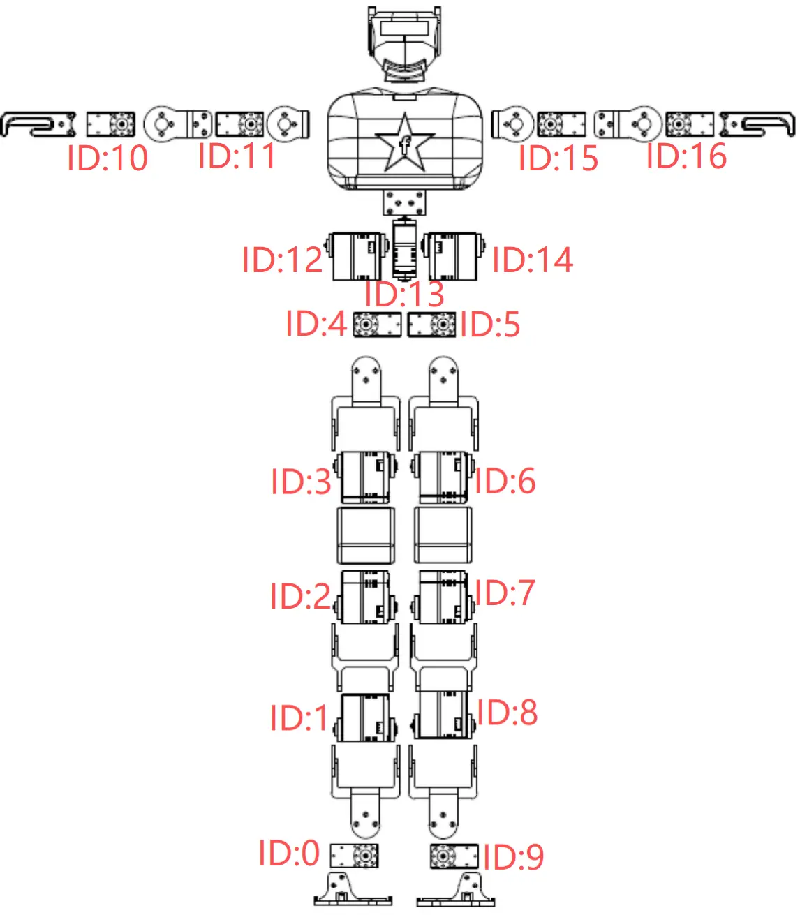

  • Robot structure display and default servo ID numbering

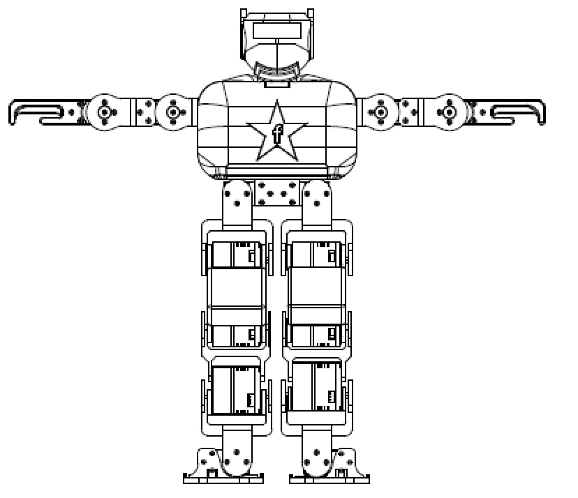

  • Robot posture when all servo motors are at zero degrees
