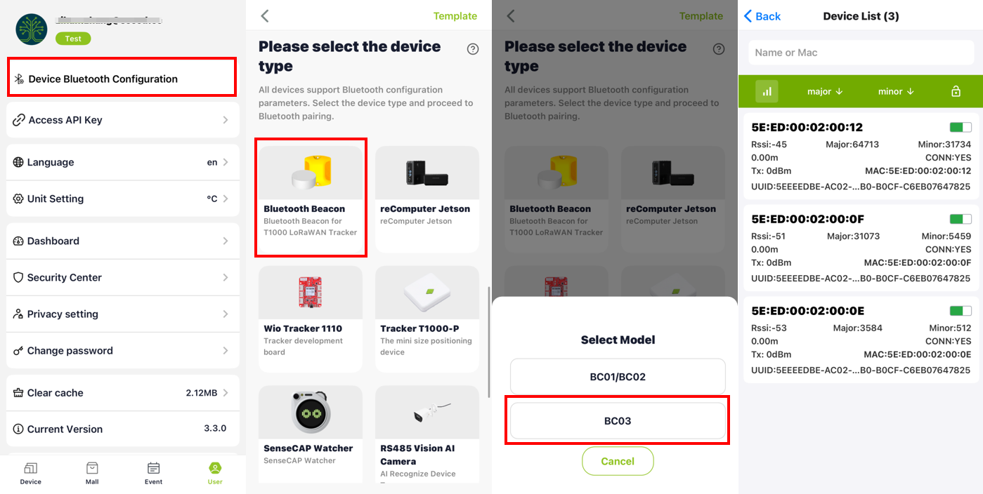

  • Step 2: Connect the Beacon & Configuration
On the User page, click Device Bluetooth Configuration, then select Bluetooth Beacon and choose BC03. Then enter the Device List page.
Configuration1
Based on the device's MAC address, select the Beacon to be configured.
Configuration1

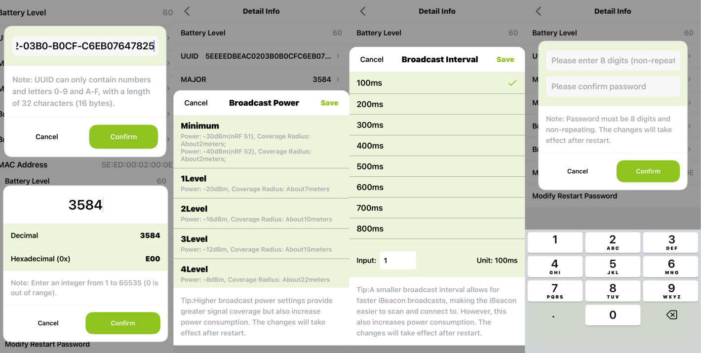

You can modify the device's UUID, MAJOR, MINOR, Broadcast Power, Broadcast Interval, and password.
Configuration1

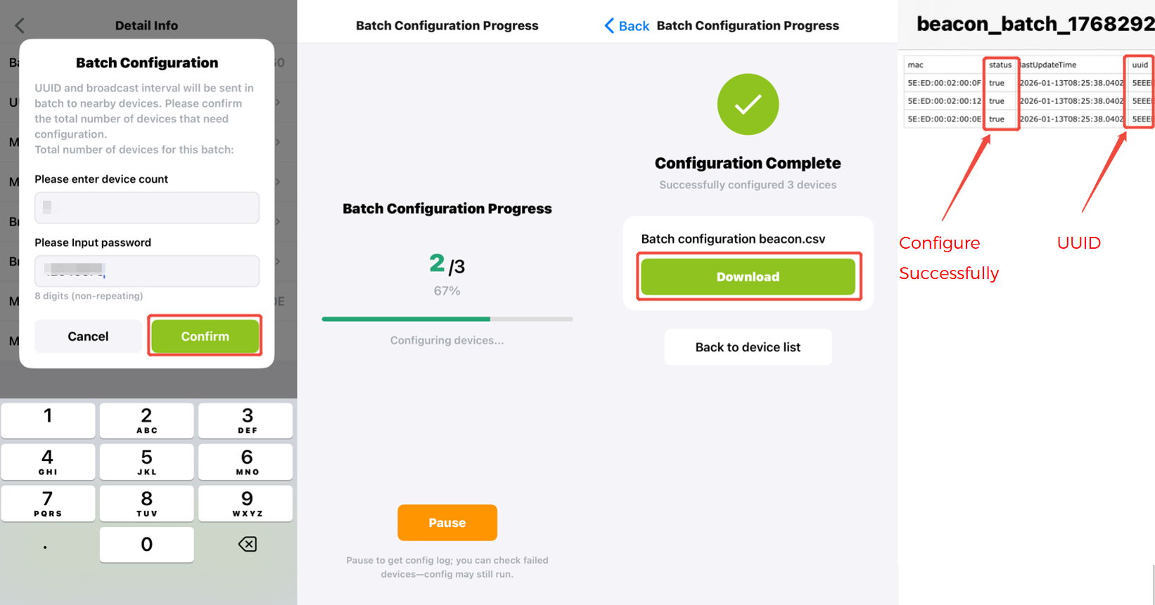

Batch Configuration
Click Save & Batch Configuration, enter the number of devices and password, then begin the batch configuration. Once the progress bar completes, you can download the batch configuration beacon file and review the configuration status.
Configuration1

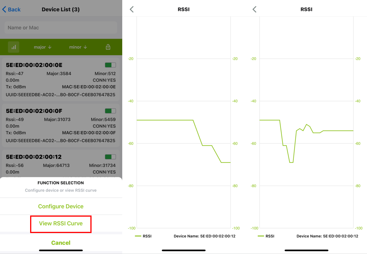

  • Step 3: View RSSI Curve
Choose the beacon, click RSSI Curve. You can view the dynamic RSSI curve.
Configuration1
