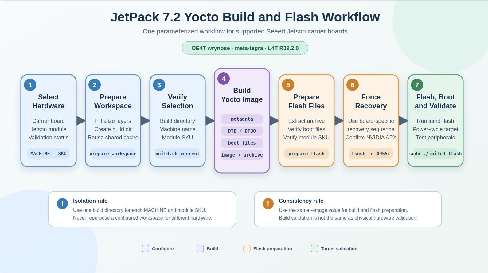

The following diagram summarizes the full workflow. Select the carrier board and Jetson module first, then keep the same machine, SKU, build directory, and image recipe through building and flashing.
JetPack 7.2 Yocto build and flash workflow for Seeed Jetson carrier boards
