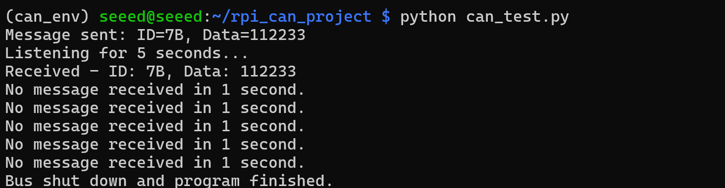

CAN 测试​
回环测试​
端口数量DI 端口对应扩展 GPIO
4CAN-0_H/CAN-0_can0

Python-CAN 测试​
Python-CAN 是一个跨平台的 Python 库,为控制器局域网(CAN)总线通信提供统一的编程接口,支持多种 CAN 硬件接口和虚拟总线,可轻松实现 CAN 报文的发送、接收、过滤、总线监控等操作。 同样,需要将 CAN 接口在物理上连接起来,以实现回环通信。
  1. 配置标准 CAN 波特率(500 kbit/s):
sudo ip link set down can0
sudo ip link set down can1
sudo ip link set can0 type can bitrate 500000
sudo ip link set can1 type can bitrate 500000
sudo ip link set up can0
sudo ip link set up can1
  1. 验证两个接口是否处于 UP 状态:输出 "state UP" 表示为 UP 状态。
ip a show can0
ip a show can1
  1. 配置 Python 虚拟环境和依赖。
mkdir rpi_can_project
cd rpi_can_project
python3 -m venv can_env
source can_env/bin/activate
pip install python-can
  1. 输入 Python 脚本:
# can_test.py
import can
import time
# create a bus instance using 'with' statement,
# this will cause bus.shutdown() to be called on the block exit;
# many other interfaces are supported as well (see documentation)
with can.Bus(interface='socketcan',
channel='vcan0',
receive_own_messages=True) as bus:
# send a message
message = can.Message(arbitration_id=0x7B, is_extended_id=True,
data=[0x11, 0x22, 0x33])
try:
bus.send(message, timeout=0.2)
print(f"Message sent: ID={message.arbitration_id:X}, Data={message.data.hex()}")
except can.exceptions.CanOperationError as e:
print(f"Error sending message: {e}")
# iterate over received messages
print("Listening for 5 seconds...")
start_time = time.time()
while time.time() - start_time < 5:
if msg:
print(f"Received - ID: {msg.arbitration_id:X}, Data: {msg.data.hex()}")
else:
print("No message received in 1 second.")
print("Bus shut down and program finished.")
  1. 执行运行:
python can_test.py
deactivate
