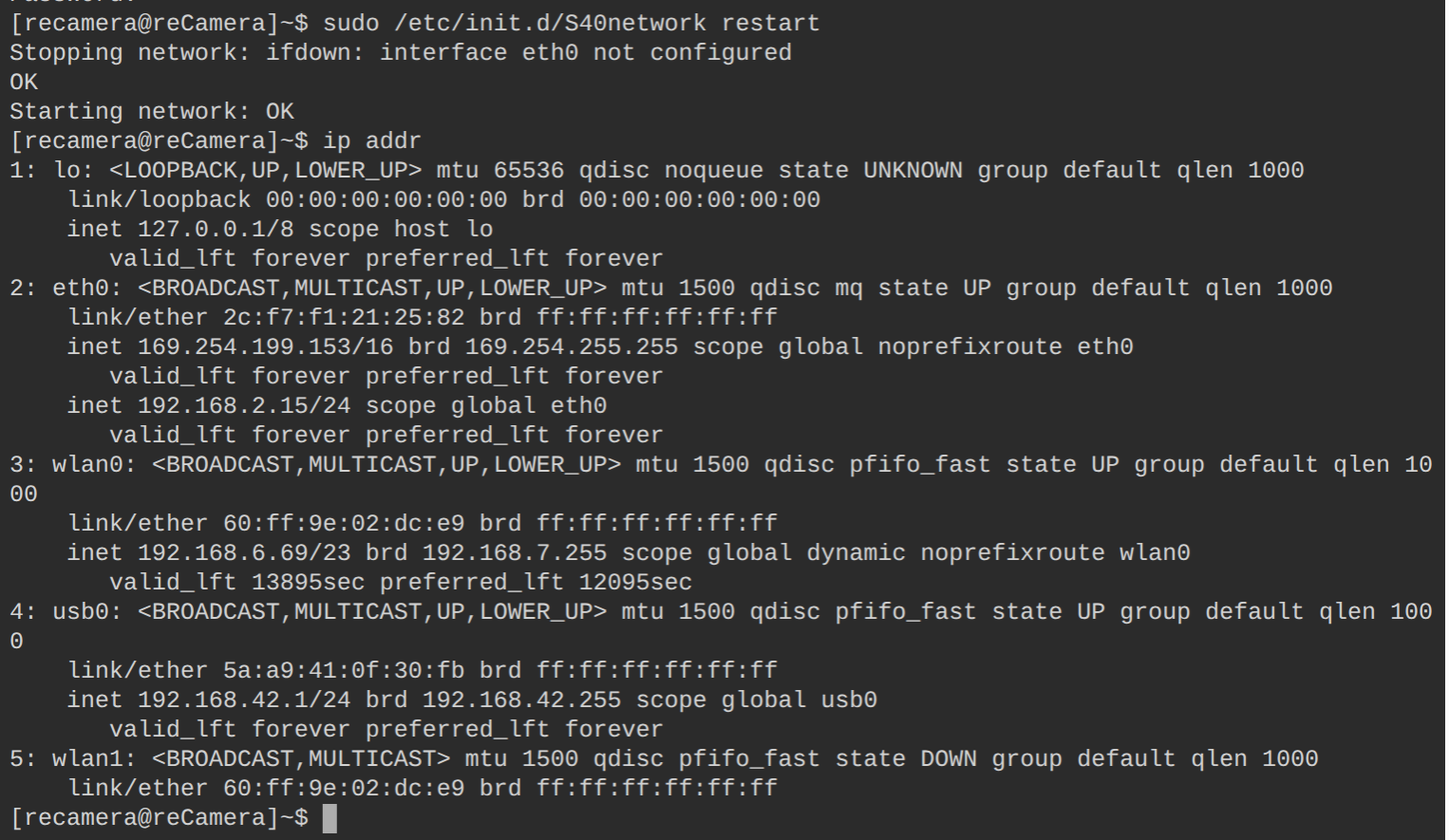

Step 3: Restart networking and verify​
Apply the new settings without rebooting:
sudo /etc/init.d/S40network restart
Then verify the eth0 address:
ip addr show eth0
If the output includes your configured address, the static IP is configured successfully.
