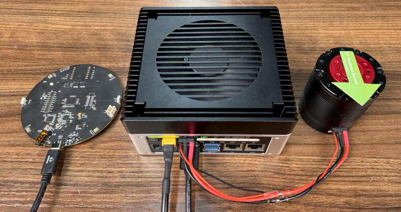

Hardware Connection

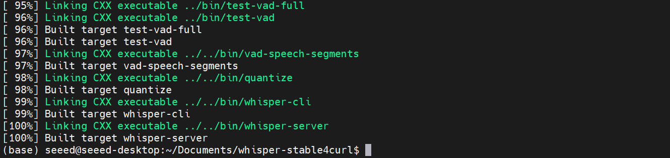

First, we need to install the Whisper service to enable ASR functionality. Please open a terminal window on the Jetson device and run the following command.
git clone https://github.com/jjjadand/whisper-stable4curl
cd whisper-stable4curl
export PATH=/usr/local/cuda-12.6/bin${PATH:+:${PATH}}
export LD_LIBRARY_PATH=/usr/local/cuda-12.6/lib64${LD_LIBRARY_PATH:+:${LD_LIBRARY_PATH}}
cmake --build build -j --config Release
If everything goes well, you will see the following logs in the terminal window.

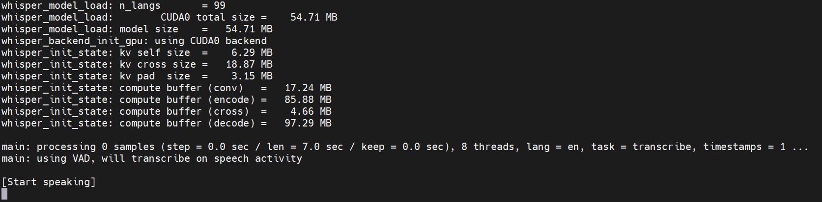

Then we launch the Whisper inference service:
./build/bin/whisper-stream -m ./models/ggml-base.en-q5_1.bin -t 8 --step 0 --length 7000 -vth 0.7 --keep 1200

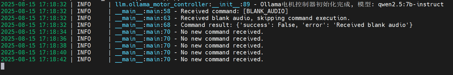

git clone https://github.com/yuyoujiang/voice_control.git
cd voice_control
sudo ip link set can0 type can bitrate 1000000
sudo ip link set can0 up
python app.py
