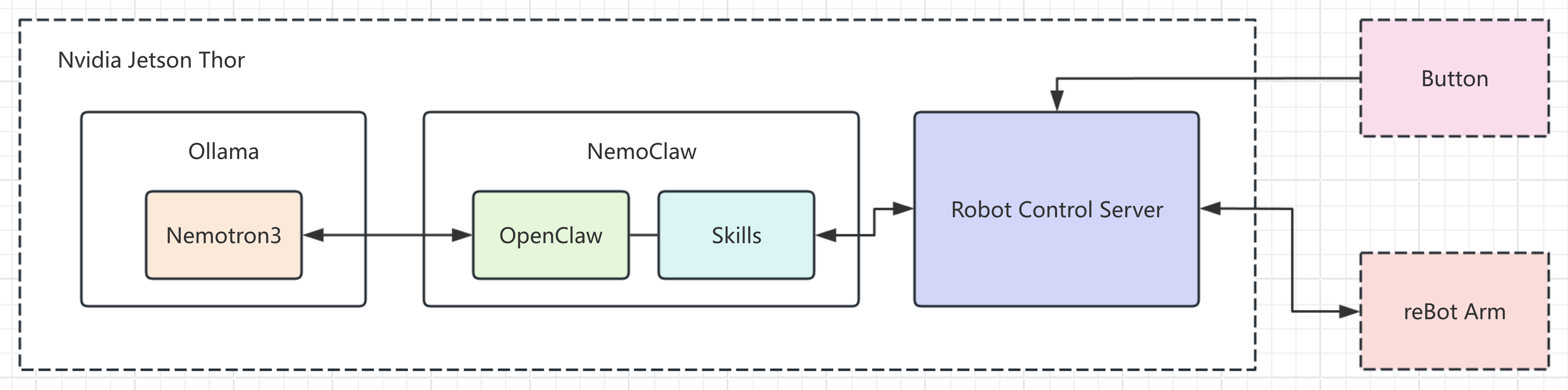

1. Project Overview
NVIDIA NemoClaw is an open-source reference stack that simplifies running OpenClaw always-on assistants more safely. This wiki explains how to deploy NemoClaw on Jetson Thor and connect reBot Arm B601 capabilities into the NemoClaw agent workflow, forming a closed loop of: semantic understanding + visual detection + robotic execution.
NemoClaw: Local agent/control framework for task orchestration and command routing.Nemotron3: Optional model capability for intent understanding and high-level decision making.Nvidia Jetson Thor: Local compute platform for inference, backend services, and device drivers.reBot Arm B601: robotic arm for grasping and placement.

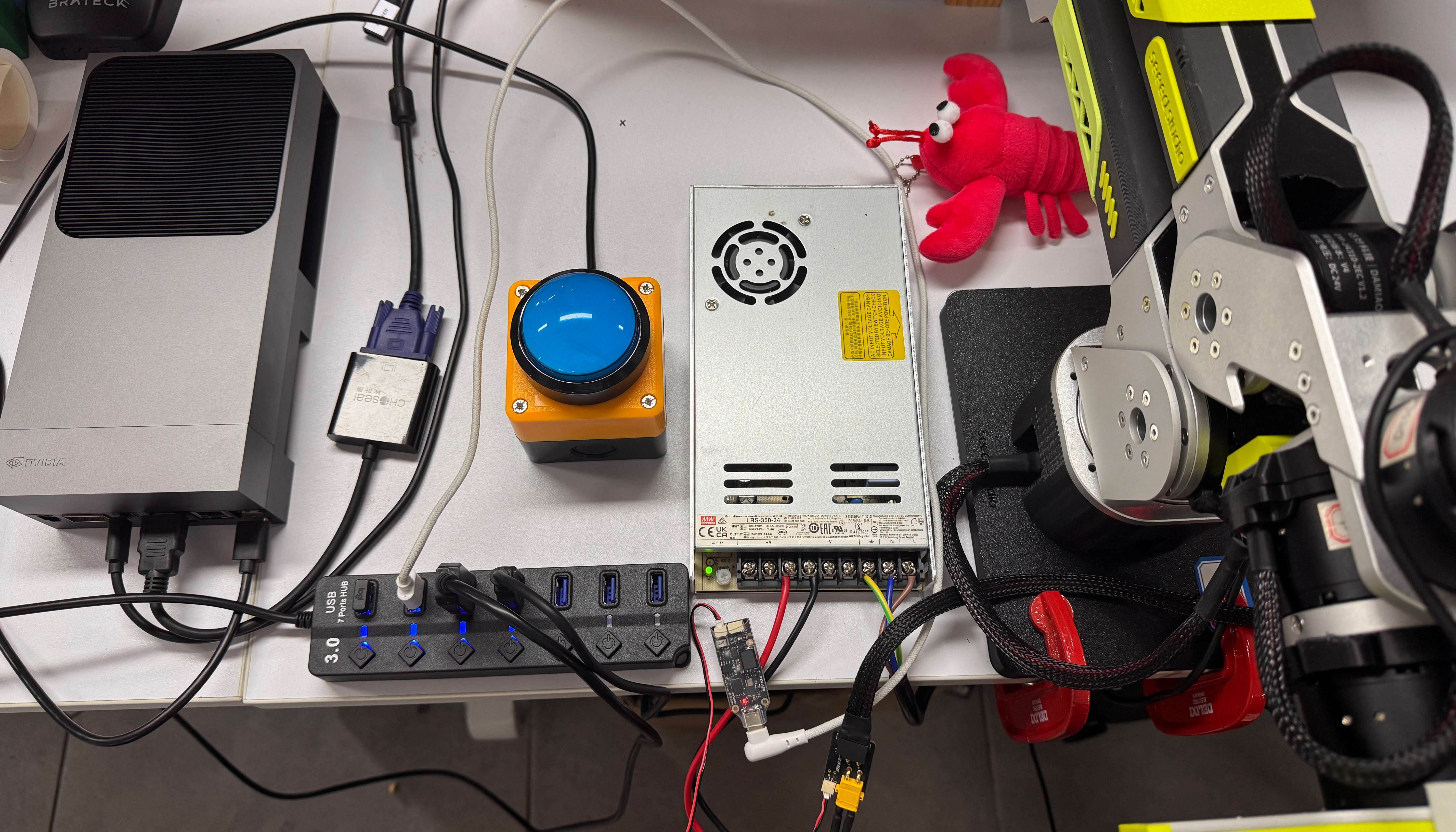

2. Hardware Requirements
- Nvidia Jetson Thor (JetPack 7.x installed)
- reBot Arm B601 DM
- USB-to-CAN adapter
- USB camera
- Power supply and USB cable for the robotic arm
- USB button (optional)
| reBot Arm B601 | NVIDIA® Jetson AGX Thor™ Developer Kit |
3. Hardware Connection
- Assemble and configure the robotic arm.
- Connect the USB-to-CAN adapter, USB camera, and robotic arm to Jetson Thor USB Type-A ports.
Jetson devices may only provide two USB Type-A ports. Use a USB hub if you need more ports.

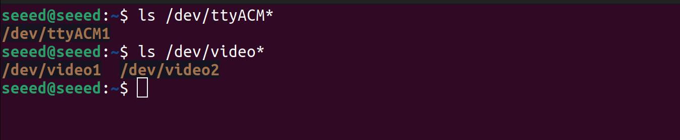

After power-on, verify devices:
ls /dev/ttyACM*
ls /dev/video*
If everything is connected correctly, you should see output similar to:

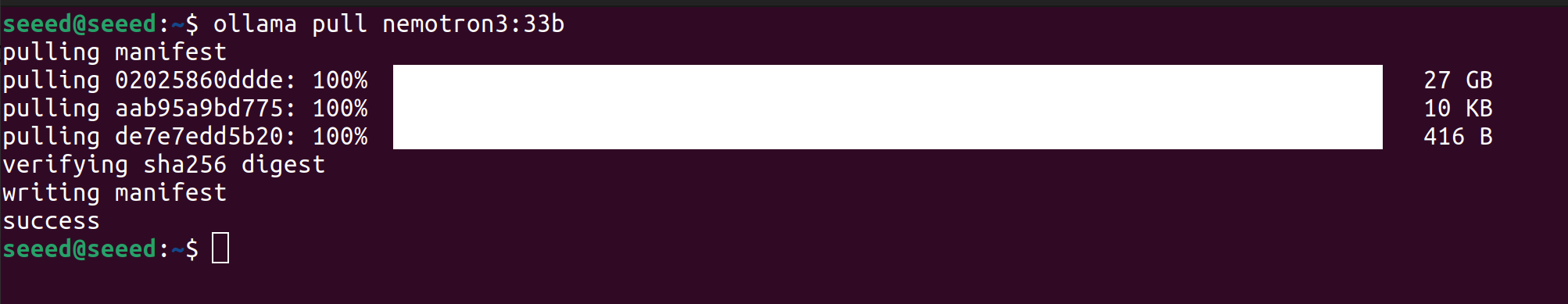

4.1 Install Ollama
If local LLM capability is needed (optional):
curl -fsSL https://ollama.com/install.sh | sh
ollama pull nemotron3:33b

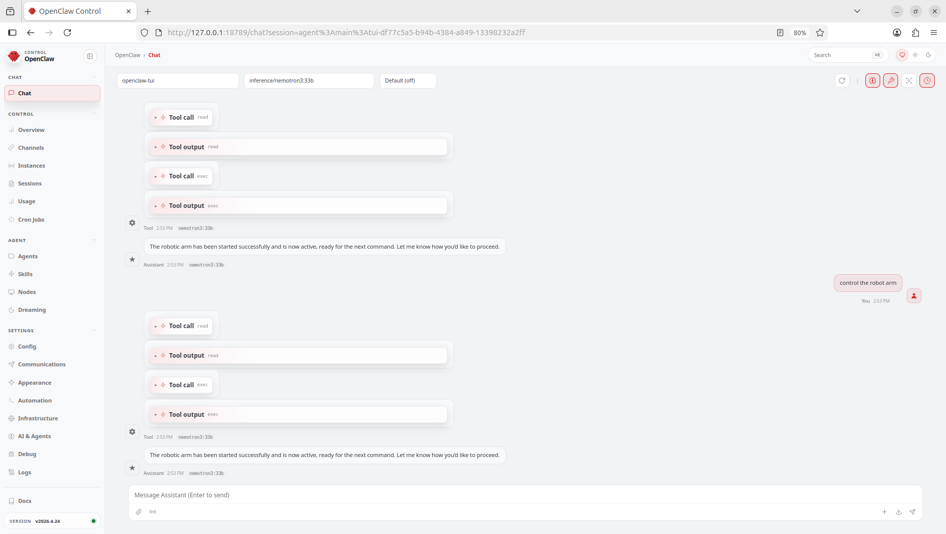

If onboarding succeeds, run:
nemoclaw my-assistant connect
You should enter a working OpenClaw app environment:
More NemoClaw CLI details: https://docs.nvidia.com/nemoclaw/latest/reference/cli-selection-guide.html

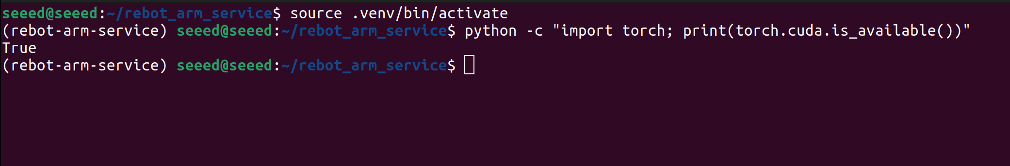

4.3 Install Robotic Arm Service
Run on Jetson:
git clone https://github.com/yuyoujiang/rebot_arm_service.git ~
cd ~/rebot_arm_service
uv sync
# Configure GPU PyTorch runtime libraries
export LD_LIBRARY_PATH=/home/seeed/rebot_arm_service/.venv/lib/python3.12/site-packages/nvpl/lib:/usr/local/lib/ollama/cuda_v12:$LD_LIBRARY_PATH
python -c "import torch; print(torch.cuda.is_available())"
