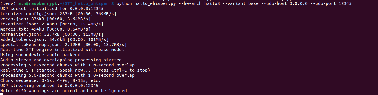

Start the backend.
python hailo_whisper.py --hw-arch hailo8 --variant base --udp-host 0.0.0.0 --udp-port 12345

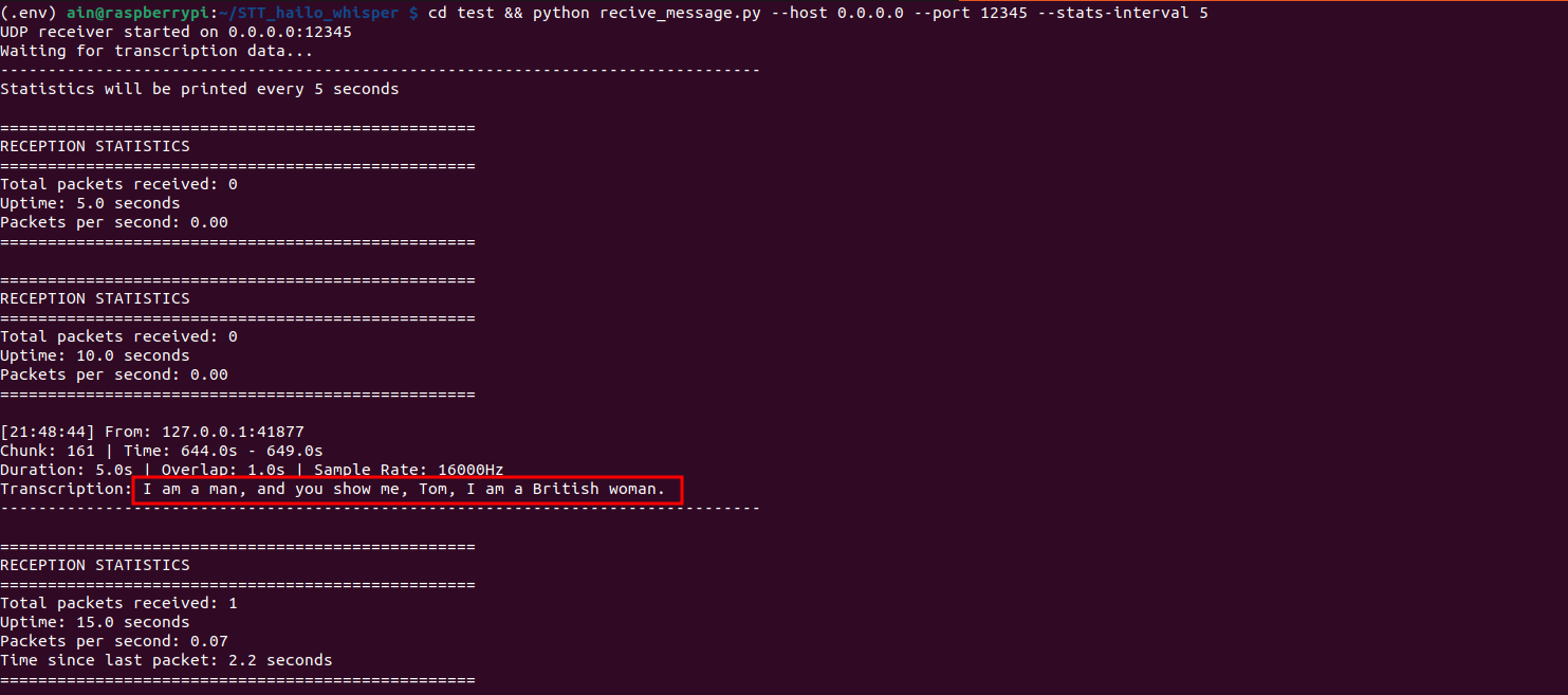

Start the frontend, then you can see real-time STT result.
cd test && python recive_message.py --host 0.0.0.0 --port 12345 --stats-interval 5
