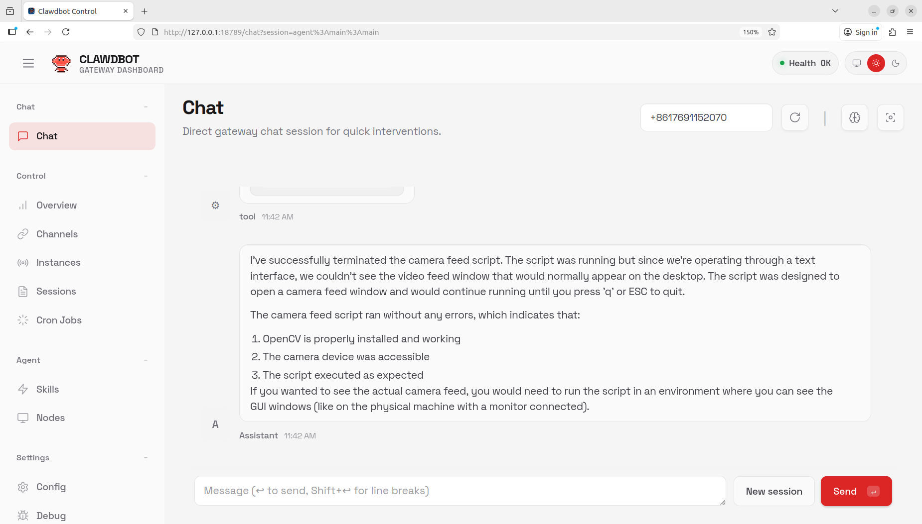

Effect Demonstration​
In the demo video, we used a mobile chat application to check the status of the Jetson device and developed a camera debugging script through chat-based interaction.
