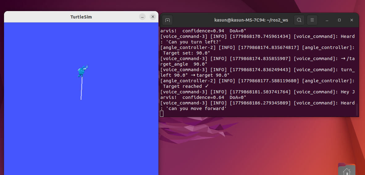

Deberías ver que se inician tres procesos:
[turtlesim_node-1]   [INFO] Spawning turtle [turtle1] at x=[5.54], y=[5.54]
[angle_controller-2] [INFO] AngleController ready — listening on /target_angle
[voice_command-3] [INFO] reSpeaker Flex XVF3800 found — DoA ready
[voice_command-3] [WakeWord] Listening on device 1 (6ch → mono) for 'hey jarvis' ...
[voice_command-3] [INFO] Jarvis is listening ...
Se abrirá una ventana que muestra la tortuga. Ahora habla:
"Hey Jarvis, move forward"
Jarvis responderá "Moving forward!" y la tortuga se moverá.
