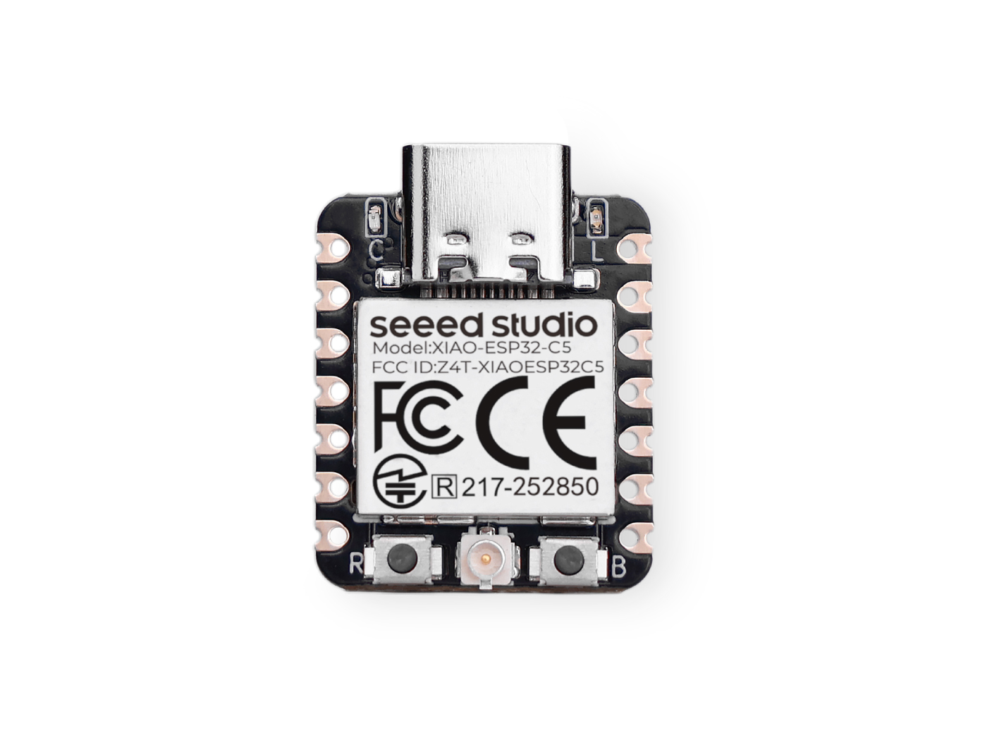

Seeed Studio XIAO ESP32-C5Seeed Studio Grove Base para XIAOGrove - LED Rojo
