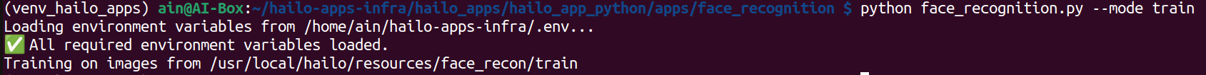

Add information to the database​
cd ~/hailo-apps-infra/hailo_apps/hailo_app_python/apps/face_recognition
python face_recognition.py --mode train
The right result show as bellow:
pir
