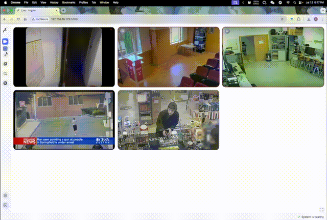

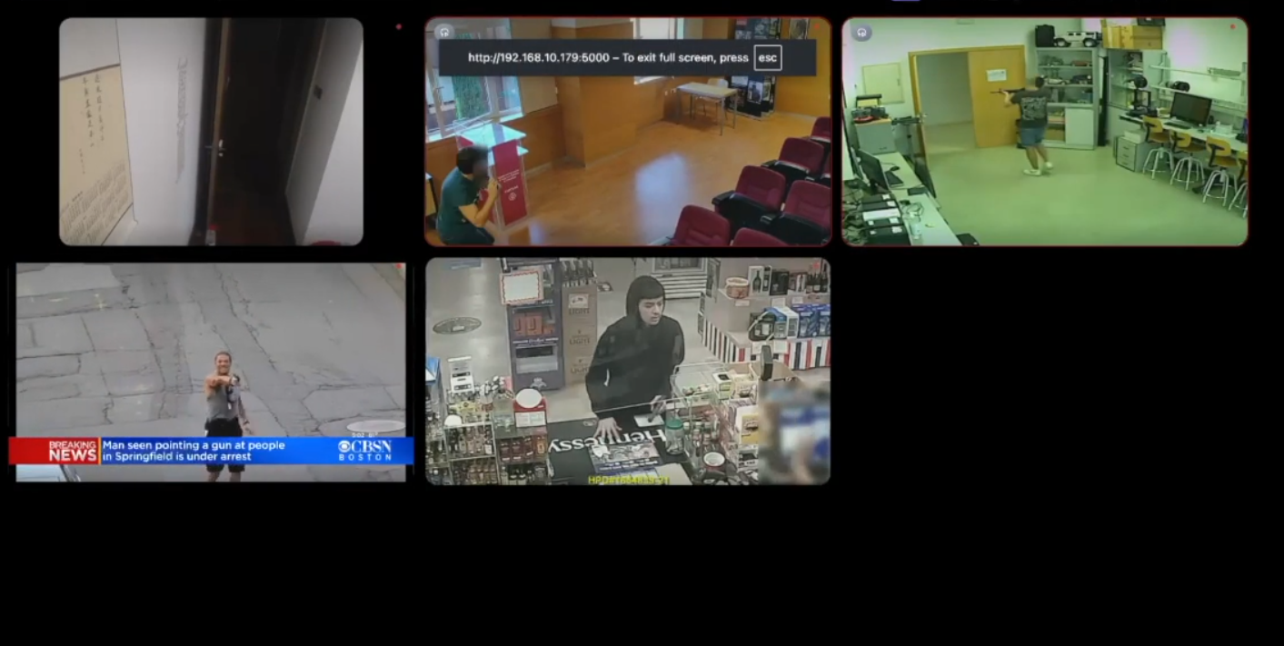

Then open localhost:5000 in the web browser of the AI box:

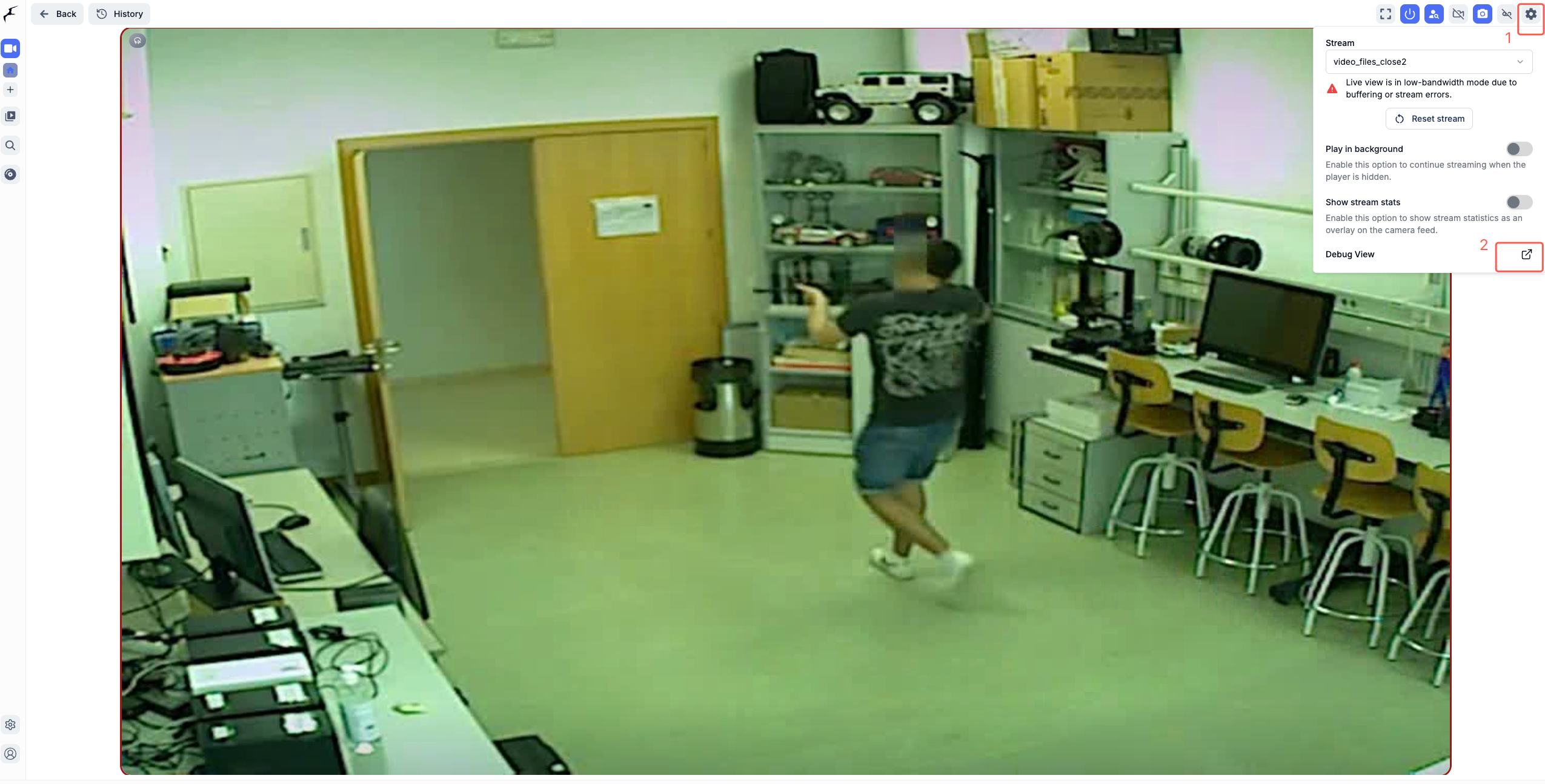

Select one of the videos to start debugging, select the display box, and the results will be automatically displayed:

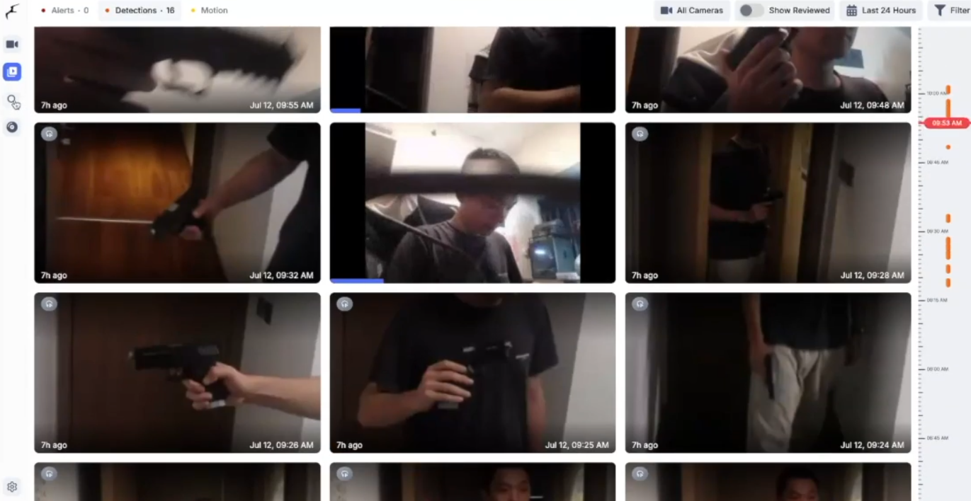

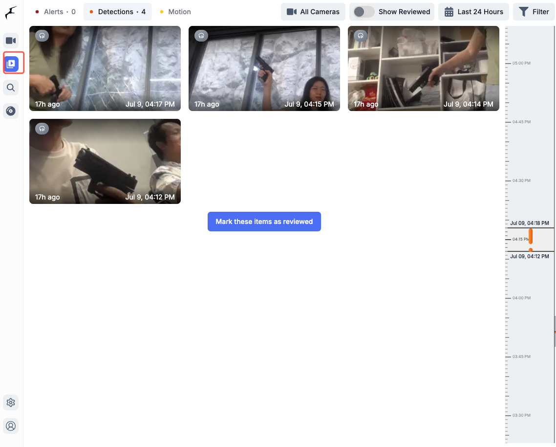

Switch tabs to view past test results:
Result
When it sees someone holding a gun, the model will identify it and select it. Switch to debug mode, select the display box, and the results will be automatically displayed; switch tabs to view past detection results.

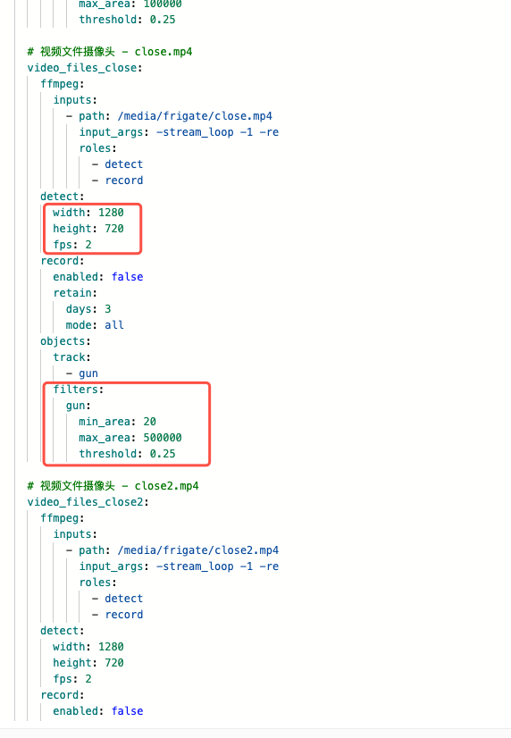

Other configurations
Configuration of other video sourcesFrame rate configuration
Frigate supports RTSP, video streaming, and USB cameras. Once the configuration file is configured, it will take effect after reboot.The configuration file can configure the detection frame rate of each camera, which will take effect after restart.
You can access configuration options in Settings, such as changing the RTSP path to connect to an RTSP camera. Once you've made changes, click Save & Restart in the upper-right corner for the changes to take effect.page
