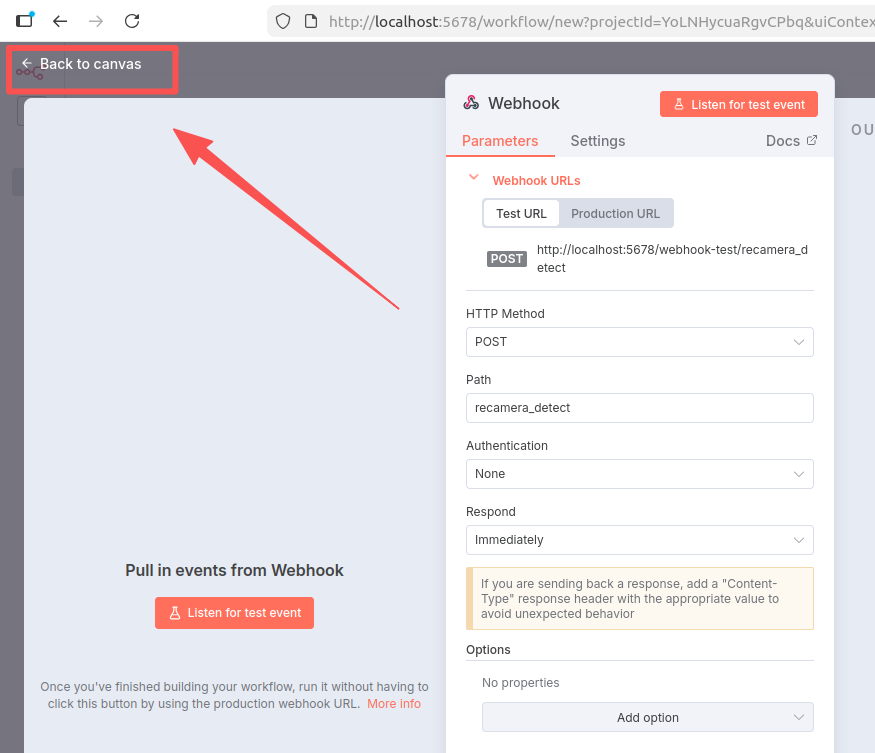

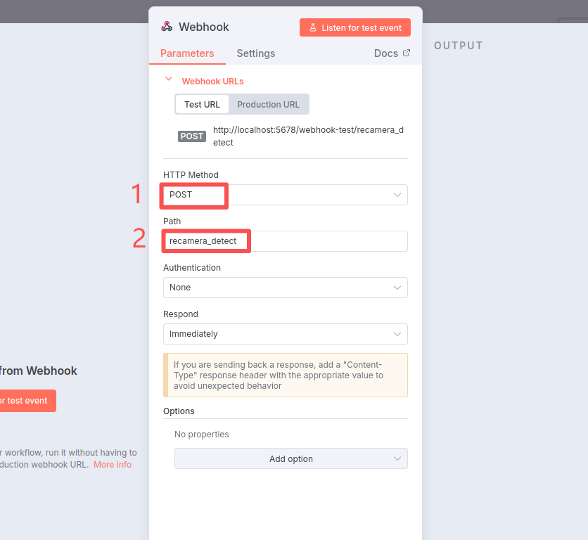

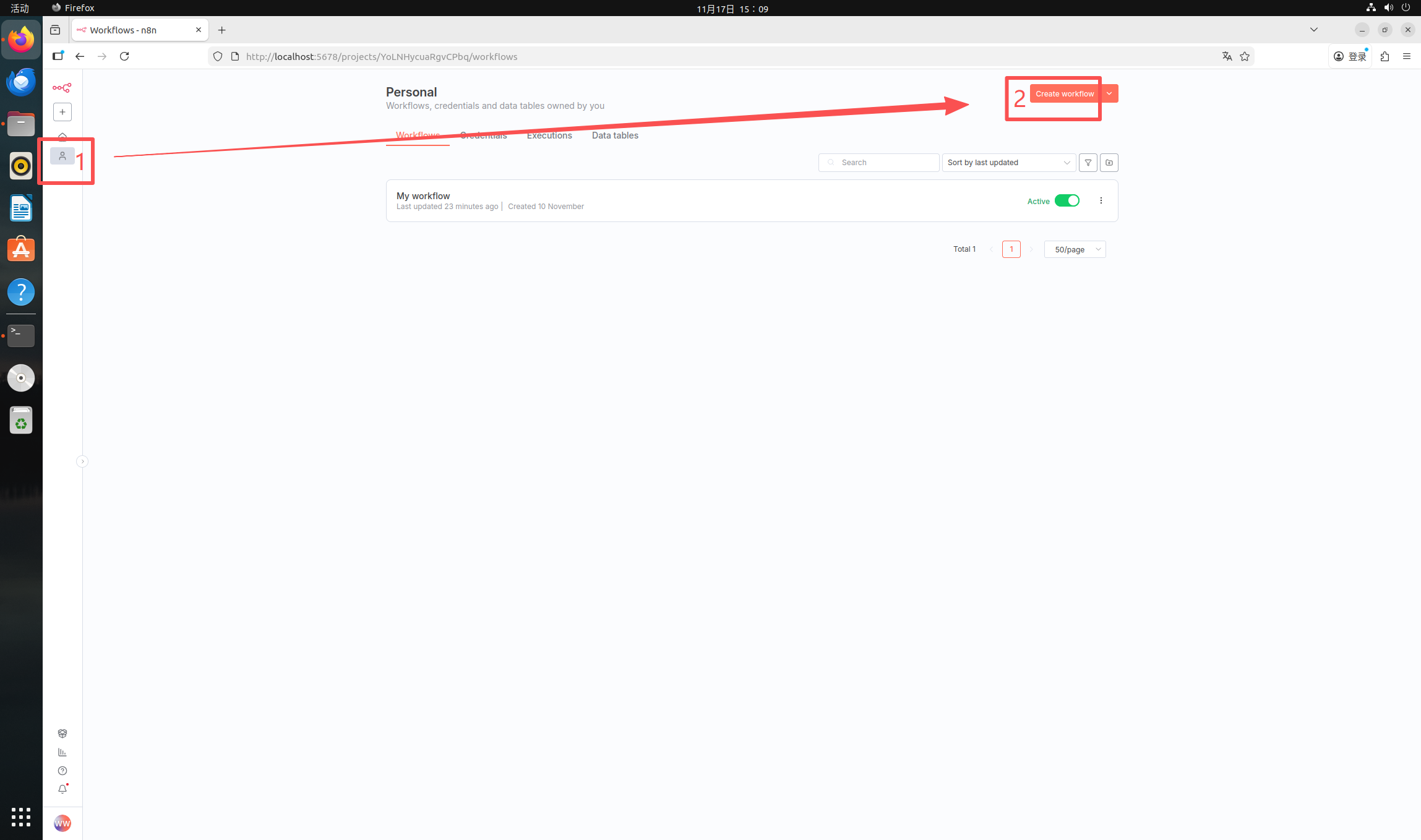

(1) Create a "Webhook" node to receive ReCamera data​

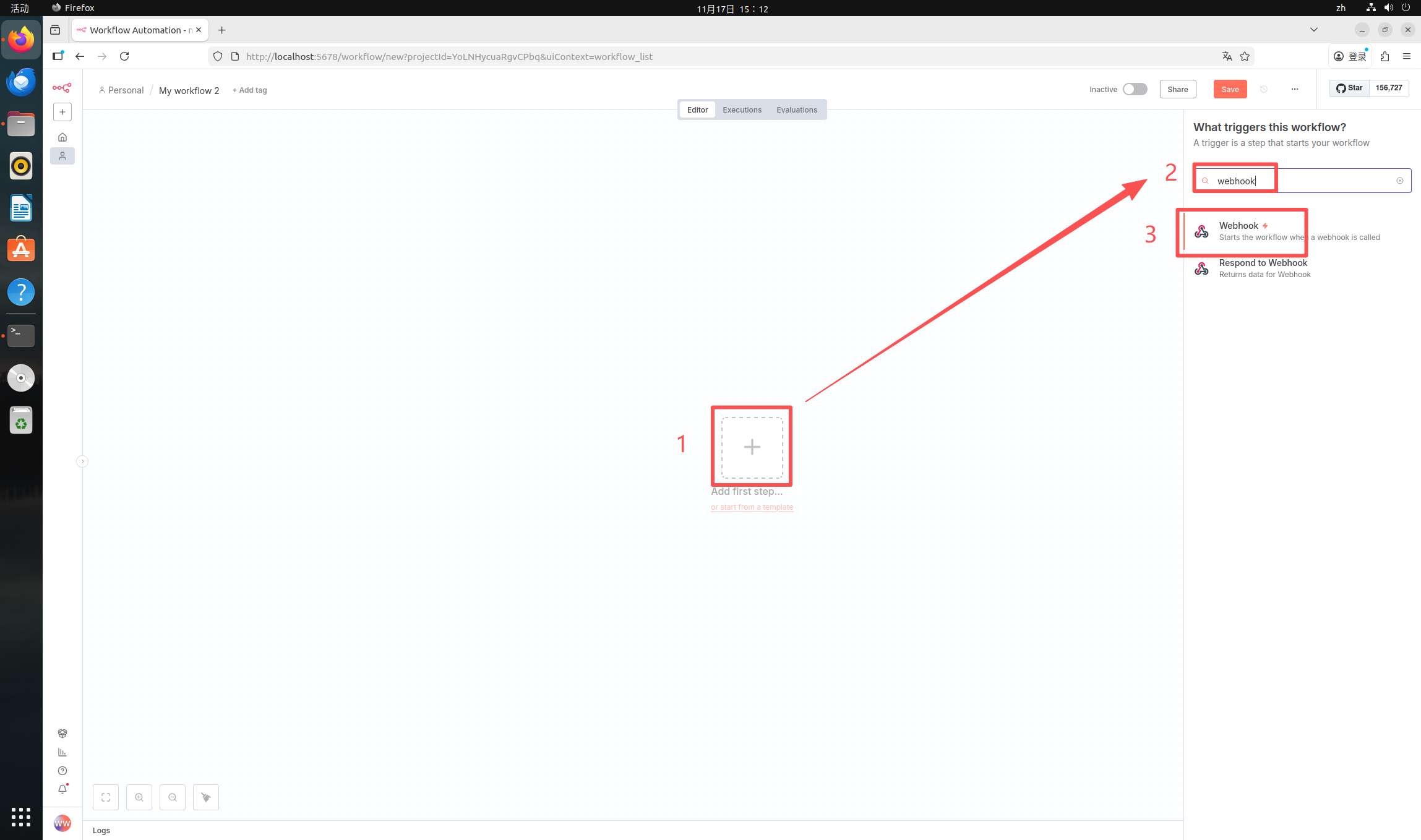

Click Personal-Create workflow
Click the plus sign-search box to enter "webhook"-click the first "Webhook" node
Now we have entered the configuration interface. Here we need to modify two places. First, select "HTTP Method" as "POST". Then, modify "Path" as any name. Here I will take "recamera_detect" as an example.
After this step, he has automatically saved it. At this time, click "Back to canvas" in the upper left corner to return to the main interface and prepare to create the next node.

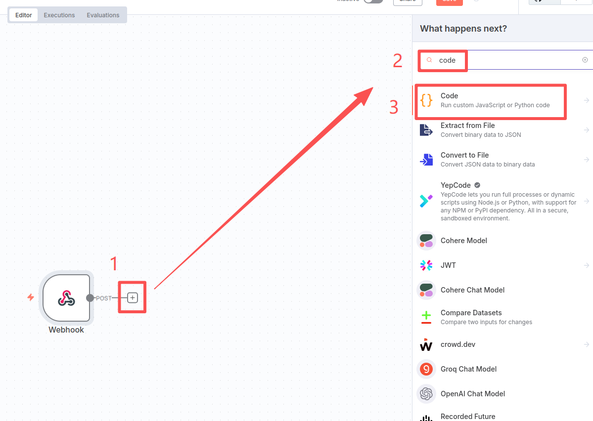

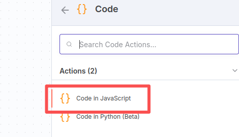

(2) Create "Code" node to process received data​
Click the plus sign-enter "code" in the search box-click the first "Code" node
Then select "Code in JavaScript"

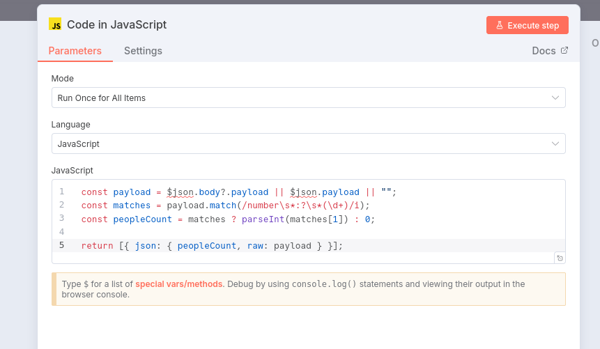

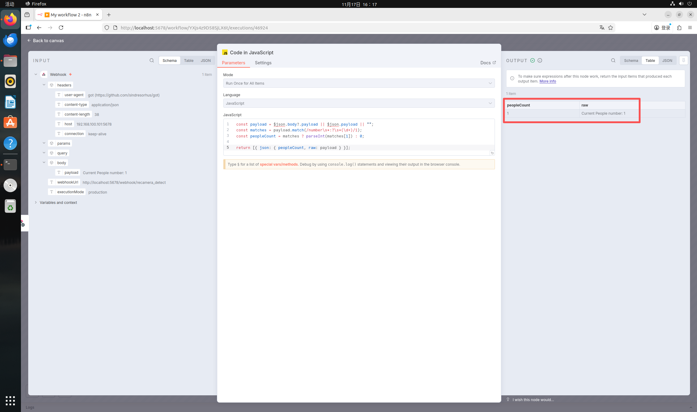

Replace the original content with the following code:
const payload = $json.body?.payload || $json.payload || "";
const matches = payload.match(/number\s*:?\s*(\d+)/i);
const peopleCount = matches ? parseInt(matches[1]) : 0;
return [{ json: { peopleCount, raw: payload } }];
Click "Back to canvas" in the upper left corner to return to the main interface

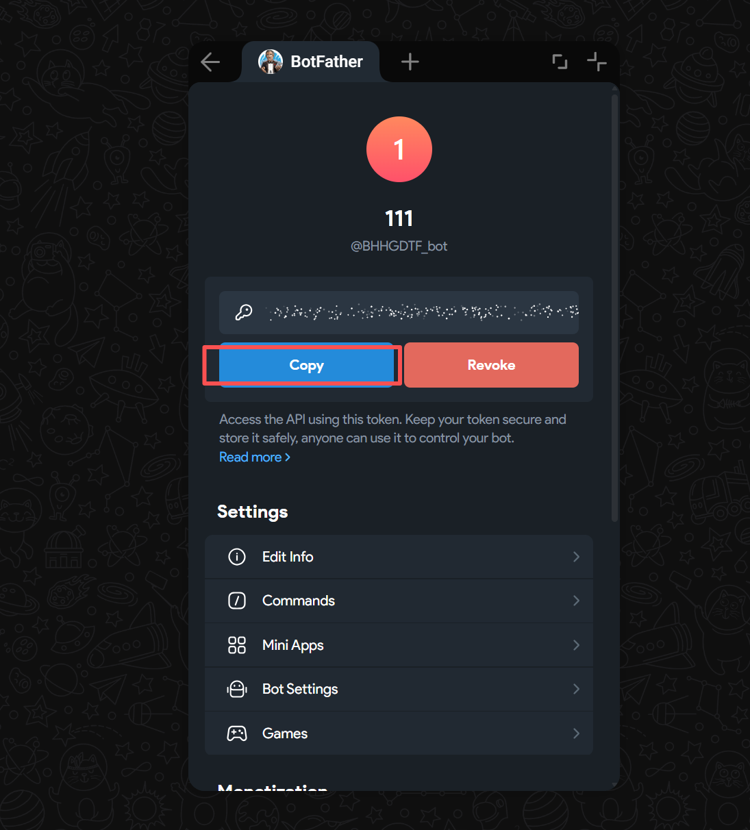

(1) Create a Telegram Bot and get its API​

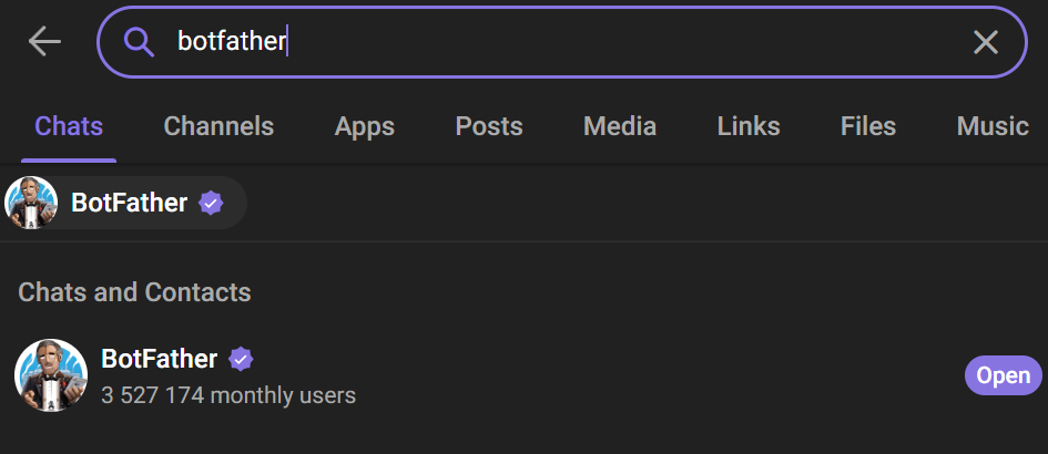

Open the Telegram and search for "BotFather"

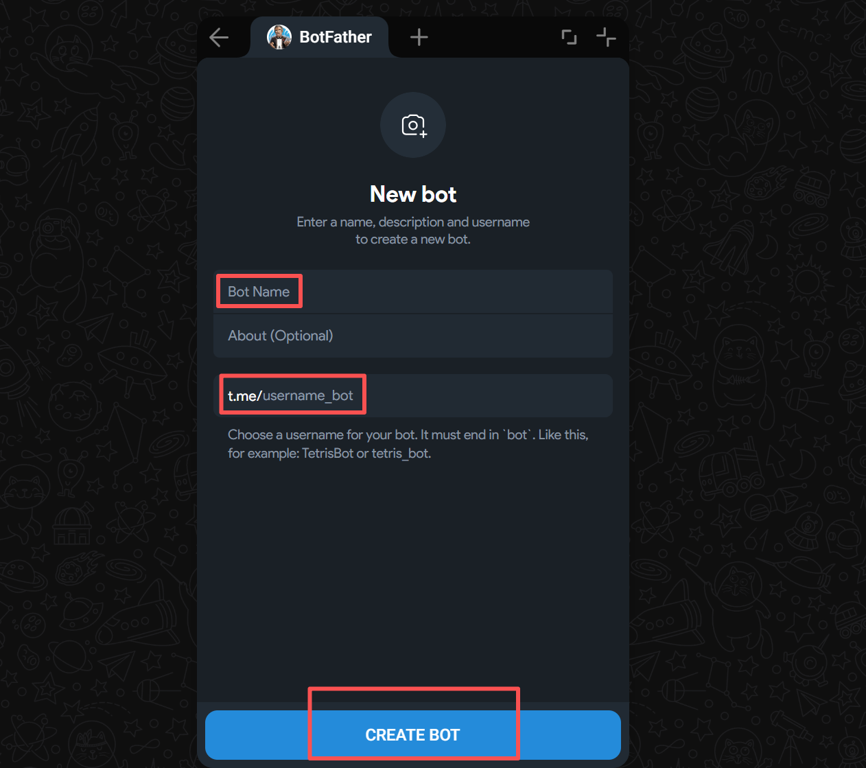

Create your Bot, fill in the robot name and user name, and then click "CREATE BOT"
Then this interface will appear. After the keychain icon, there is a string of particle effects, which is the API of the Bot you created. Click "Copy" and you will use it later.

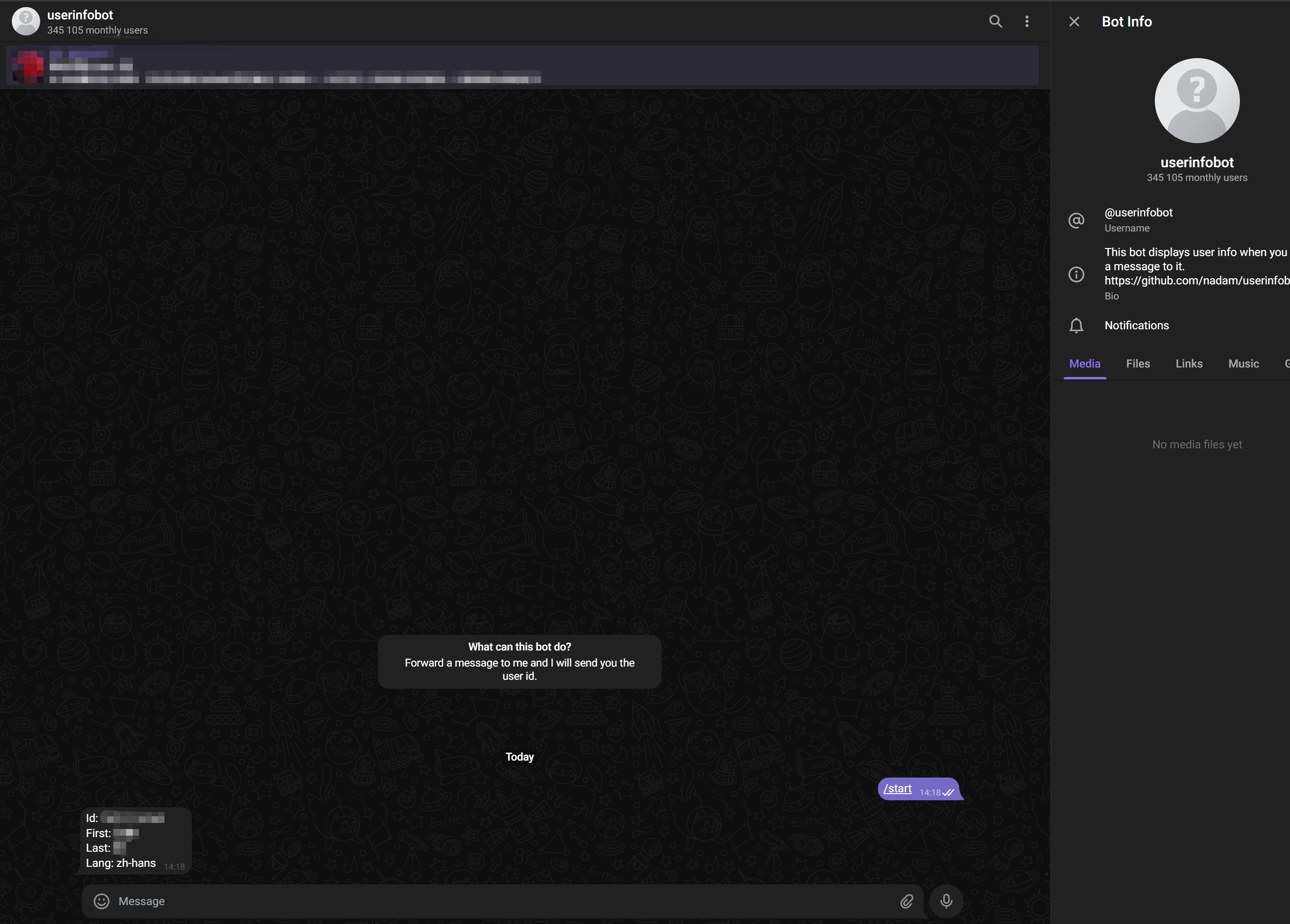

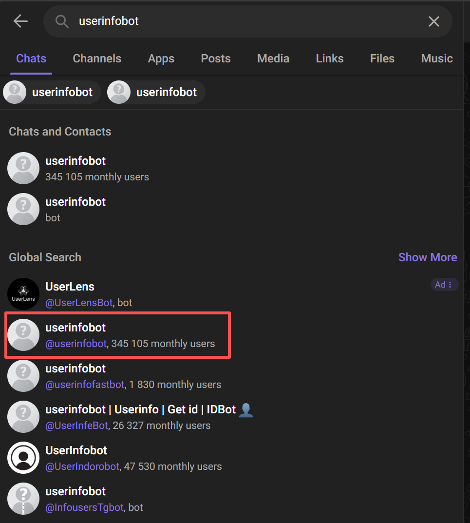

(2) Search userinfobot to get your personal Chat ID​
After clicking to enter, click "Start" in the upper right corner. At this time, it returns a message containing your ID. Remember this ID, which will be used later.

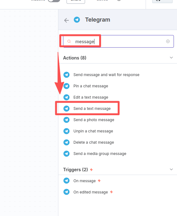

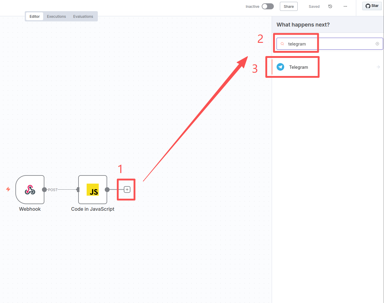

Click the plus sign-search box to enter "telegram"-click the first "Telegram" node
After clicking, continue to enter "message" and select "Send a text message"

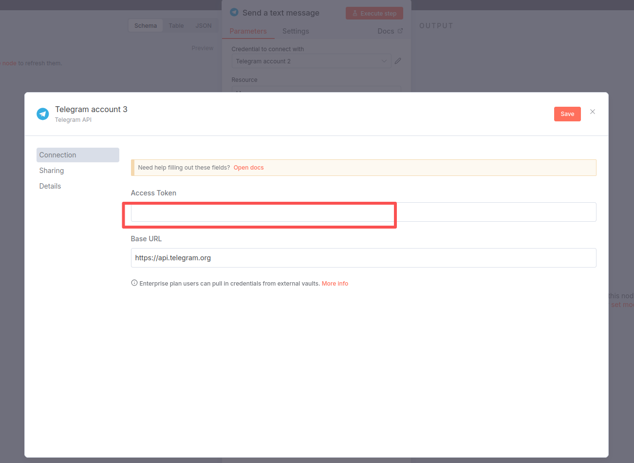

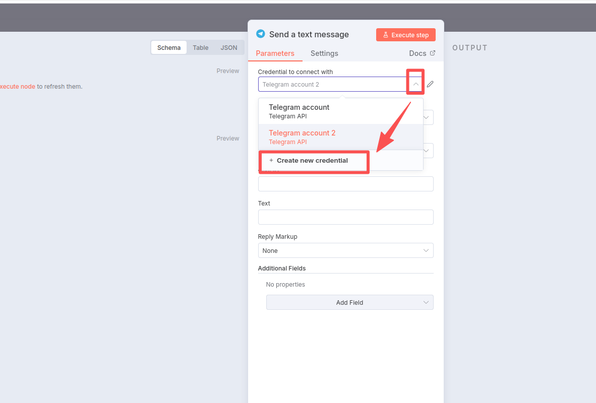

After entering the node, select "Create new credentila"

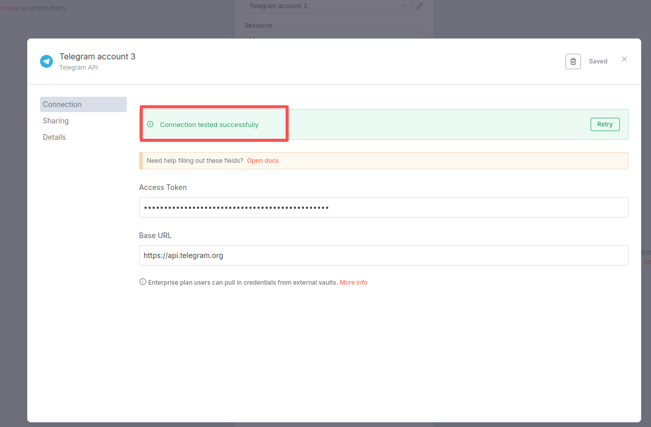

Then copy the API of your Bot just copied to "Access Token" and click "Save" in the upper right corner"
After clicking "Save", the system will verify whether the API exists. If everything is correct, the words "Connection tested successfully" will appear. At this time, click Exit in the upper right corner.

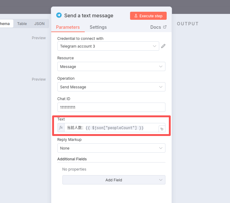

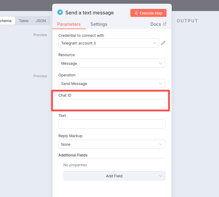

Then fill in the personal Chat ID you obtained before.
Then fill in "Text":
当前人数:{{ $json["peopleCount"] }}

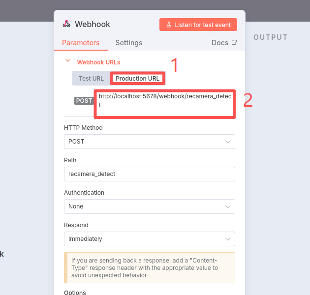

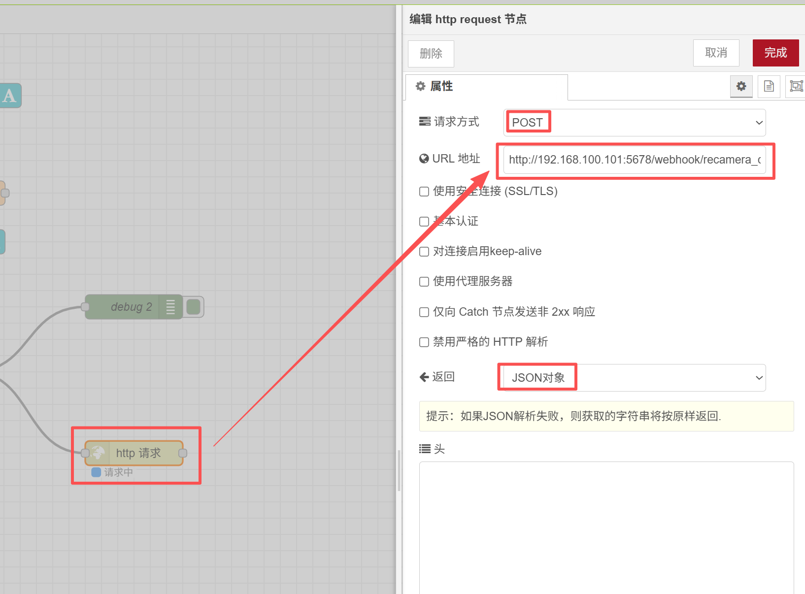

First, open the n8n interface of the virtual machine, double-click the "Webhook" node you configured earlier, enter the configuration interface of the Webhook node, and then click "Production URL" to copy the following "POST" address
The previous configuration steps are the same as the Home Assistant, only when configuring the "http request" node, the URL address needs to be modified, that is, the POST address you just copied in the virtual machine, and then modify the localhost to the IP address of your virtual machine
View Virtual Machine IP
ifconfig
Please remember! Make sure to connect Recamera to the network!!! Otherwise, communication will not be possible.

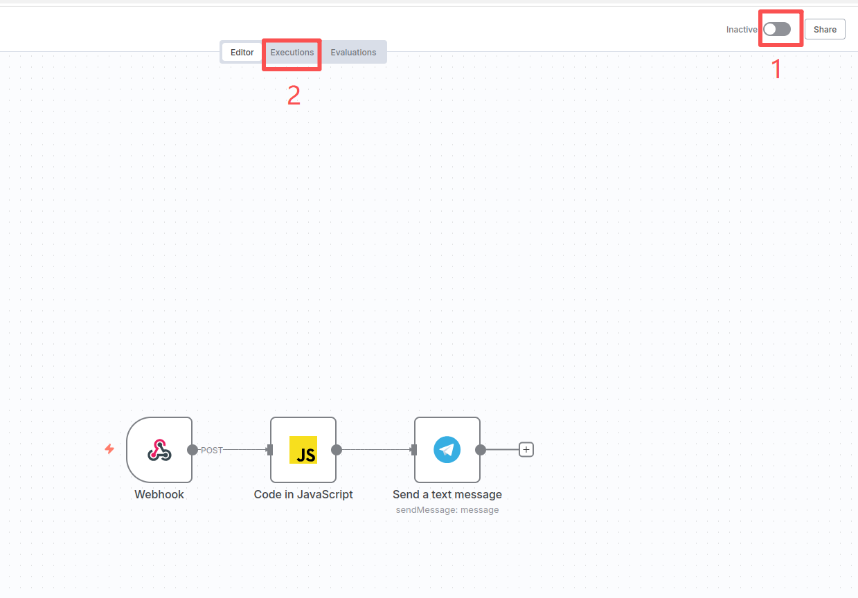

5. Open Active and enter the Executions interface to view the message​
Click the "Inactive" switch in the upper right corner to turn it into green Active, then click "Executions"

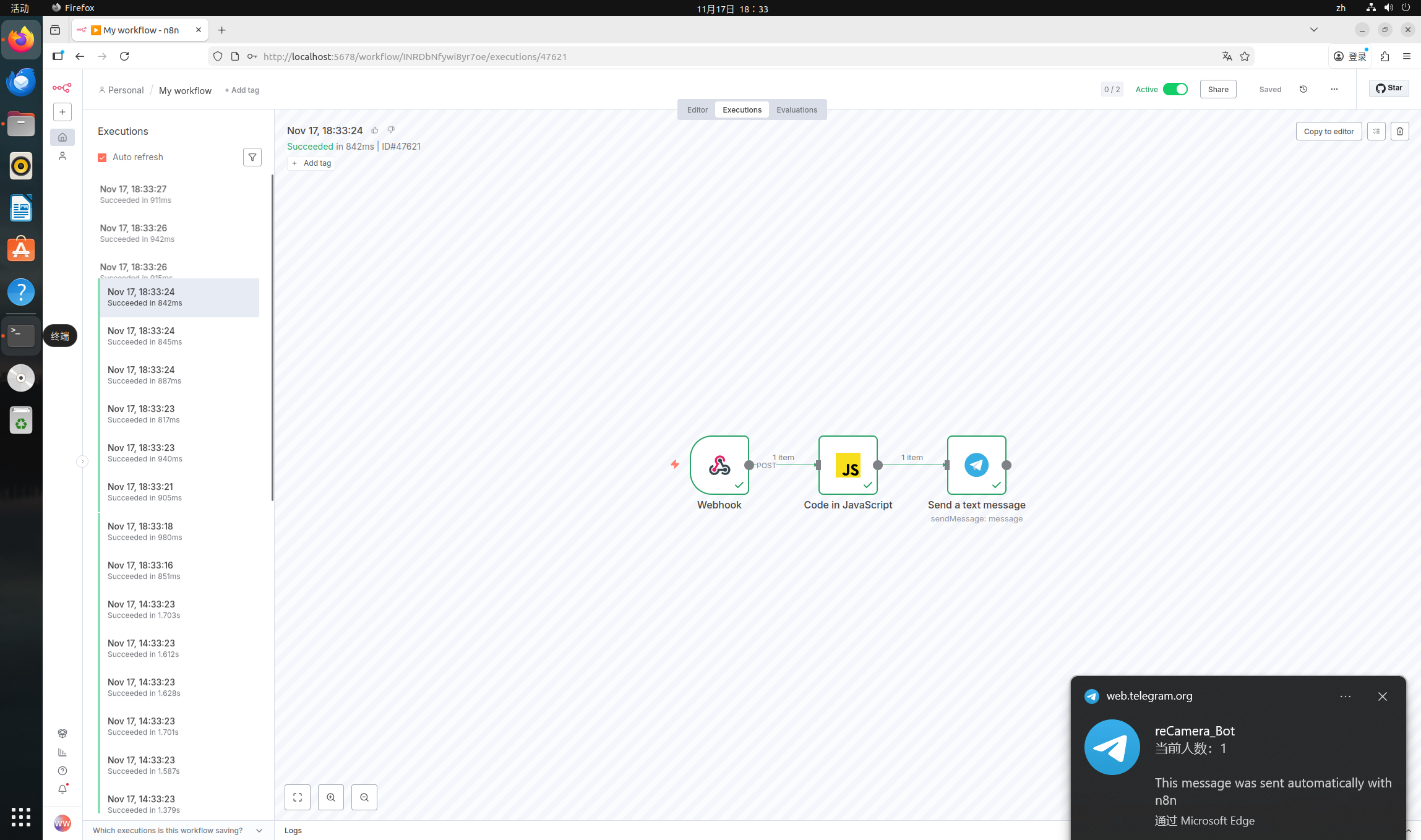

At this time, you will see that there are many timestamps on the left that have been refreshing. If you see that the timestamps have been refreshing, it means that your reCamera data has been connected to the n8n platform!

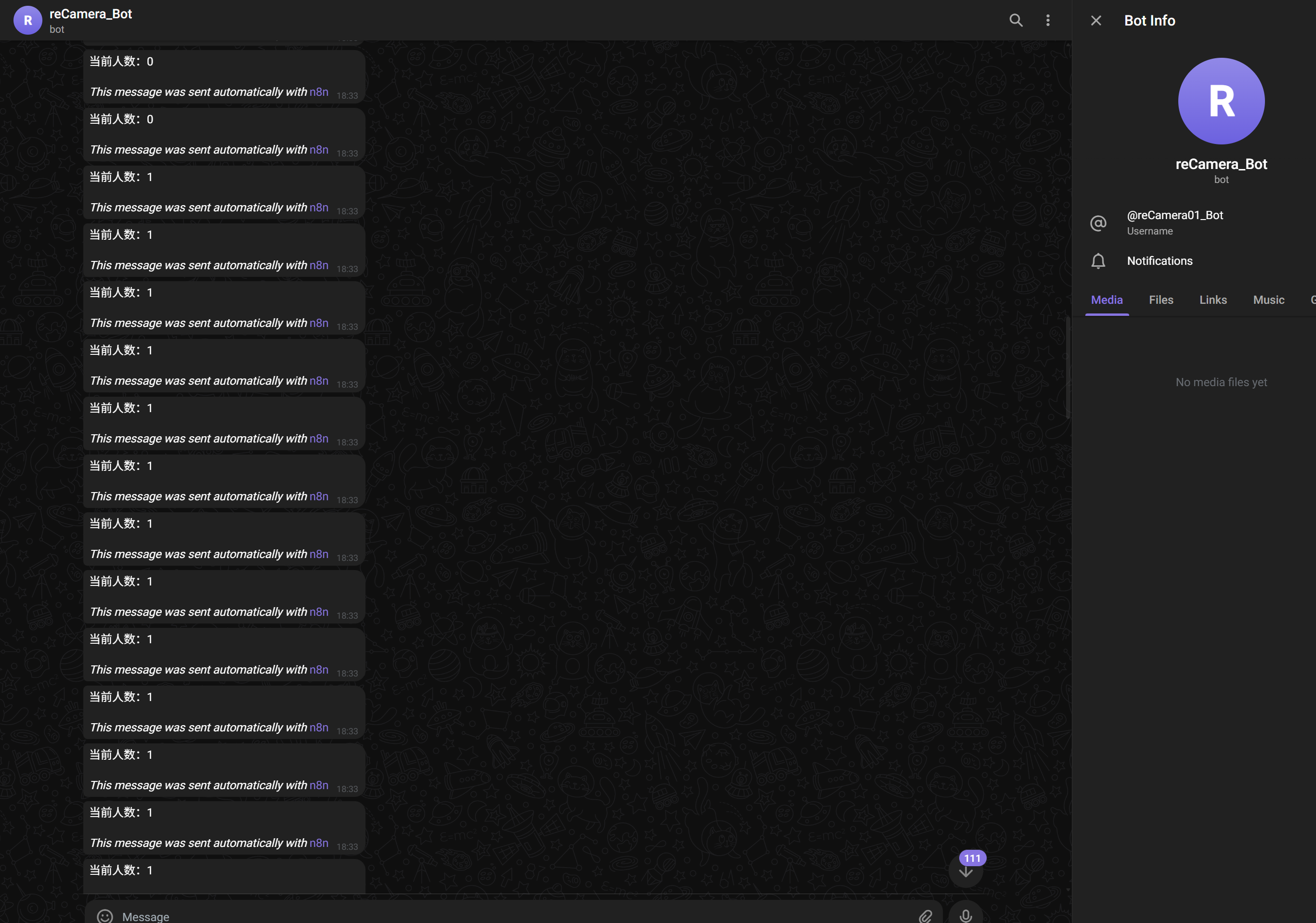

Then check your Telegram, there should be a lot of message reminders, at this time, you have successfully pushed the reCamera message to the Telegram!!!
If you want to view the detection content of a certain time, you can double-click that timestamp, and then double-click "Code in JavaScript" to view the OUTPUT on the right.
