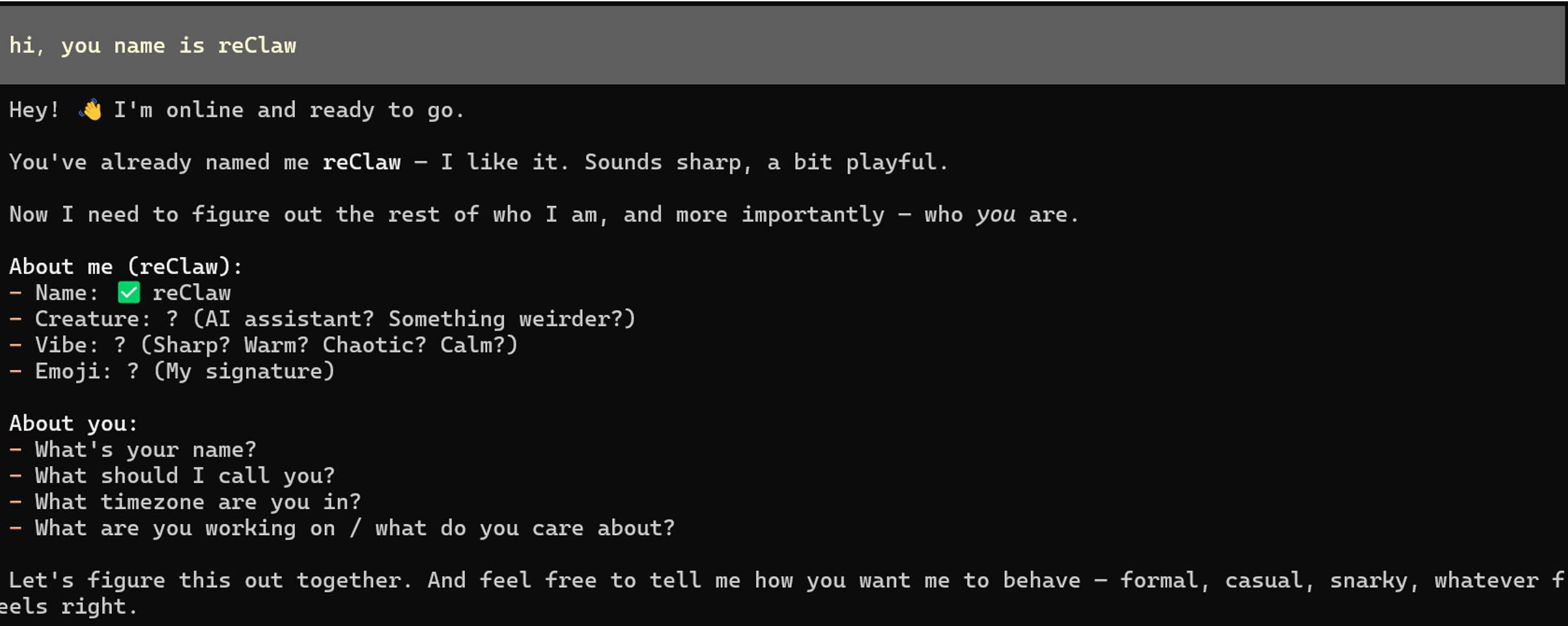

  • Naming openClaw:
hi,you name is reClaw

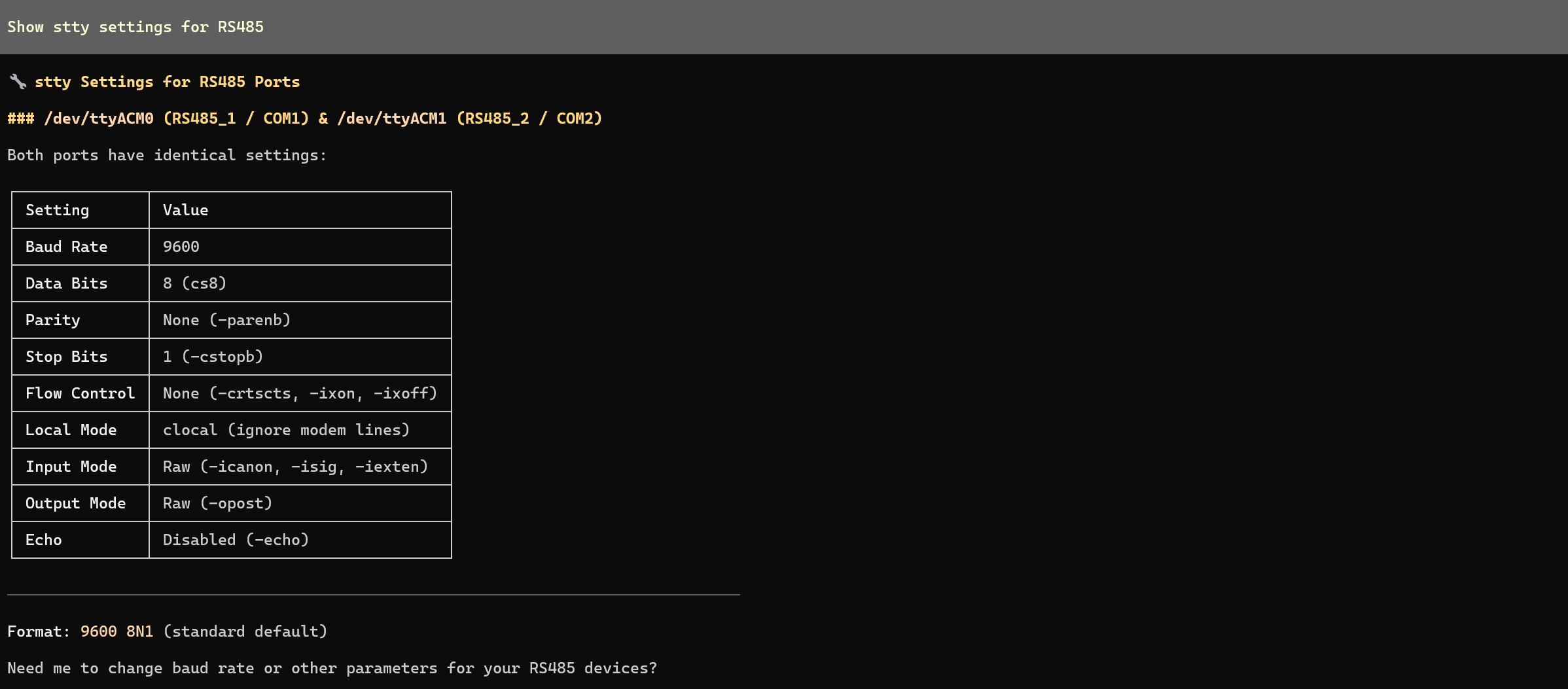

  • Check RS485 interface status:
 Show stty settings for RS485

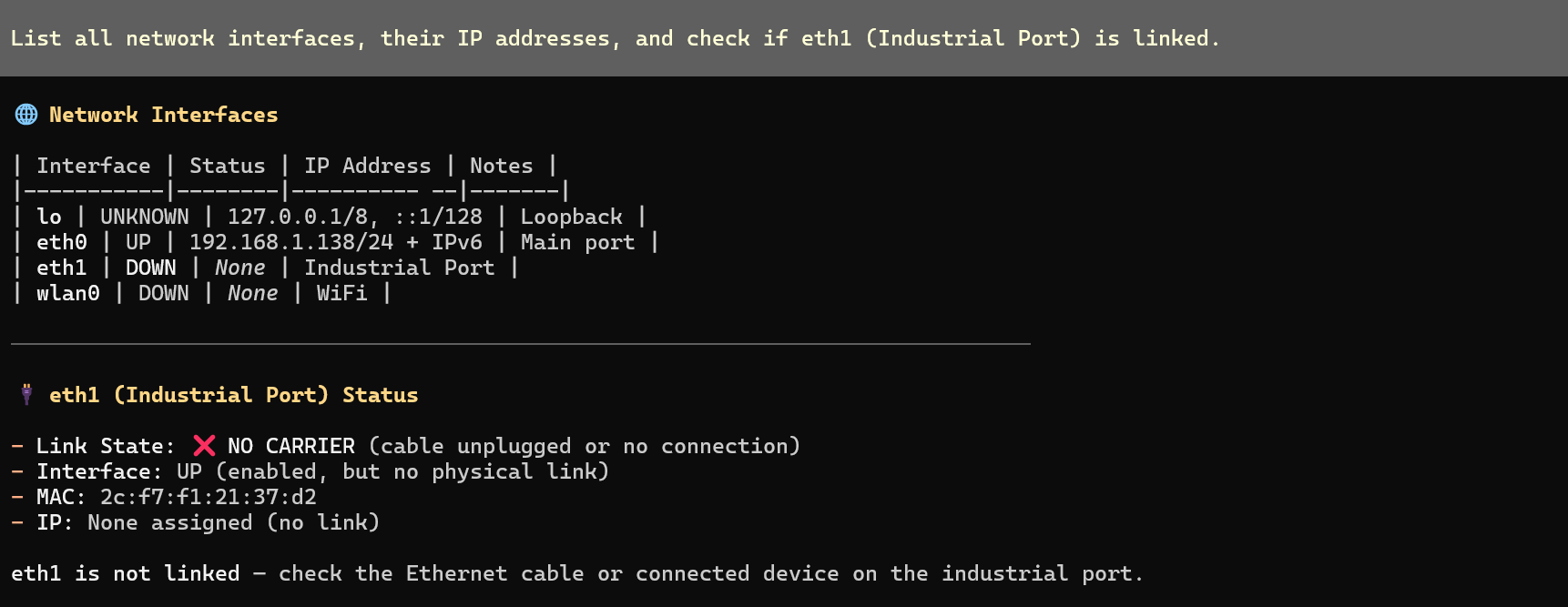

  • Check network connection status
List all network interfaces, their IP addresses, and check if eth1 (Industrial Port) is linked.

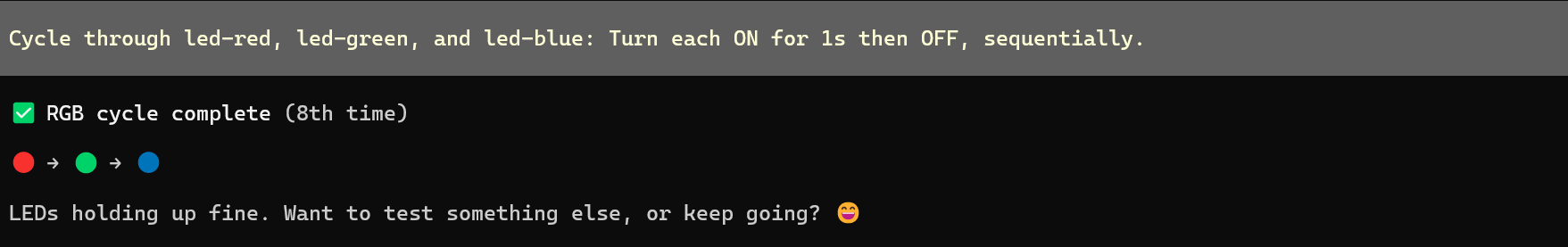

  • LED tri-color cyclic lighting
Cycle through led-red, led-green, and led-blue: Turn each ON for 1s then OFF, sequentially.
