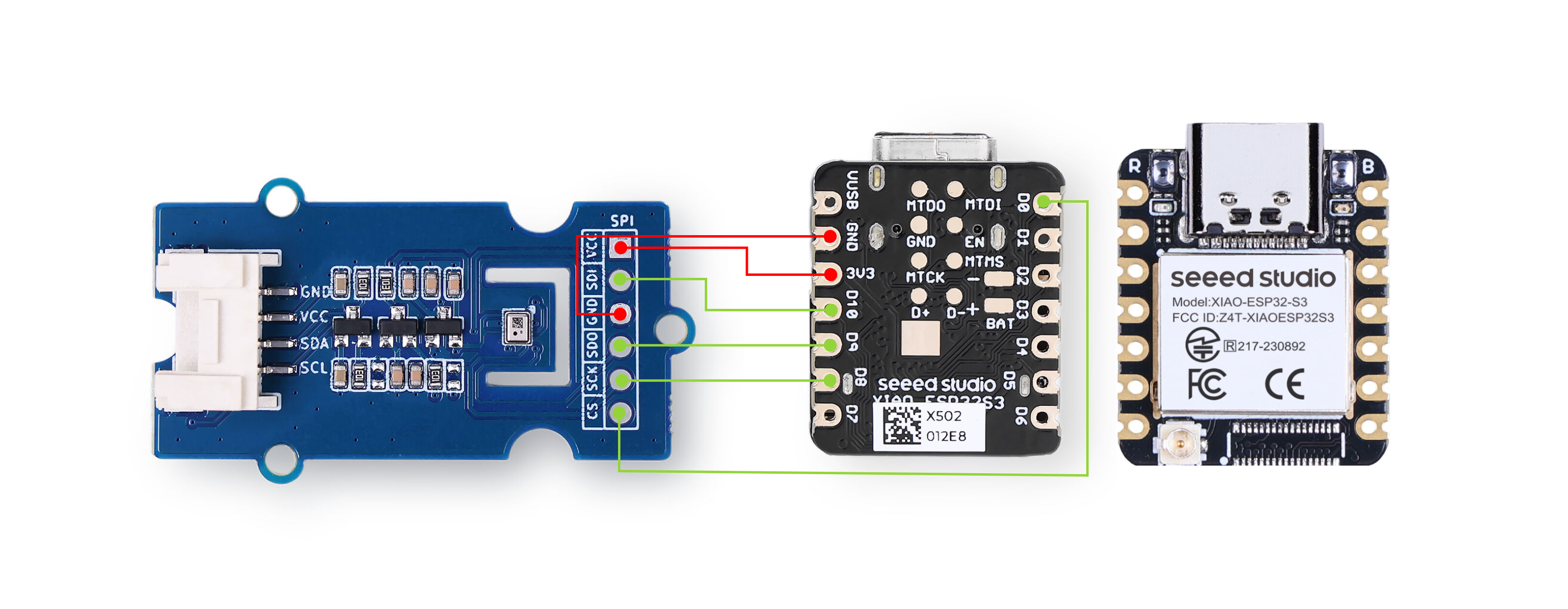

Step 1. Connect Grove Barometer Sensor SPA06-003 with your controller
To select SPI bus, please use a sharp knife or a soldering iron to cut the two pads in the Interface Bus Configuration Area.
Do not touch or shake or let this product in vibration when it works. This will cause interference and will affect the accuracy of data collected.

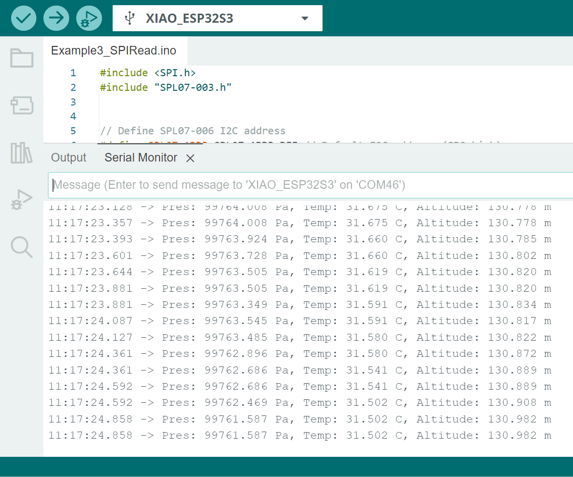

Step 4. Open the serial monitor to receive the sensor's data including temperature, barometric pressure value, and altitude.
The outcome will display on the Serial Port as following if everything goes well.
