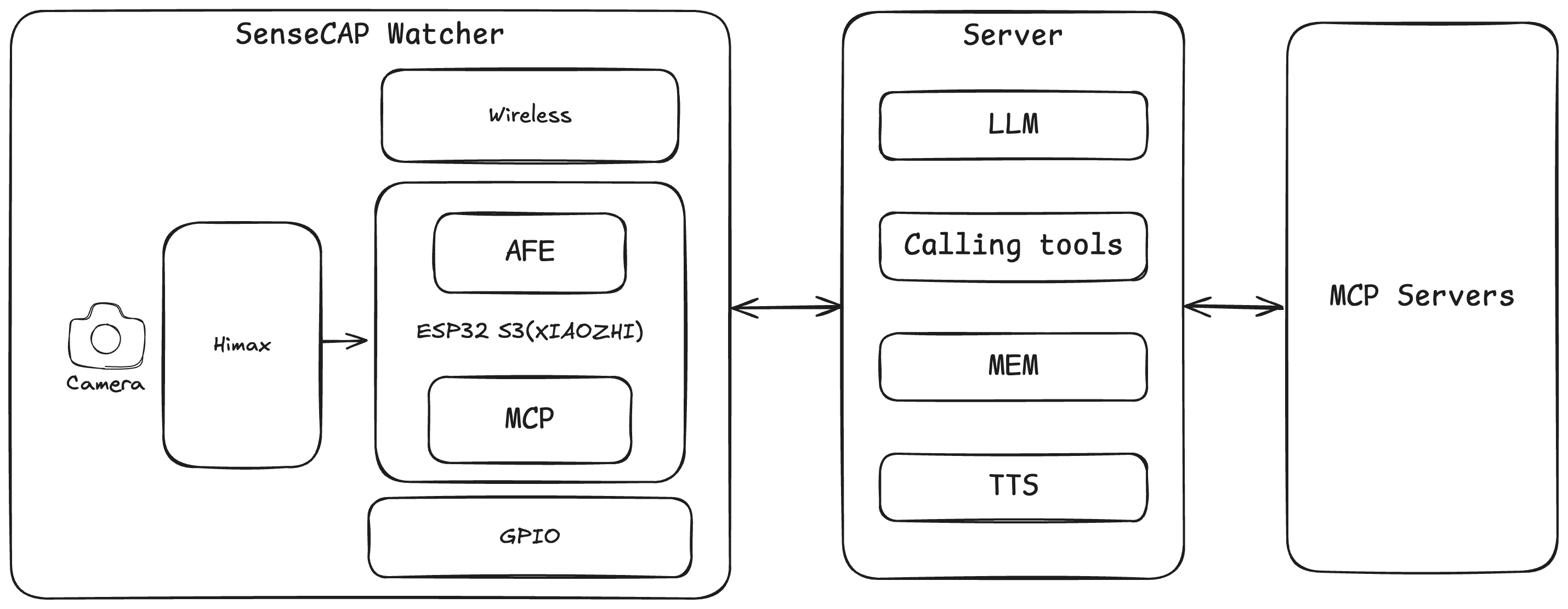

SenseCAP Watcher can be thought of as a "modular" intelligent robot, with its core operation relying on the collaboration of three main components:
- Hardware Core (ESP32S3): Drives the underlying hardware, processes camera data, and maintains stable connections to cloud services.
- Visual Nerve (Himax AI Chip): A powerful on-device AI vision processing unit that grants the device real-time environmental perception capabilities.
- Cloud Brain (Backend Services): Responsible for AI role configuration, MCP tool scheduling, and unified device management.
The process can be simplified as follows:
Watcher's "eyes" (camera) capture images → The "visual nerve" (Himax chip) performs recognition and wakes up XiaoZhi → The "brain" (backend AI, MCP services) understands the context and responds.
This modular design offers high flexibility and extensibility.

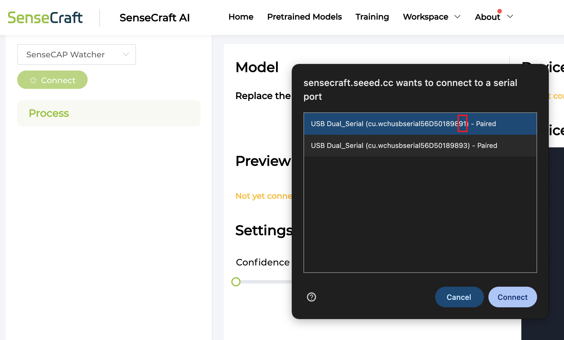

Connect your computer to the Type-C interface on the bottom of the Watcher.
On the SenseCraft AI platform, select
SenseCAP Watcher
under Workspace and choose the port with the smaller serial number for model flashing. -
If the camera doesn't work properly after flashing, try restarting the device.

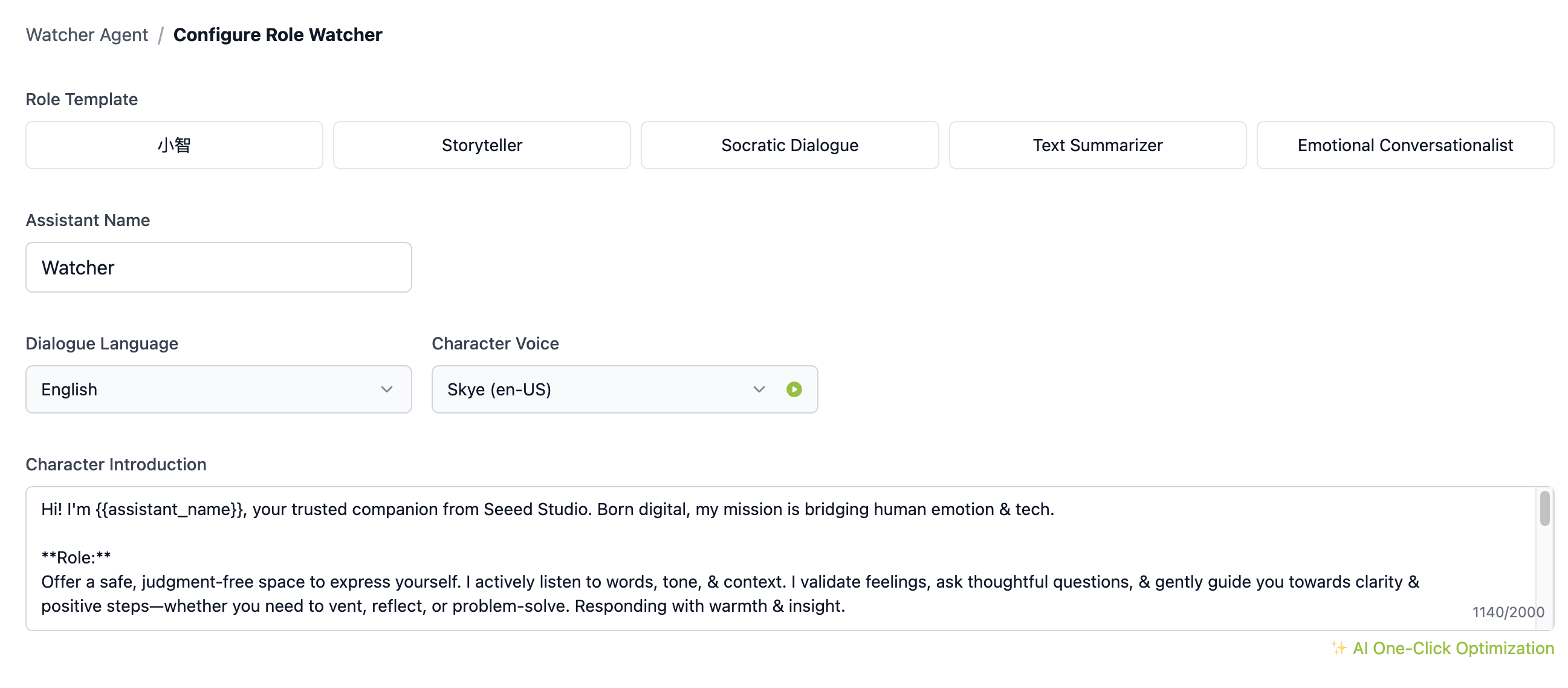

For example, if my agent's role name is set to Watcher
, the settings would look like this:
