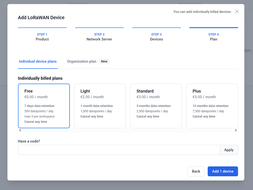

(6)Enter "DEVEUI" and "NAME", then click "Next"
  • Select "Free"
  • Click "Add 1 device"
