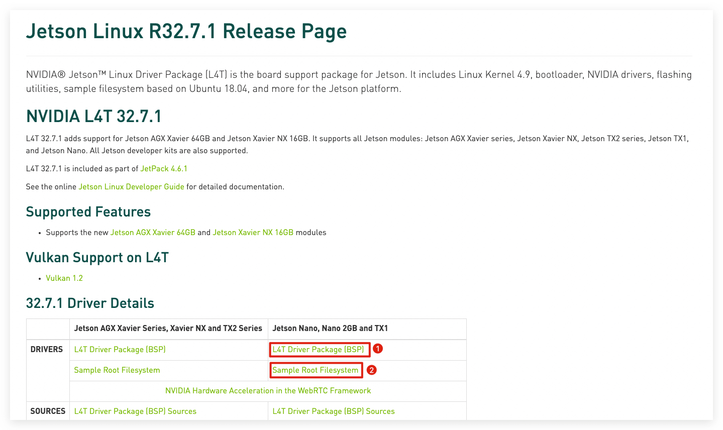

  • If you intend to install the system using the command line method.
NVIDIA Jetson Linux Driver Package (L4T) is the board support package for Jetson. It includes Linux Kernel 4.9, bootloader, NVIDIA drivers, flashing utilities, sample filesystem based on Ubuntu 18.04, and more for the Jetson platform.
In this case, we will use the latest NVIDIA L4T 32.7.1 to guide the installation of the system. As a prep, you will need to go here to download the two necessary zip packages to your Ubuntu host.
The following packages are necessary:
  • L4T Driver Package (BSP)
  • Sample Root Filesystem
If you want to download and use other versions of L4T on your own, you can browse the following pages to choose.
