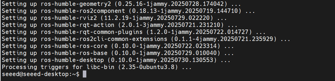

Install ROS2​
sudo apt update
sudo apt install ros-humble-desktop-full # Options: ros-humble-desktop-full, ros-humble-desktop, or ros-humble-ros-base

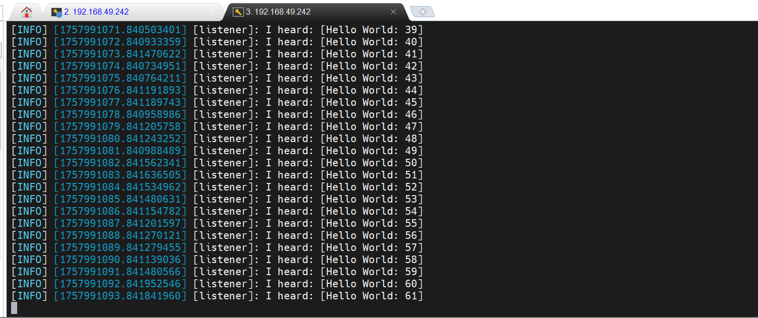

To verify whether ROS2 has been successfully installed, we can create two new terminals in the device and run the following commands respectively.
# terminal1
ros2 run demo_nodes_cpp talker
# terminal2
ros2 run demo_nodes_py listener
If both terminals print out the messages, it means ROS 2 Humble has been successfully installed! 🎉
