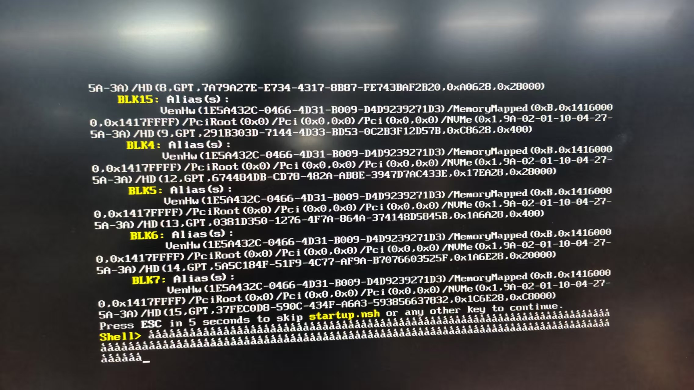

If JetPack 5 is flashed to the SSD of Jetson, there is still a certain probability that the system may fail to boot even if the flashing process completes successfully. The following error may occur during startup:
This issue has also been documented on NVIDIA’s official forums. It may be caused by filesystem incompatibility or incomplete wiping during the flashing process, which leads to boot failure. So far, no similar issues have been observed when flashing and using JetPack 6 on Jetson devices.

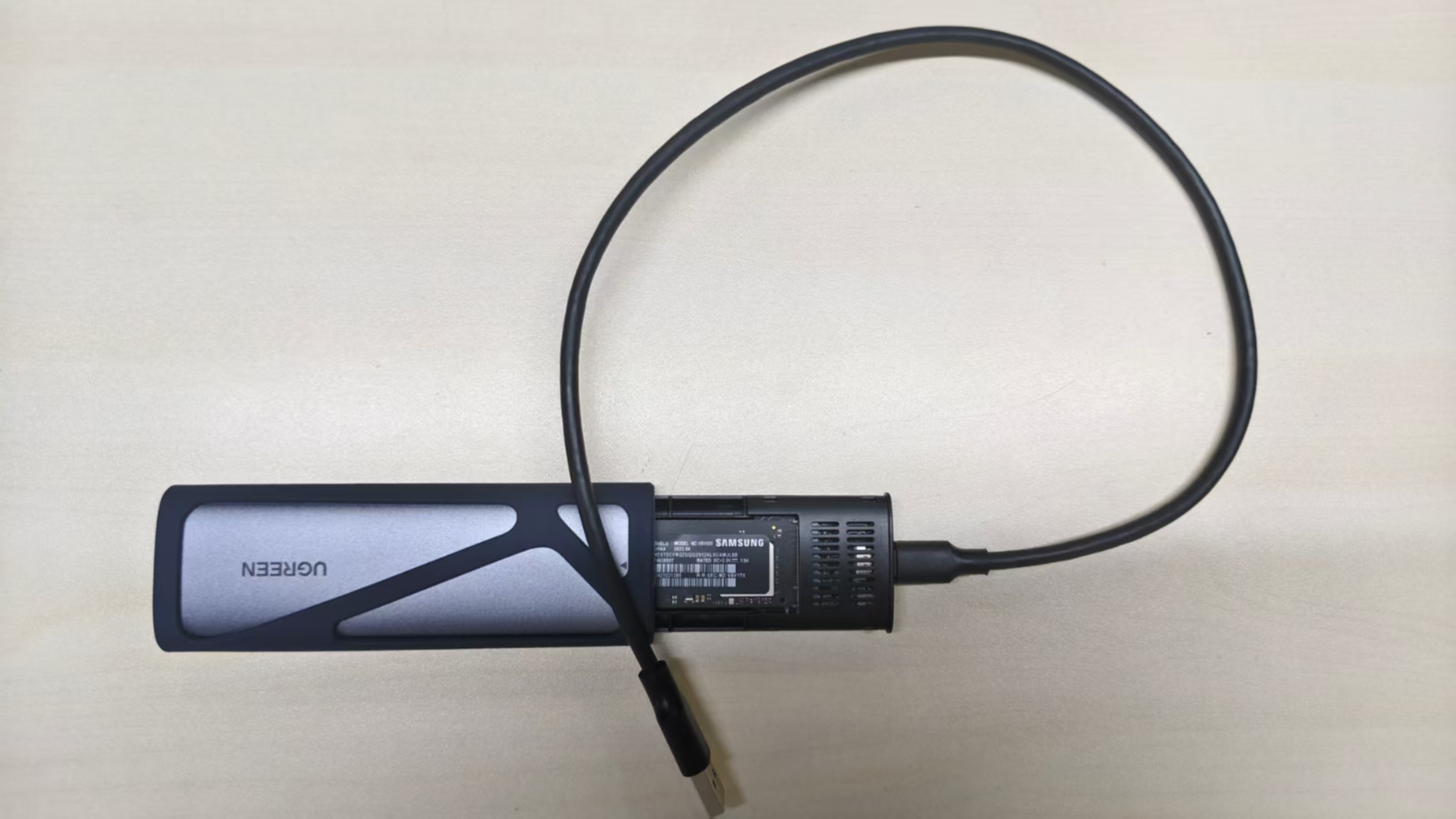

First, remove the SSD that fails to boot properly from the Jetson device, and connect it to your PC using an SSD enclosure (any compatible enclosure similar to the one shown in the image below). Proceed with formatting the drive.

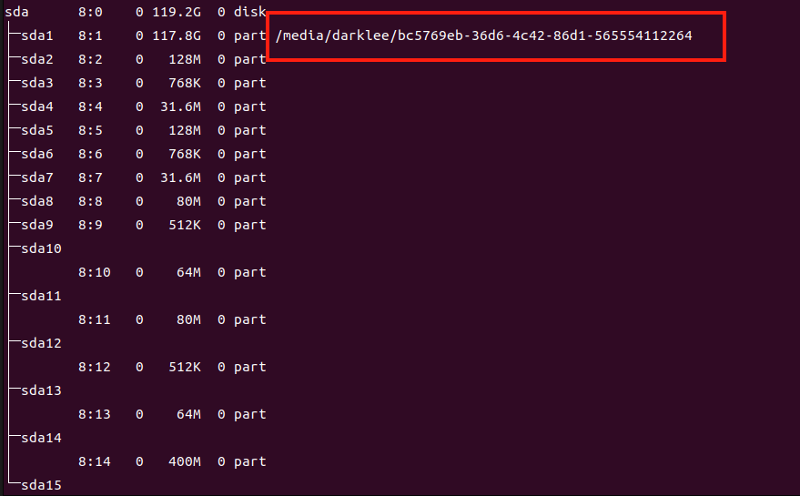

Then, enter the following command in the terminal to locate the SSD mounted to the PC, which may be named sda, sdb etc.:
lsblk
If you're unsure which name corresponds to the SSD you inserted, you can check the contents of the mounted directory:

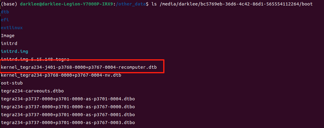

Taking the mounted directory in the image as an example, check whether there is a Jetson-specific device tree:
ls /your_path/boot
# For example: ls /media/darklee/bc5769eb-36d6-4c42-86d1-565554112264/boot
If it's the SSD from the Jetson, you will see results similar to the following image:
You can continue checking the contents of other files in the SSD's mounted directory to further confirm that it belongs to the Jetson.
