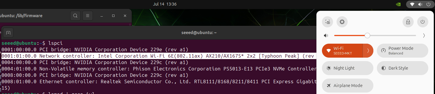

Symptoms
After upgrading to JetPack 7.2, you may see one or more of the following symptoms:
  • lspci can detect the Wi-Fi module, but ip link does not show wlan0.
  • dmesg reports iwlwifi or rtw89 firmware loading errors.
  • modprobe reports that the expected module cannot be found.
  • Loading the driver manually works temporarily, but Wi-Fi disappears again after reboot.

Check the kernel version and PCIe device first:
uname -r
lspci -nnk | grep -A3 -i network
Common PCI IDs include:
ModuleExample PCI ID
Intel AX2108086:2725
Intel AX2008086:2723
Realtek RTL8852BE10ec:b852

A successful setup should show the Wi-Fi device, the expected kernel modules, and a wireless interface such as wlan0.
The following AX210 result shows the final Wi-Fi enabled state after repair:
