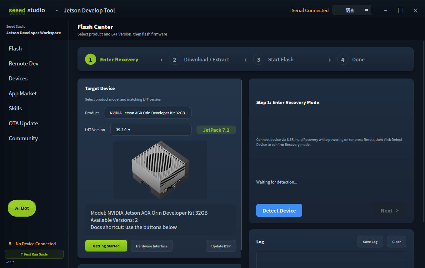

Q6: How can I upgrade to JetPack 7.2 with Seeed Jetson DevelopTool?
Seeed Jetson DevelopTool provides a guided workflow for Jetson firmware download, flashing, device connection, and OTA operations.
For a major-version migration such as JetPack 6.x to JetPack 7.x, a full flash is recommended unless Seeed explicitly provides a validated OTA path for your exact product and source image.
General workflow:
- Install and open Seeed Jetson DevelopTool.
- Select the Jetson product or carrier board model.
- Select the target L4T or JetPack version that matches JetPack 7.2.
- Download and extract the BSP package from the tool.
- Put the Jetson device into Force Recovery Mode.
- Detect the device from the host PC.
- Start flashing and wait until the device reboots.
- Complete first boot setup and verify the system version.
For more details about the tool, refer to Seeed Jetson DevelopTool.
