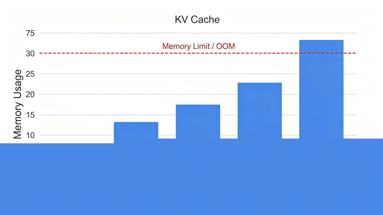

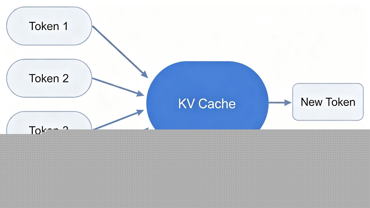

2.3 KV Cache: The Budget That JetPack 7.2 Does Not Remove
When a Transformer produces the first token, it processes the prompt and stores the attention keys and values it has calculated. On the next token, the runtime can reuse those values instead of calculating the full history again. That reuse is why decoding remains practical, but it comes with a cost: the cache grows as the conversation grows.
An approximate planning formula is:
KV-cache bytes ≈ 2 × layers × KV heads × head dimension × tokens × batch × bytes per element
This is why the same INT4 model can run comfortably at 4K context and then run out of memory at 32K. JetPack 7.2 may leave more usable headroom through a leaner deployment image or a more efficient supported runtime, but it does not cap KV-cache growth. Weight quantization lowers a fixed cost; context, batch, and concurrency still define the growing part of the budget.
2.4 KV Cache Reuse: Turn a Growing Cost into a Managed Resource
Section 2.3 explains the trade-off: the KV cache prevents the model from recalculating the full prompt for every token, but it consumes more DRAM as the context grows. In a JetPack 7.2 deployment, first use the platform improvements to establish a real memory budget; then decide whether work already stored in the cache can help the next request.
TensorRT Edge-LLM treats this cache as a runtime resource rather than an invisible side effect. The engine is built with a target input length and KV-cache capacity, while the runtime has a page pool for active and retained contexts. This is a TensorRT Edge-LLM capability running on the JetPack 7.2 compute stack—not a cache policy applied automatically by the OS—but it lets a 7.2 deployment reserve memory deliberately instead of discovering the limit after an out-of-memory failure.
For supported models, Edge-LLM can also reuse matching prompt prefixes across requests. The cache is local to one runtime instance and is keyed by the prefix content, so only the shared part of a prompt can be reused. In the current Edge-LLM implementation, this feature requires an FP16 KV cache and must be enabled for the selected engine and runtime.
