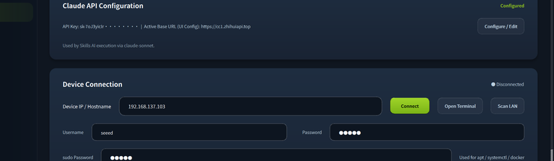

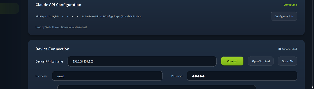

Ethernet / SSH Connection​
For all non-flashing features, the DevelopTool connects to Jetson over SSH via Ethernet (or Wi-Fi if configured).
Steps:
  1. Connect Jetson and the host PC to the same network, or use a direct Ethernet cable with PC Network Sharing enabled.
  2. In the DevelopTool, open the Remote Dev tab.
  3. Enter the Jetson's IP address, SSH username, and password in the Device Connection panel.
  4. Click Connect.
Once connected, the device status panel shows real-time CPU, GPU, memory, and temperature information.
