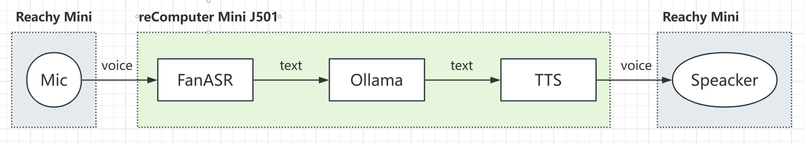

Double Mini! This project will build a fully localized, low-latency, and high-privacy voice interactive robotic assistant system. Centered around the reComputer Mini J501 edge computing device, it deploys local speech recognition, large language model, and speech synthesis services. Using the open-source robotic platform Reachy Mini as the physical terminal for human-computer interaction, it achieves an embodied intelligent interactive experience that is perceptive, conversational, and actionable.

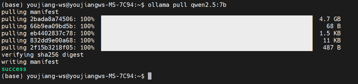

Step1. Install and run ollama inference server in reComputer Jetson.
Run the following command in the terminal window(Ctrl + Alt + T) on reComputer Jetson.
# Install Ollama (visit https://ollama.ai for platform-specific instructions)
curl -fsSL https://ollama.com/install.sh | sh
# Pull the required model
ollama pull llama3.2-vision:11b
The model download will take approximately 10 minutes. Please wait patiently.

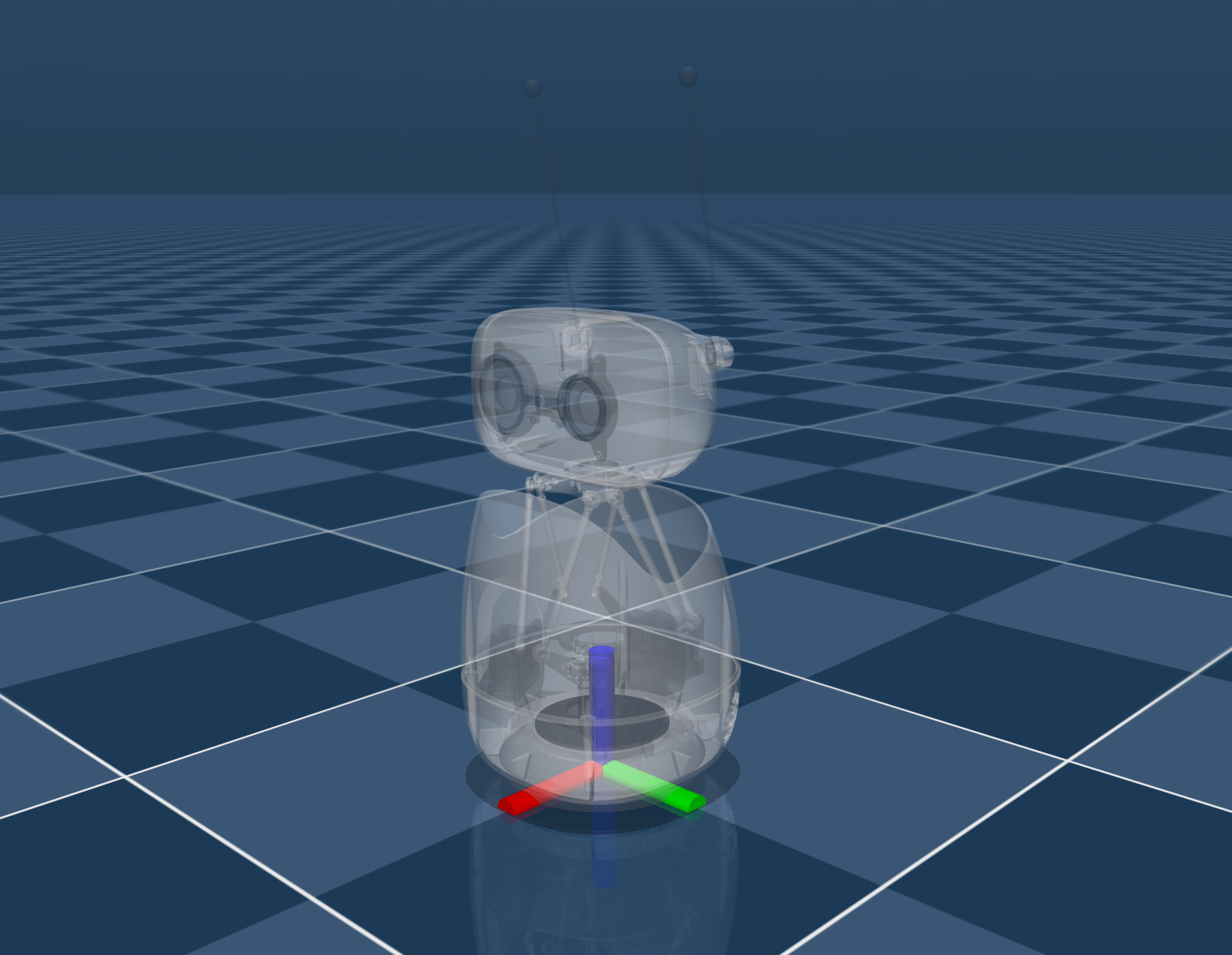

Run the following command in the terminal window on reComputer Jetson to launch reachy mini daemon.
reachy-mini-daemon

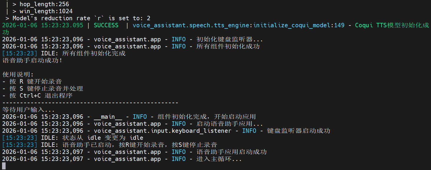

Open another terminal and execute:
# Set environment variables
export OLLAMA_HOST="http://localhost:11434"
export OLLAMA_MODEL="qwen2.5:7b"
export COQUI_MODEL_NAME="tts_models/zh-CN/baker/tacotron2-DDC-GST"
export DEFAULT_VOLUME="1.5"
# Start the voice assistant
python main.py
Here, a Chinese model is used for the demonstration. You can replace it with models in other languages according to your needs.
Effect Demonstration
After the program starts normally, we can use the R key and S key on the keyboard to control starting and stopping the recording. Once the recording is stopped, the program will call the local large language model to generate a response.
