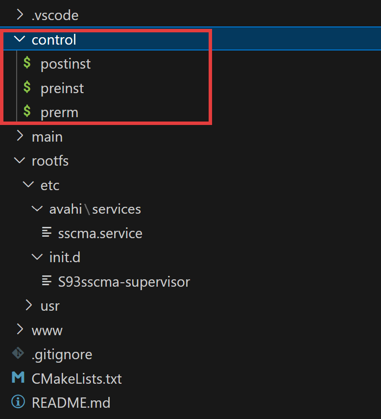

Add the Control directory
In your project, you need to include the following control scripts:

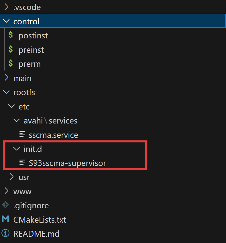

Add the rootfs directory
Then put the auto-start script into the corresponding path:
