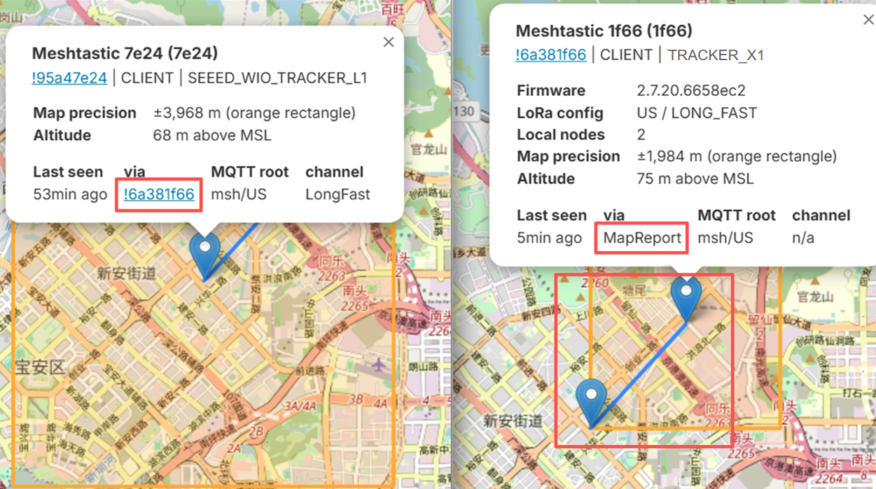

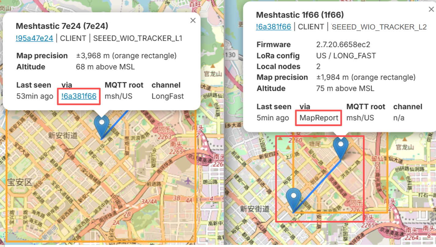

Viewing Device Locations​
Open MeshMap in your web browser: MeshMap Link.
You will see all nodes on the map. Nodes reported via MapReport are direct updates from the device. Nodes reported via other nodes are relayed updates.
Click on any node to view detailed information (device ID, battery level, etc.), mesh route and signal coverage

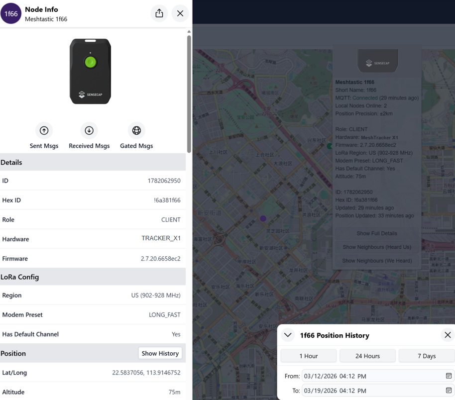

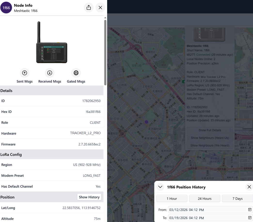

Open Liam Cottle's Meshtastic Map in your web browser: Liam Cottle's Map Link. You will see all nodes displayed on the map.
Click on any node to view: detailed information about the device, signal range, historical routes and previous location updates
