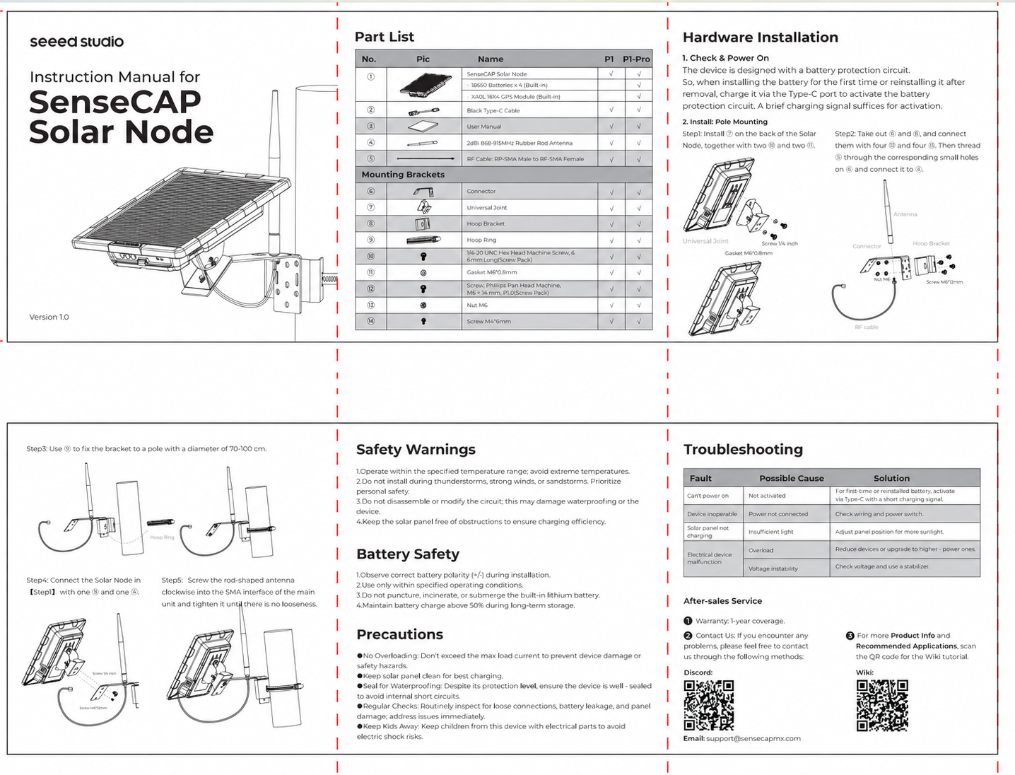

Hardware Overview​
Interactive items
pir
Accessories
pir
pir
Diagram
pir
