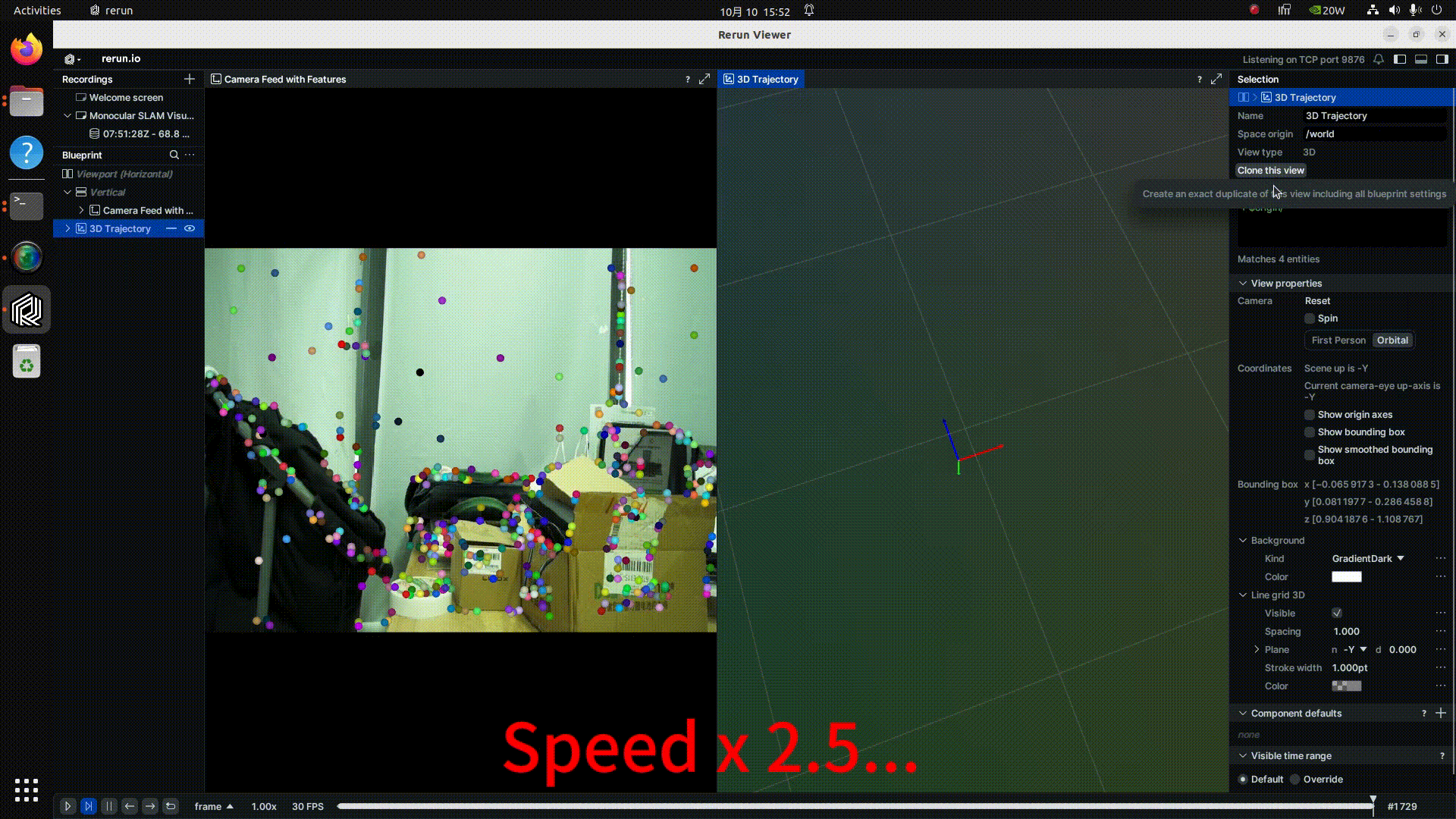

PyCuVSLAM demo in RViz: the reconstructed point-cloud map and the parking-lot loop trajectory above, with the live camera view and a second map view below

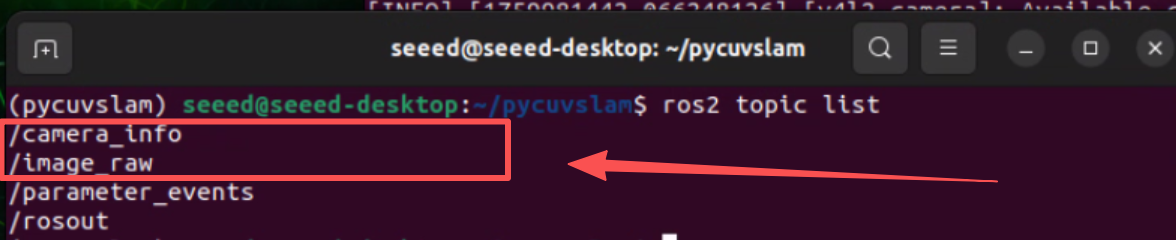

The default topics published are:
  • /image_raw - Raw camera image
  • /camera - Camera info
ros2 topic list showing /camera_info and /image_raw published by the v4l2_camera node

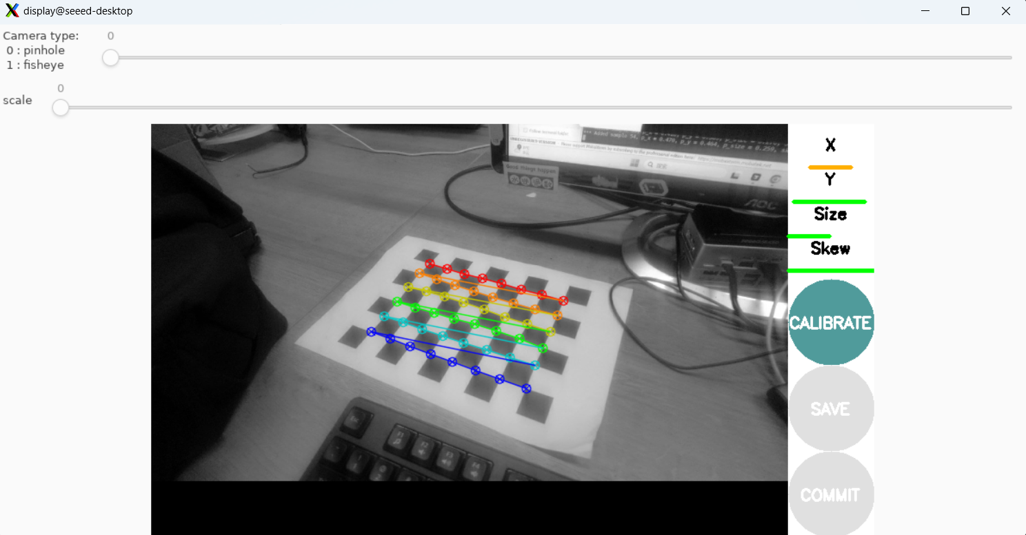

Step 3. Run camera calibration:
# In another terminal
ros2 run camera_calibration cameracalibrator \
--size 8x6 --square 0.025 \
--ros-args --remap image:=/image_raw --remap camera:=/camera
note
  • --size 8x6 refers to the number of inner corners (8×6 = 48 corners for a 9×7 grid)
  • --square 0.025 refers to the square size in meters (25mm)

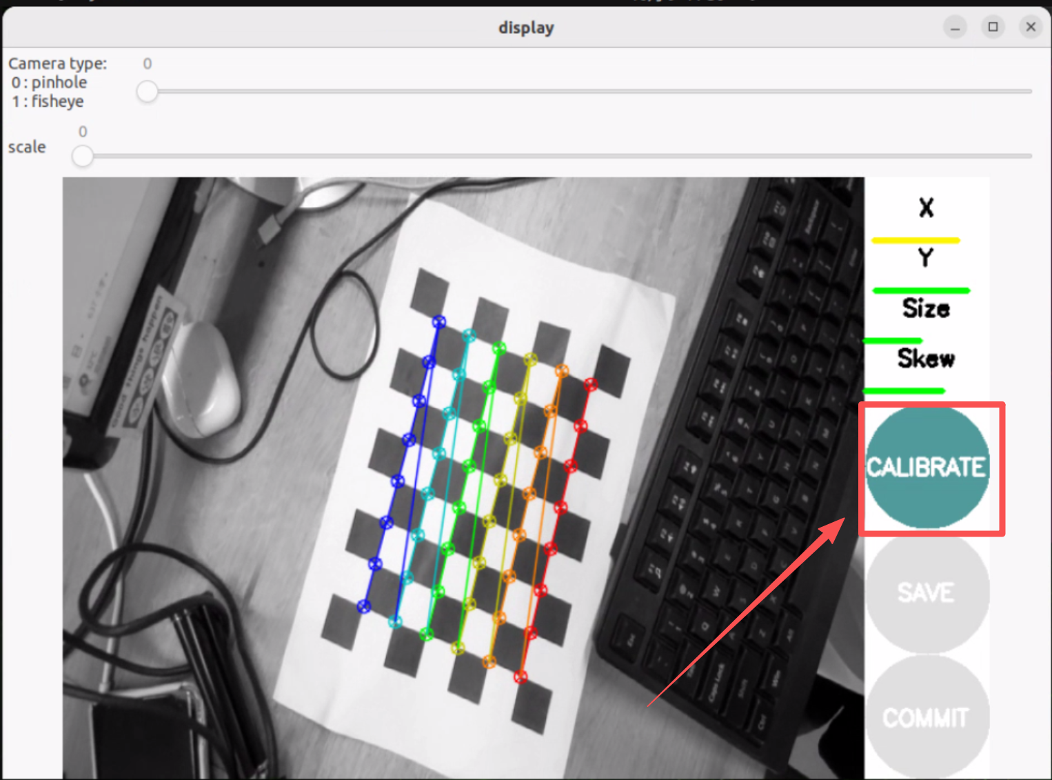

  • Move the camera around to capture images from different angles until the CALIBRATE button lights up
camera_calibrator window with the checkerboard views and the CALIBRATE button

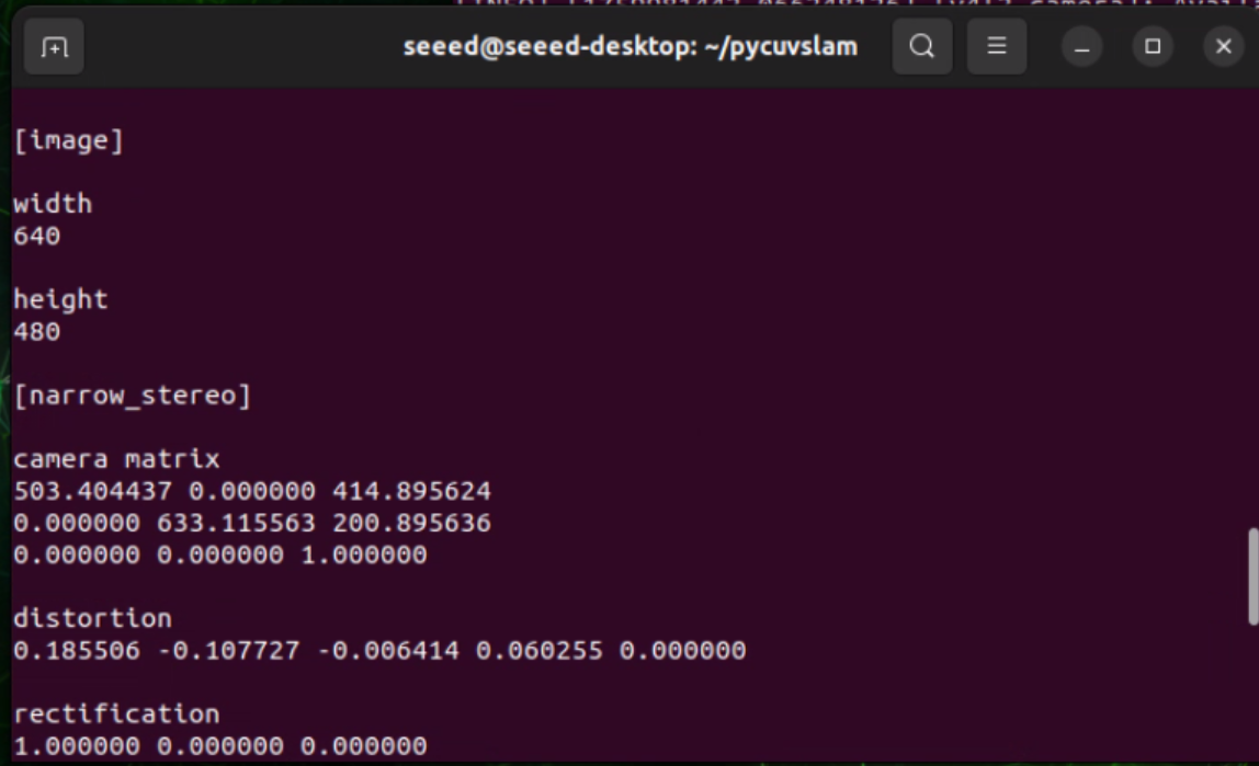

After successful calibration, you will obtain camera parameters in the terminal similar to:
Camera intrinsics and distortion coefficients printed in the terminal after calibration

python mono_slam.py --config /path/to/your/Camera parameters yaml file
note
You need to modify /path/to/your/Camera parameters yaml file to the yaml file where your camera parameters are saved. The content of the yaml file is as follows:
camera.yaml

RViz showing the monocular odometry point cloud beside the camera view, with the Speed x 2.5 overlay

note
You can check whether the camera node can start normally by observing whether the camera data topic is published normally.
ros2 topic list showing the Orbbec camera colour and depth topics
Step 2. Run RGB-D camera calibration:
ros2 run camera_calibration cameracalibrator --size 8x6 --square 0.025 \
--ros-args --remap image:=/camera/color/image_raw --remap camera:=/camera/color
camera_calibrator in fisheye mode on the RGB-D camera, with the CALIBRATE button boxed
For RGB-D cameras, you will obtain parameters for cameras:
[image]
width: 1280
height: 720
[narrow_stereo]
camera matrix:
690.546721 0.000000 684.064868
0.000000 683.586452 370.939099
0.000000 0.000000 1.000000
distortion:
-0.010482 -0.019797 0.001294 0.021572 0.000000
rectification:
1.000000 0.000000 0.000000
0.000000 1.000000 0.000000
projection:
654.569214 0.000000 734.393949 0.000000
0.000000 690.282776 371.706832 0.000000
