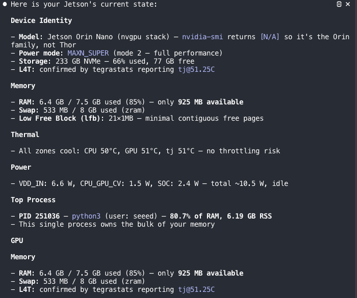

Start with jetson-diagnostic​
Use this first when you do not yet know whether the Jetson is ready for deployment. In practice, it gives the agent enough live device context to answer the questions that usually block the rest of the workflow: what Jetson model is running, which JetPack/L4T version is installed, how much memory is free, whether the device is thermally constrained, and whether major services or hardware endpoints are visible.
Prompt example:

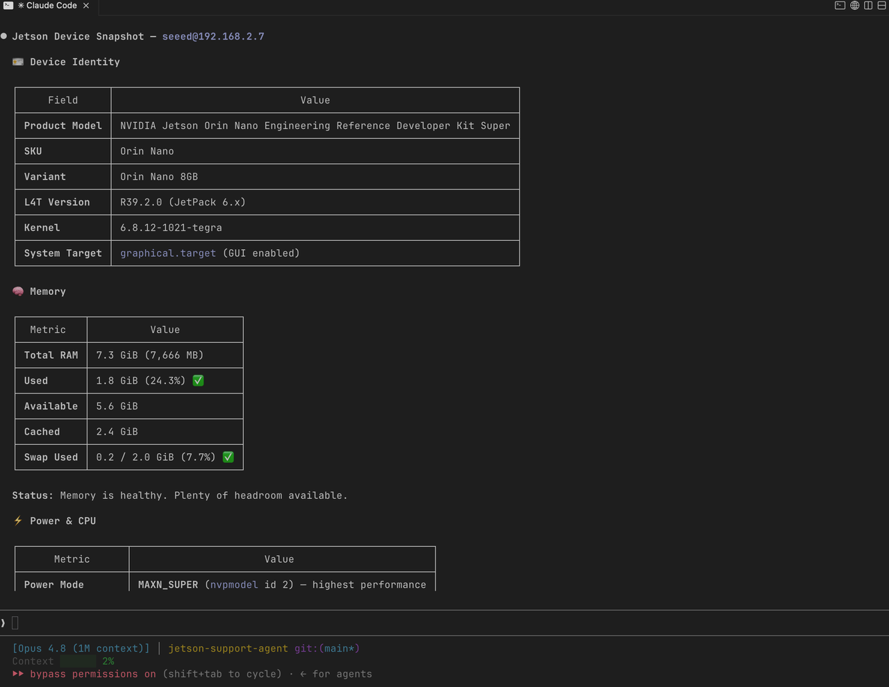

/jetson-diagnostic Check whether this Jetson is ready for a real-time vision prototype and summarize any blockers.
Jetson device snapshot from the diagnostic skill: model, L4T, Ubuntu, RAM, power mode and top process

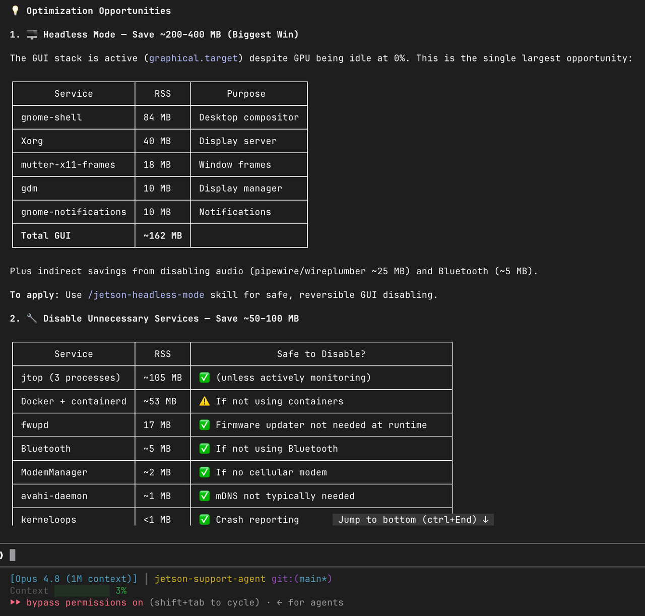

Use jetson-memory-audit when memory is the first bottleneck​
This is useful when the model loads slowly, the process is killed, or the device feels unstable under inference load. It gives the agent a data-backed view of what is currently using DRAM, whether a previous process really released memory, and whether a configuration change made a measurable difference instead of just sounding plausible.
/jetson-memory-audit Measure the current memory pressure and identify the biggest consumers before I deploy this prototype.
Optimization report listing the headless-mode and unused-service savings with the RAM each would free

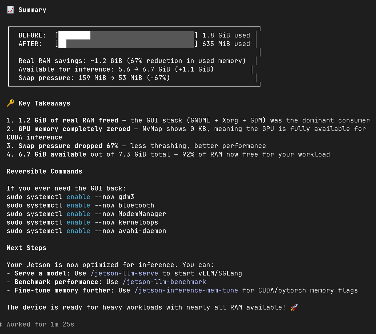

If the Jetson is used as a dedicated edge node rather than a desktop machine, switching to headless mode can reclaim resources for inference workloads.
/jetson-headless-mode Compare memory usage before and after enabling headless mode for this deployment target.
Memory use compared before and after enabling headless mode

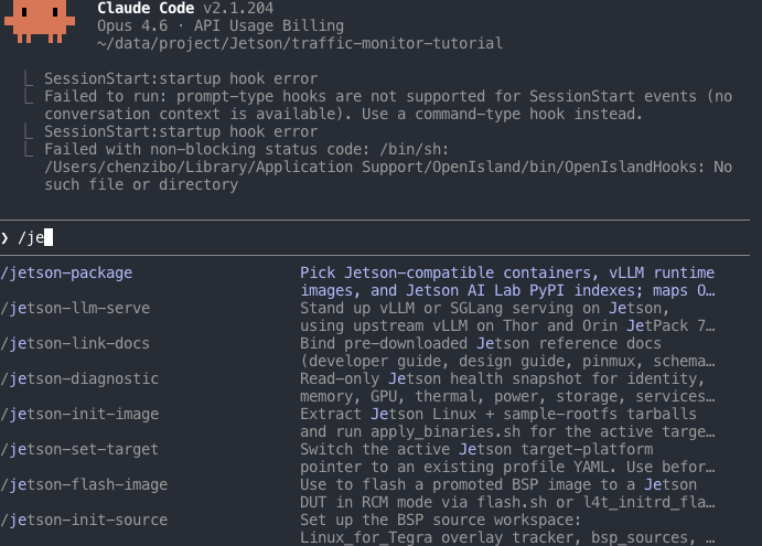

In the Claude Code example used in this article, skills live inside a .claude/ directory at the root of your project.
mkdir -p project/.claude/
cd project/
git clone https://github.com/NVIDIA/skills.git
cp -r skills/skills .claude/
claude
Once the claude command launches, you can type /<skill-name> to explicitly force the agent to read a specific skill. That is useful when you already know which workflow you want. But once the skills are installed in the workspace, the agent already knows they exist and can choose among them automatically from your request. In practice, it may chain several skills in one pass, for example combining diagnosis, package selection, memory inspection, and prototype generation instead of treating each step as a completely separate session.
Claude Code session listing the /jet skill commands, with two SessionStart hook errors

Step 1. Diagnose the device​
Start by checking whether the Jetson is actually ready for a vision workload. A prompt like the following gives the agent enough context to inspect the device and report the blockers that matter for the prototype rather than just dumping raw telemetry.
/jetson-diagnostic Check the current status of my Jetson and summarize any blockers for a vision prototype.
SSH login: seeed@192.168.6.204
Password: seeed
note
The IP address and password above are example values. Replace them with your own Jetson credentials. seeed is the default password on some Seeed Jetson devices and should be changed on production units.
Device check output listing the Jetson model and the JetPack version

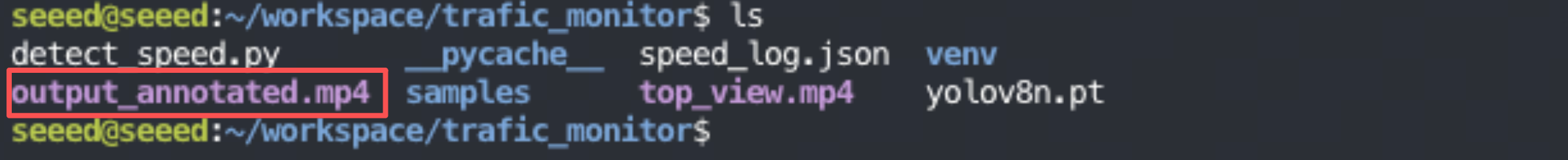

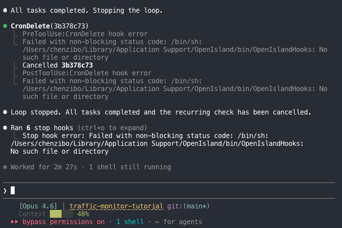

By the end of this step, you want a main inference script or app entrypoint, a clear rerun path, an annotated output video or similar artifact, and generated files placed in a known workspace. If those pieces exist, the baseline is already useful even if the final stack is still open to change.
Agent session ending with the task loop stopped and the stop-hook errors printed
Working directory listing detect_speed.py, the input videos, yolov8n.pt and output_annotated.mp4

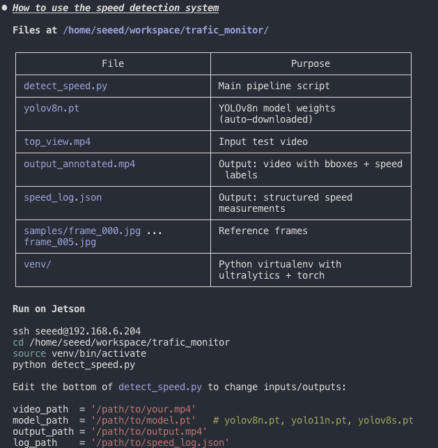

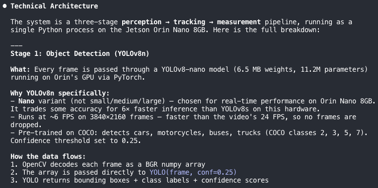

Once the first pass exists, ask the agent to explain what it created and how to run it again.
Please explain the generated files, the rerun command, the output locations, the current bottlenecks, and the technical approach and architecture you are using.
At this point, the useful questions are no longer “did anything run?” but “what exactly was created, how do I run it again, where are the outputs, and what did the agent choose architecturally?” A good follow-up explanation should leave you with a clear view of the file layout, the rerun path, the output locations, the detection and speed-estimation approach, and the likely performance bottleneck.
Usage sheet listing each file of the speed detection project and what it does
Technical architecture write-up: the three-stage perception, tracking and measurement pipeline with the YOLOv8n stage detail
This saves time because the agent is not only generating code. It is also shortening the time needed to understand and evaluate the baseline it just produced.

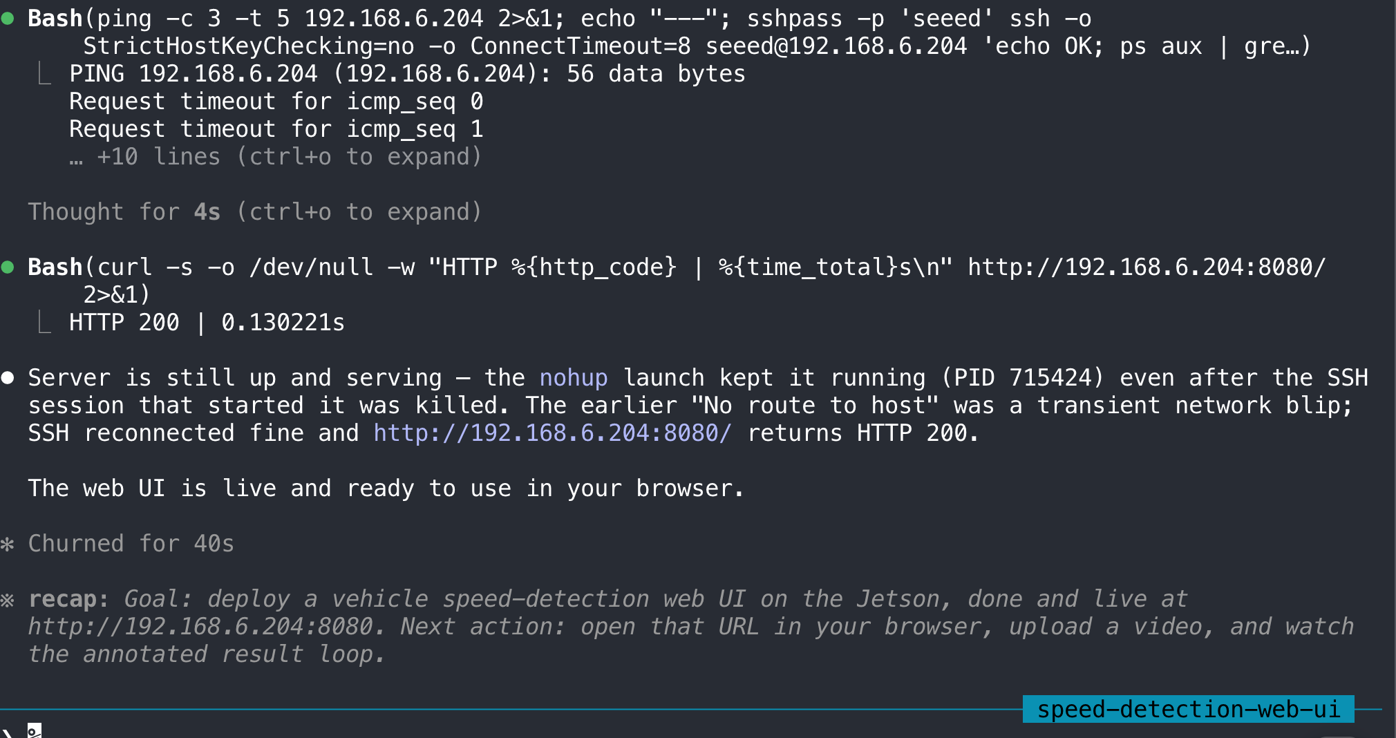

Step 5. Package the prototype into something shareable​
Once the algorithm works from the command line, the next gap is usually demoability.

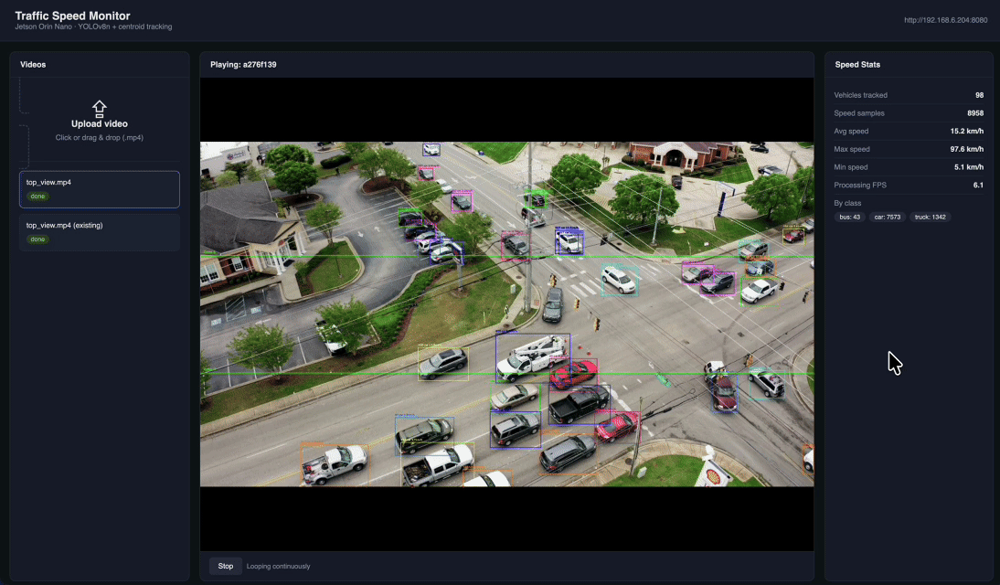

Help me create a web UI that I can access from my local PC to upload videos for detection and continuously loop the output video.
The agent can wrap the prototype in a small web service or similar interface so teammates or customers can try it without touching the command line.
Agent log verifying the deployment: ping reply, HTTP 200 from the web UI and the nohup process still serving
note
To reach the UI from your local PC, make sure the chosen port is accessible on the Jetson and that both machines are on the same network, or use SSH port forwarding. When judging inference speed, use the local Jetson-side runtime as the reference point, because a forwarded web UI may feel slower due to network latency rather than model performance alone.
Traffic Speed Monitor web UI with the uploaded video, the detected vehicles and the Speed Stats panel
