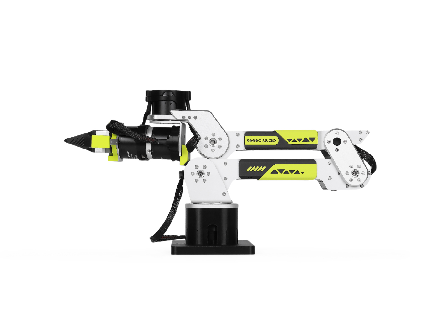

Connect the Arms
Safety notice: Disconnect the power before connecting or disconnecting JST, XT30, or other cables. Turn the power on only after confirming that all cables are connected correctly. B601 RS and B601 DM look similar. Make sure you distinguish between them.

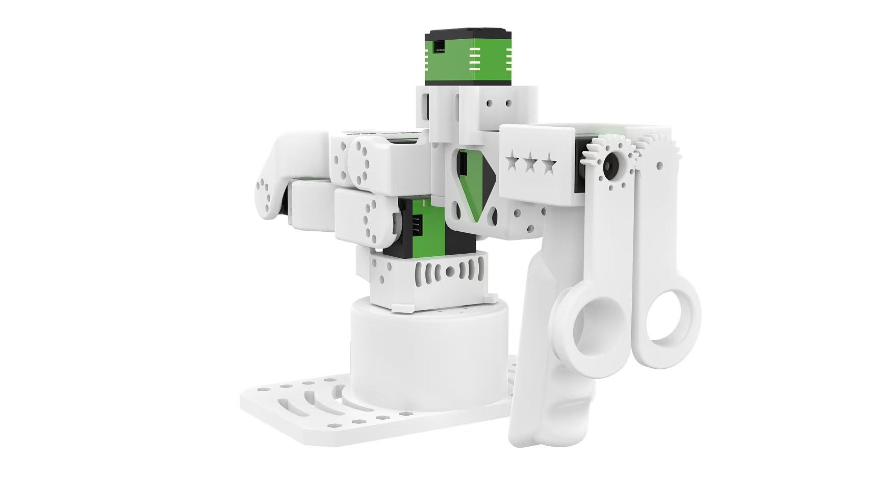

Mount and Connect the reBot Arm 102 (Leader Arm)
Mount the reBot Arm 102
Step 1
Use woodworking clamps to secure the reBot Arm 102 to a flat tabletop. Gently push the base to confirm that it does not move.
Connect the Cables
Step 2
The connections consist of two paths:
Signal path (arm -> USB-C cable -> computer)
- Prepare a USB-C cable to connect the arm to the computer (do not plug it into the computer yet; connect it when you reach serial-port binding and scan for devices).
Power path (arm -> 12 V 2 A power adapter -> power strip -> power on)
- Connect the 12 V 2 A power adapter to the arm's power connector.
- Connect the adapter to the power strip to power on the arm.
Mount and Connect the B601 DM (Follower Arm)
Mount the B601 DM
Step 3
Use G-clamps to secure the B601 DM to a stable, flat tabletop. After securing it, gently rotate the arm left and right to confirm that the base does not move.
Connect the Cables
Step 4
Make sure the power is disconnected before starting. The connections consist of two paths:
Signal path (arm -> signal/power separation board -> USB-CAN driver board -> computer)
- Use an XT30 2+2 cable to connect the first motor at the bottom to the signal/power separation board.
- Use the 2-pin JST cable to connect the signal/power separation board to the USB-CAN driver board.
- Use the 3-pin JST cable to connect the first motor at the bottom to the USB-CAN driver board (this is a debug cable and may be left disconnected).
- Prepare a USB-C data cable to connect the USB-CAN driver board to the computer (do not plug it into the computer yet; connect it when you reach serial-port binding and scan for devices).
Power path (arm -> signal/power separation board -> 24 V power adapter -> outlet -> power on)
- Connect the signal/power separation board to the 24 V power adapter.
- Connect the power adapter to the outlet. After confirming that the arm is secured, the cables are correct, and the surrounding area is clear, turn on the power.
