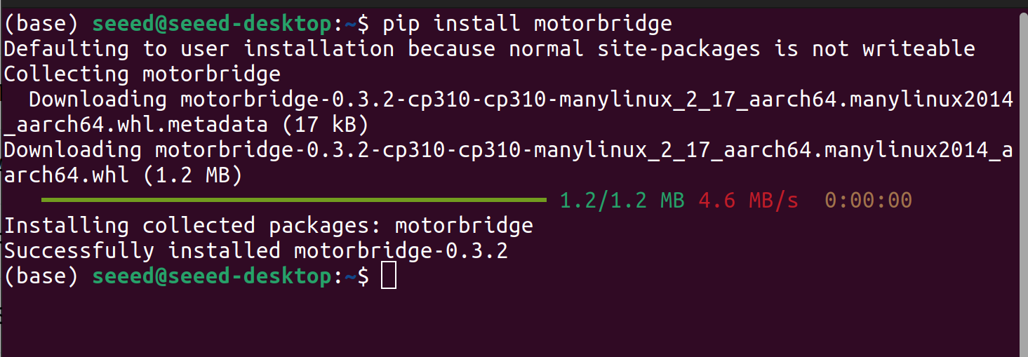

One-Click Install Arm Driver​
Open the terminal window on the Jetson and run the following command.
uv pip install motorbridge

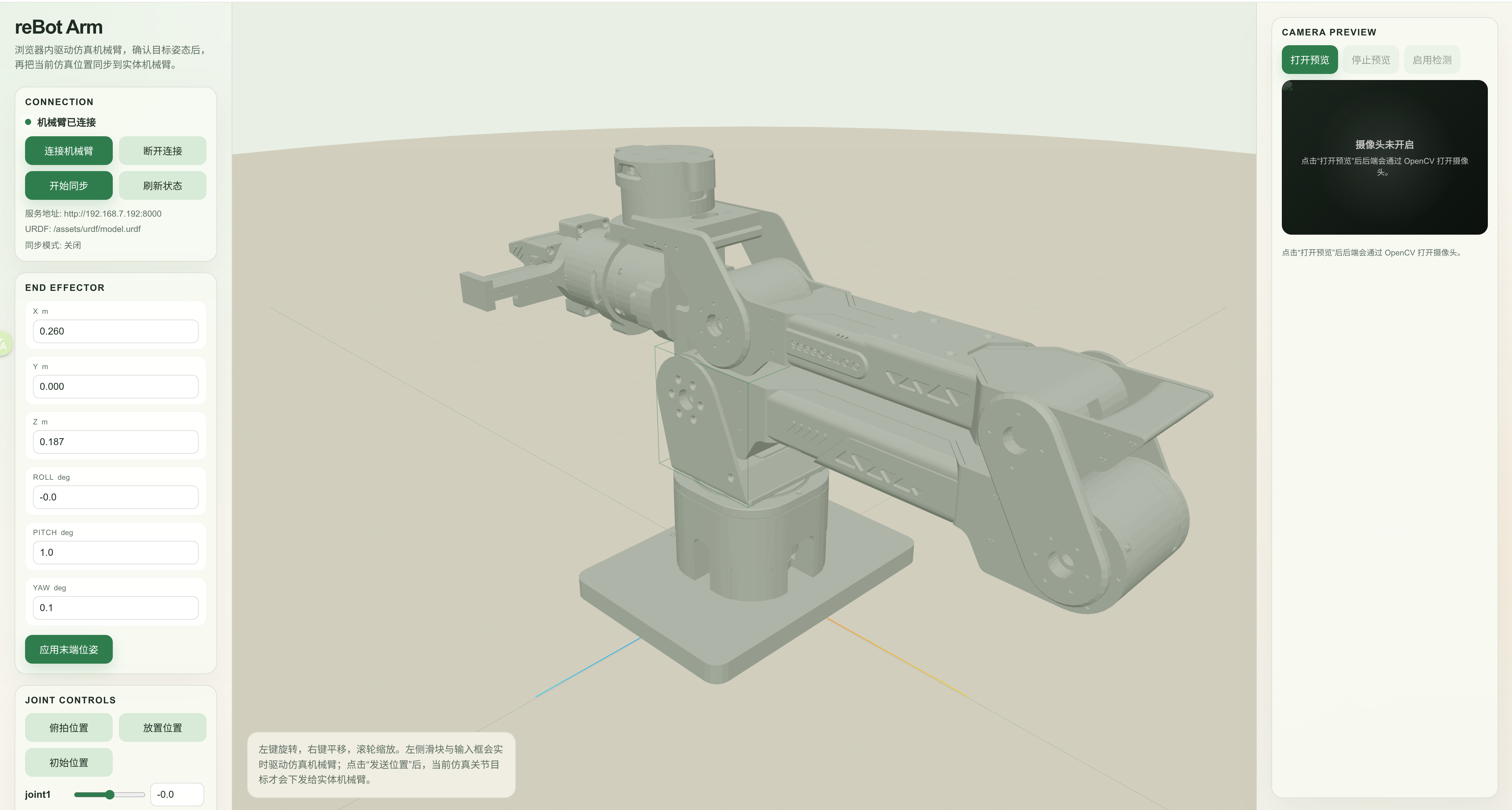

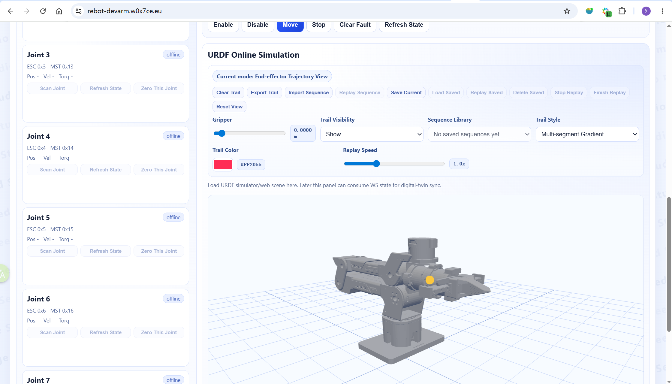

motorbridge-gateway --bind 127.0.0.1:9002 --vendor damiao --transport dm-serial --serial-port /dev/ttyACM0 --serial-baud 921600 --dt-ms 20
Then, Open https://motorbridge.github.io/motorbridge-studio/ in your browser, and you will see the following page. From this interface, you can adjust motor parameters, check the status of the robotic arm, and perform other operations.
