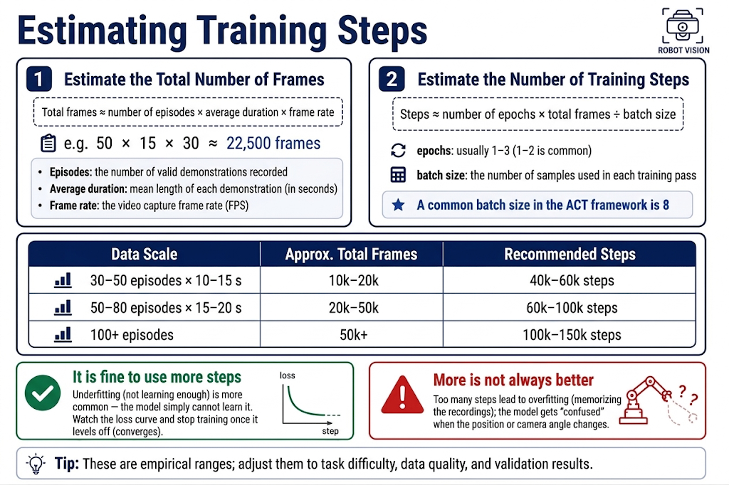

For 50 Episodes, if you don't want to read the steps explanation below, just run it at 80,000 (50 Episodes).
Steps scale proportionally: if batch size is halved, samples seen per step are halved; to give the model the same number of passes (epochs), steps must double. E.g., default batch size=8, steps=80000; batch size=4 → steps=160000; batch size=2 → steps×4; batch size=16 → steps÷2.
You can also set more steps — during training you can press Ctrl+C to stop at any time, choosing whether to stop based on loss and other parameters; the model generated so far is saved automatically.
  • Total frames ≈ total length of the video recordings.
  • epoch (one pass) = the student watches the entire recording from start to finish.
  • steps = how many segments the student watched in total.
Training steps

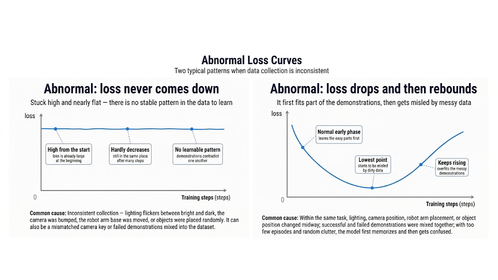

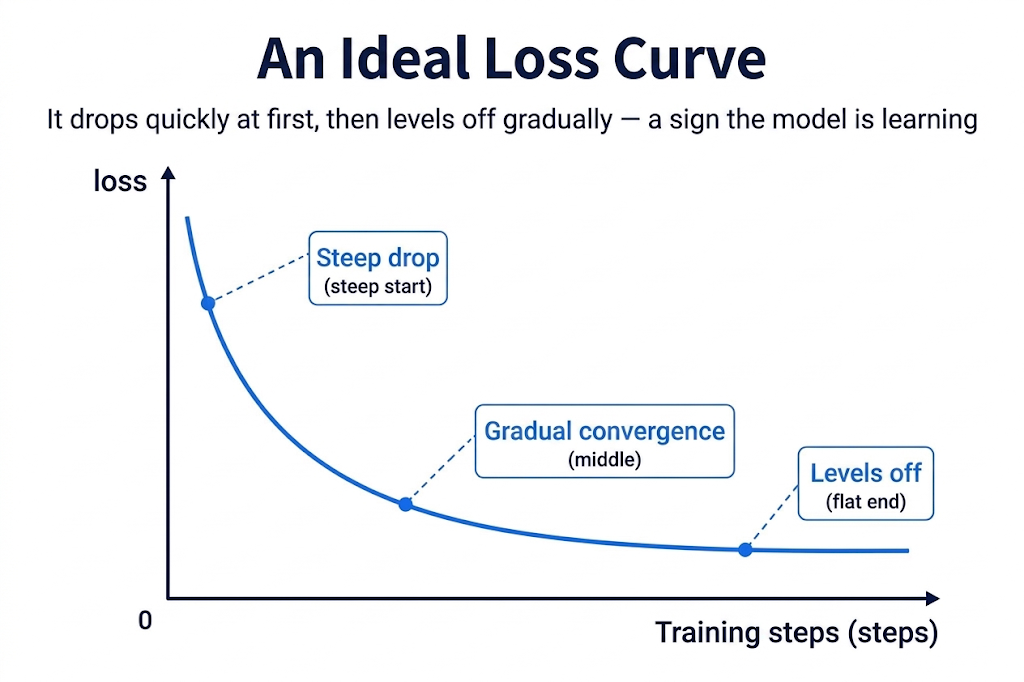

  • Should keep declining — loss. The decline has three phases: initial steep drop, mid gradual decline, late small fluctuations at a low level, overall flattening. This "fast then slow then flat" curve is a healthy convergence curve. Two abnormal shapes to watch: never drops (data/config problem — check camera keys); drops then bounces back (training divergence — halve LR and retrain).
