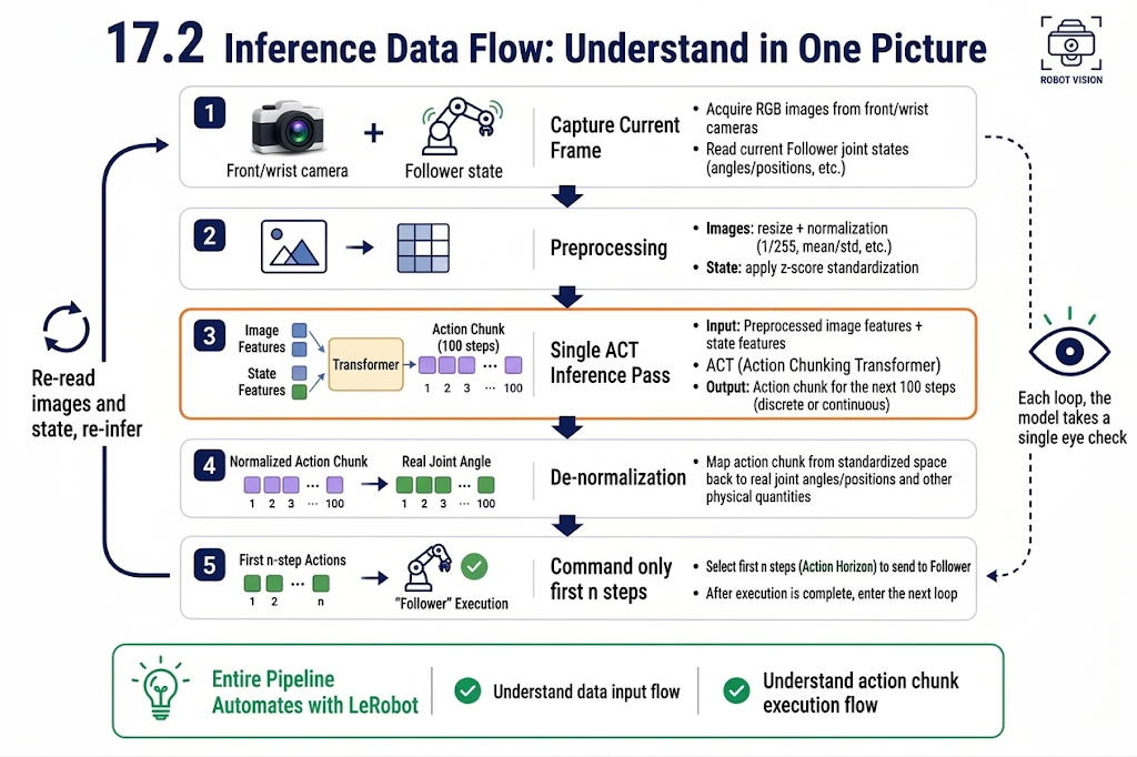

17.1 Inference Data Flow
Flow
17.1 Inference Data Flow: Understand in One Diagram
Inference data flow

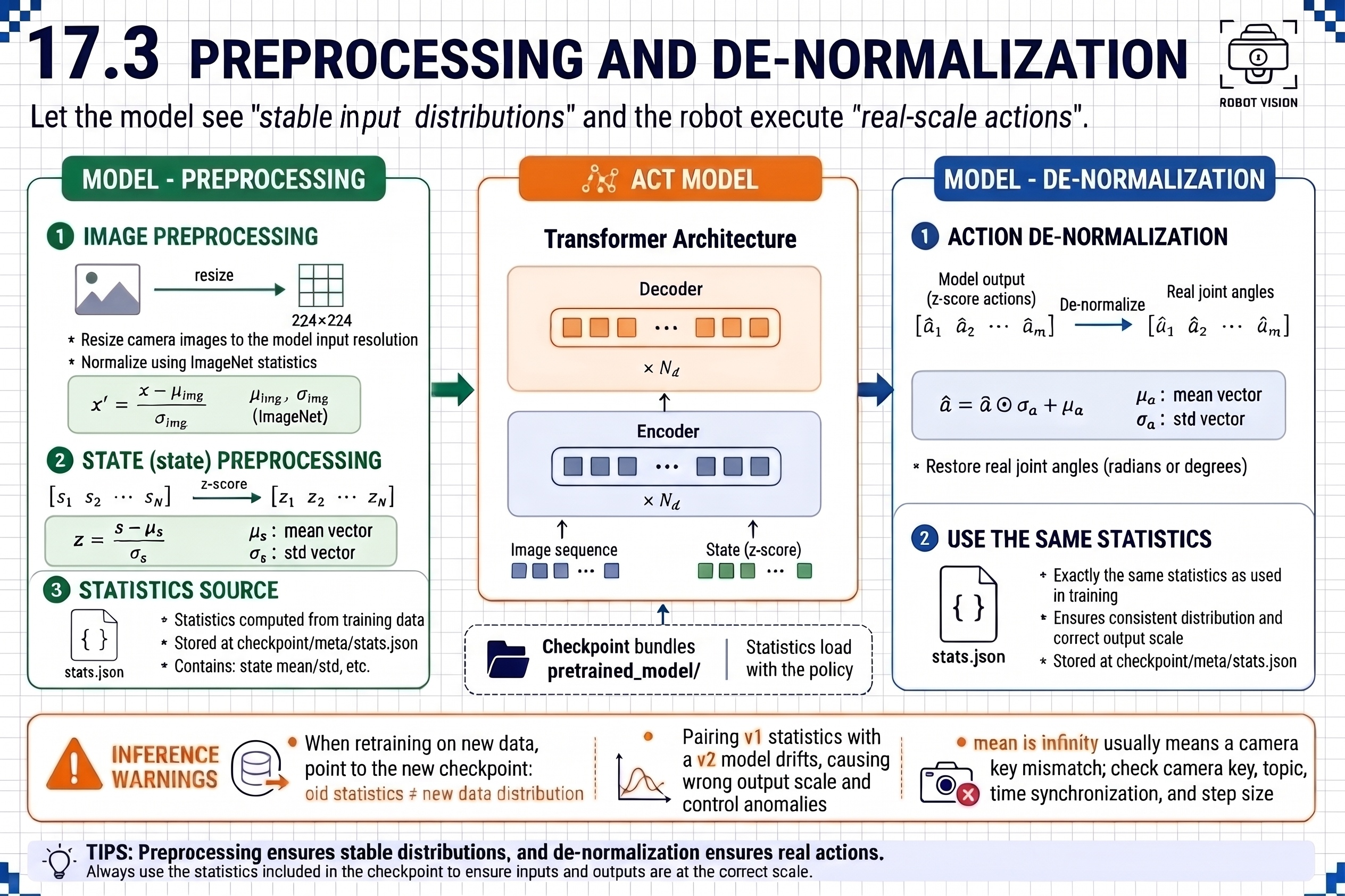

17.2 Preprocessing and De-normalization
Preprocessing
During training the model eats normalized data; during inference you must follow the same rules for both input and output:
DirectionProcessingStatistics Used
Into modelImage resize + ImageNet mean/std; state minus mean, divided by std (z-score)Training dataset's meta/stats.json
Out of modelAction multiplied by std, plus mean; restore to real joint anglesSame as above
Preprocessing and de-normalization

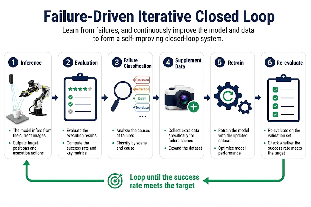

17.9 Data Iteration: Failure-Driven Data Collection
Iteration
The final step of the loop — turn failures into data:
  1. Categorize: identify failure type and corresponding scene.
  2. Supplement: record 10-20 new demonstrations for the failure scene — can't reach? record at that position; unstable grasp? record the grasp moment. Consciously expand the grasp boundary gradually — e.g., place blocks at points 5-10 cm beyond the original cross to expand the dataset.
  3. Retrain: retrain with the new dataset.
Data iteration
With this, the closed loop from the start of the chapter is fully complete: teleoperation, collection, inspection, training, inference, evaluation, iteration — this pipeline is reused as-is for any new task. That is the core deliverable of Stage 3.
