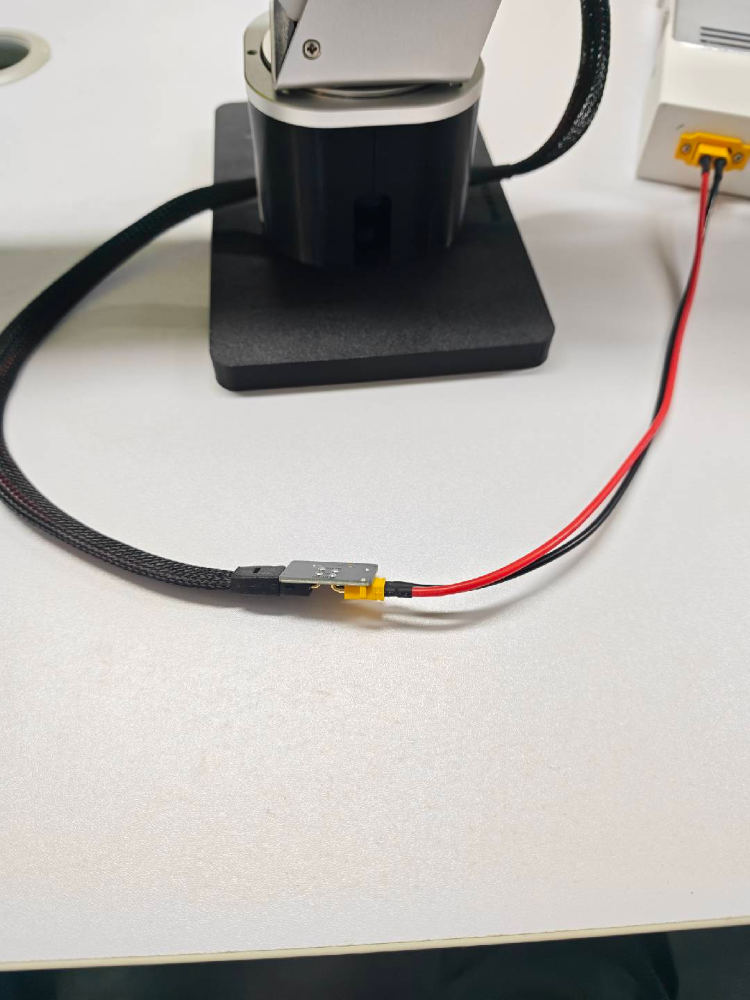

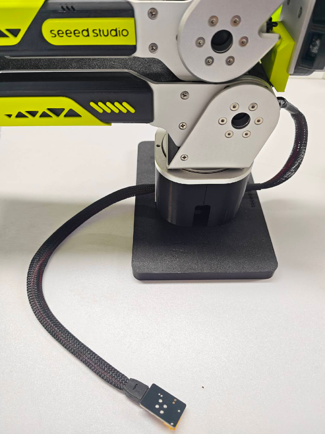

1

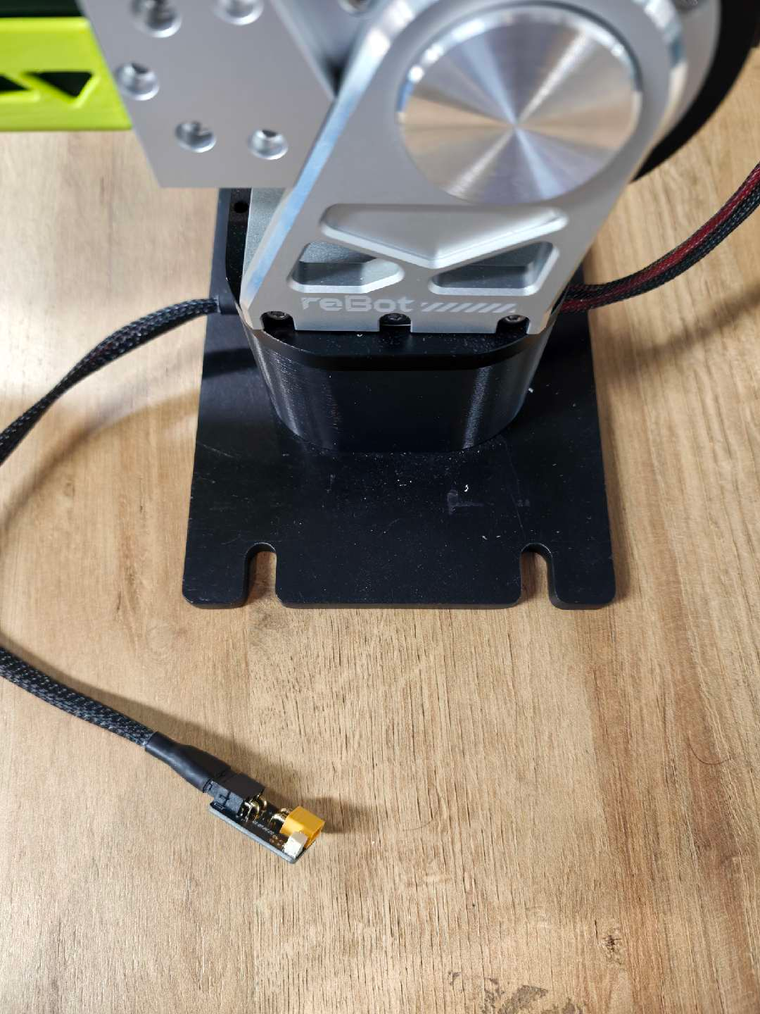

Connect the robotic arm to the adapter board.

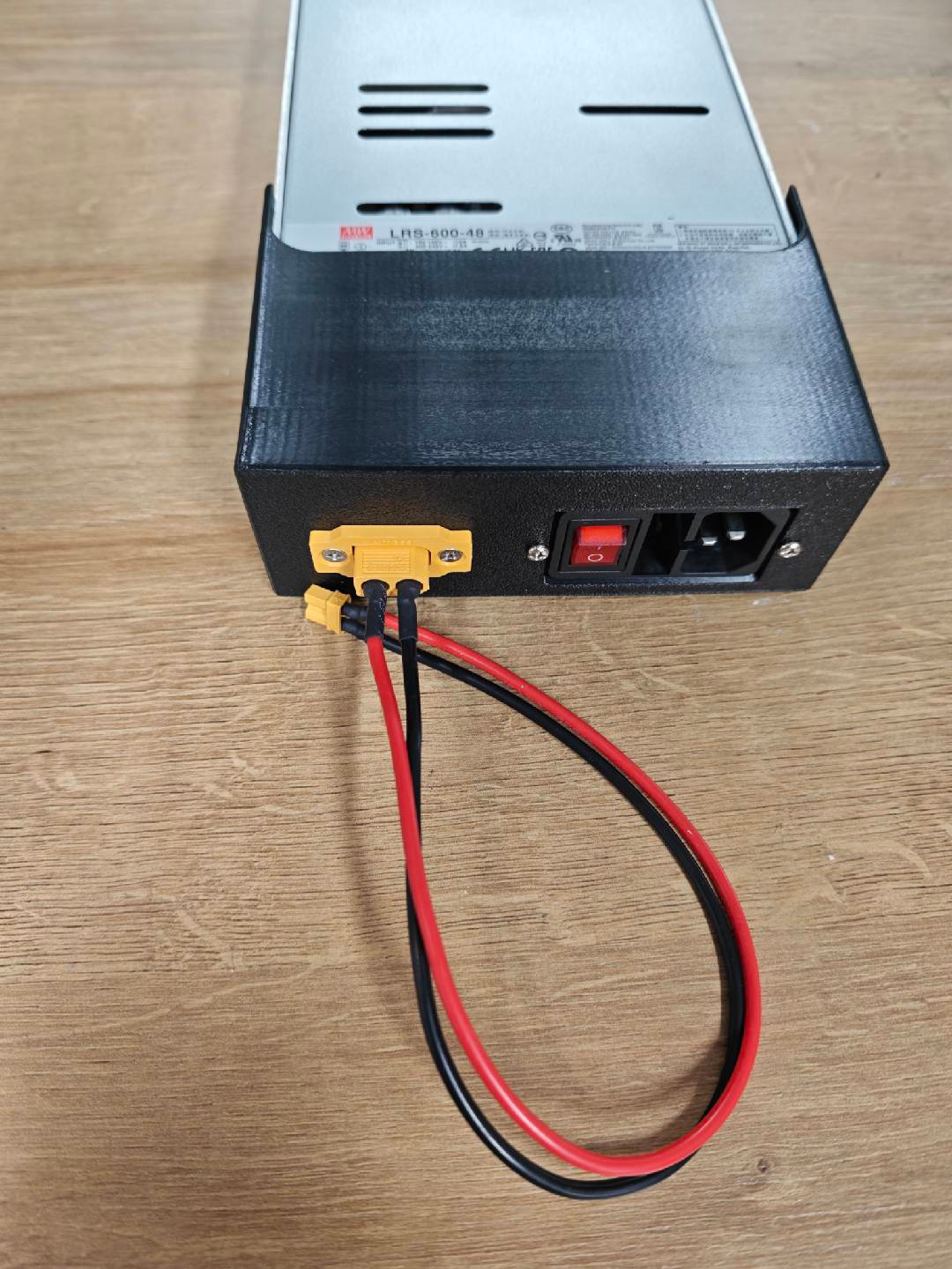

2

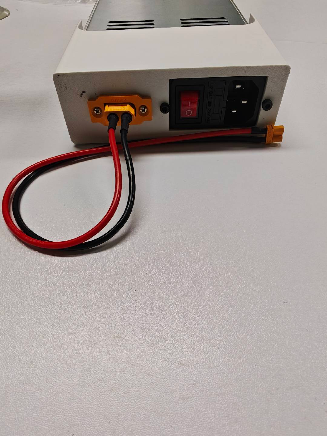

Power supply connection: XT60 to XT30 cable.
3
Connect the XT60 to XT30 cable to the adapter board.

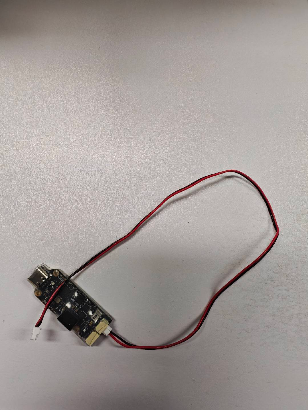

4

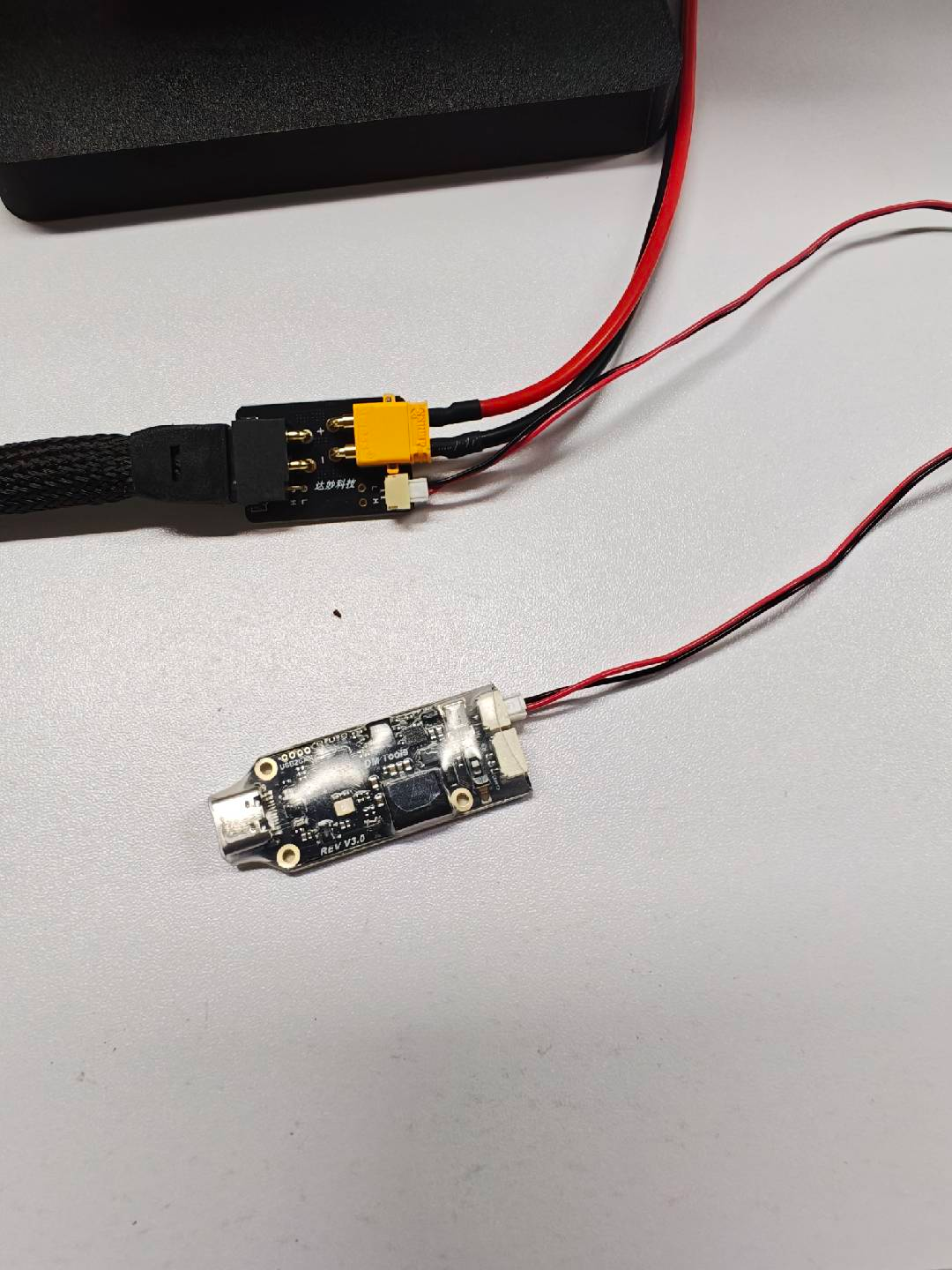

Connect USB2CAN to GH1.25 2-pin.
5
Connect the other end of the GH1.25 2-pin cable to the adapter board.

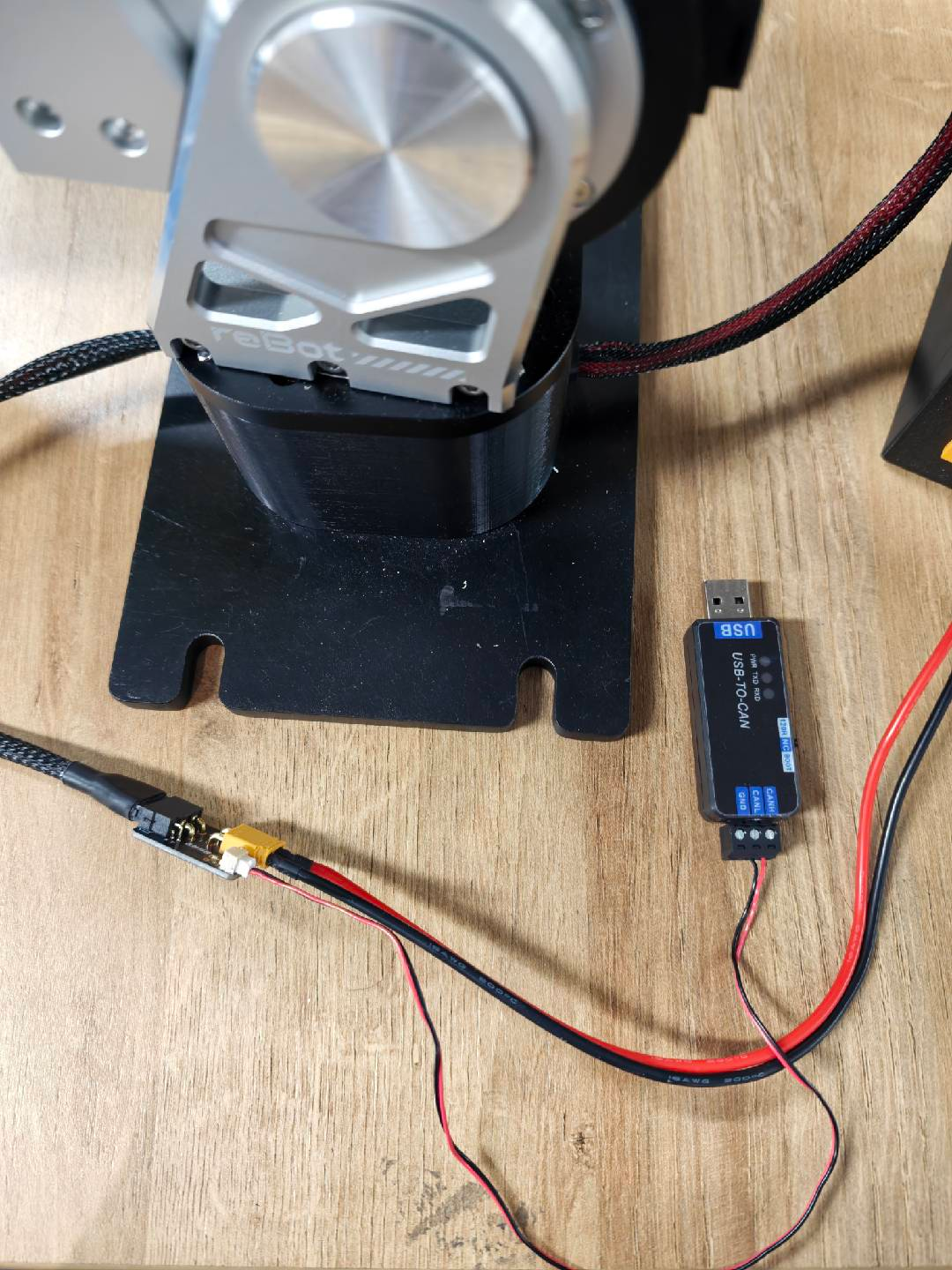

6
Connect USB2CAN to the computer via a Type-C data cable.
warning
Motor 1 and motor 2 must be connected to each other.

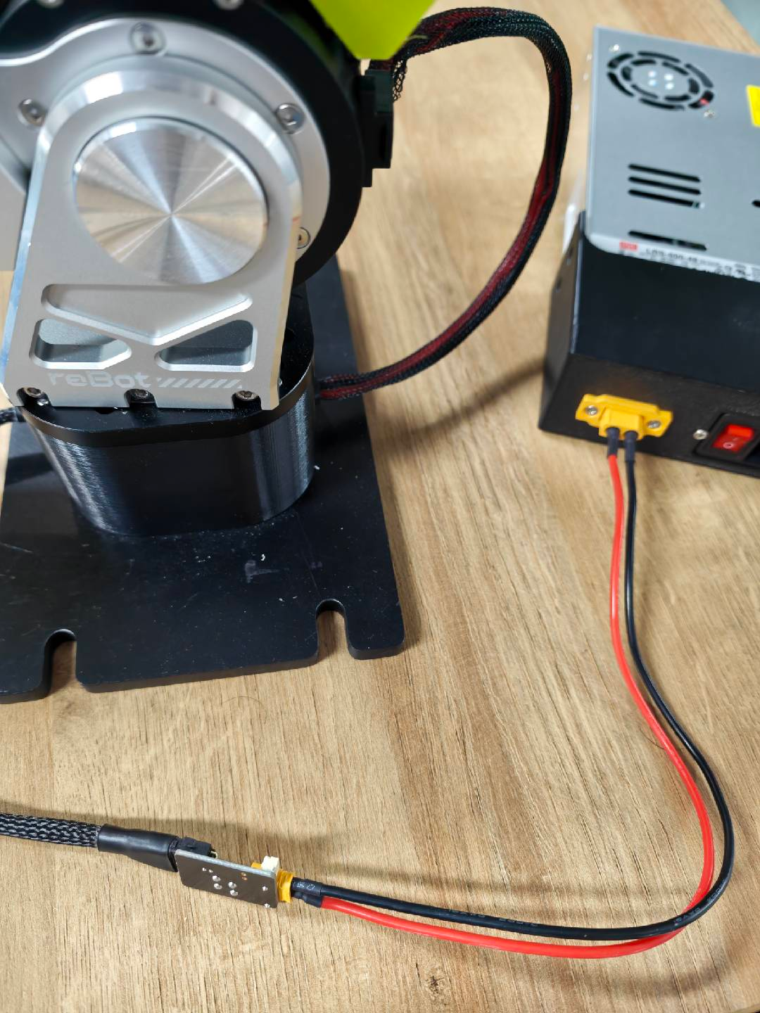

1
2
3
4

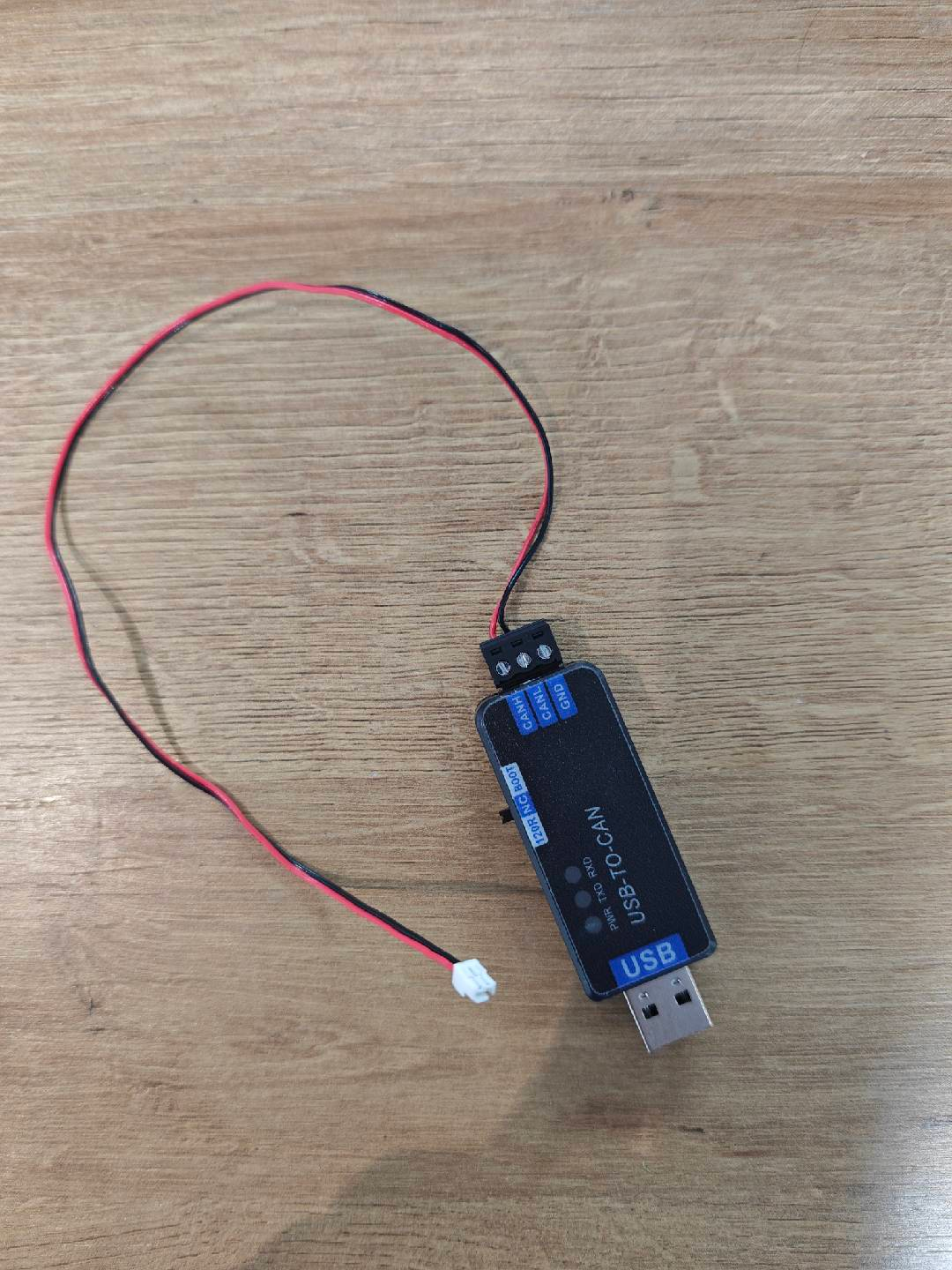

Connect CANable to GH1.25 2-pin cable.
5
6
Connect CANable to the computer.
warning

The power supply requirement for reBot DM is 24V, and the power supply requirement for reBot RS is 48V.
Below are our recommended power supply usage instructions:

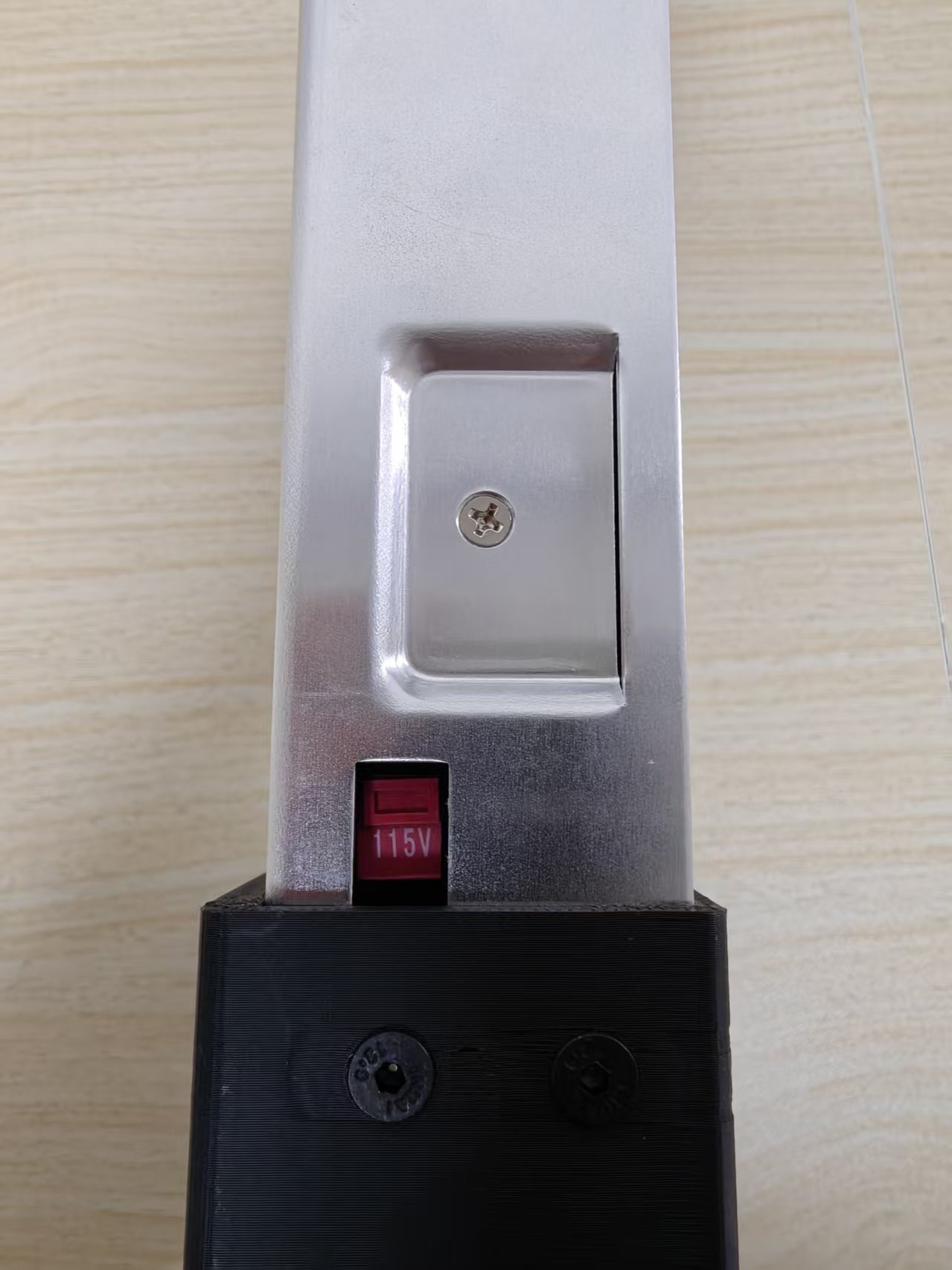

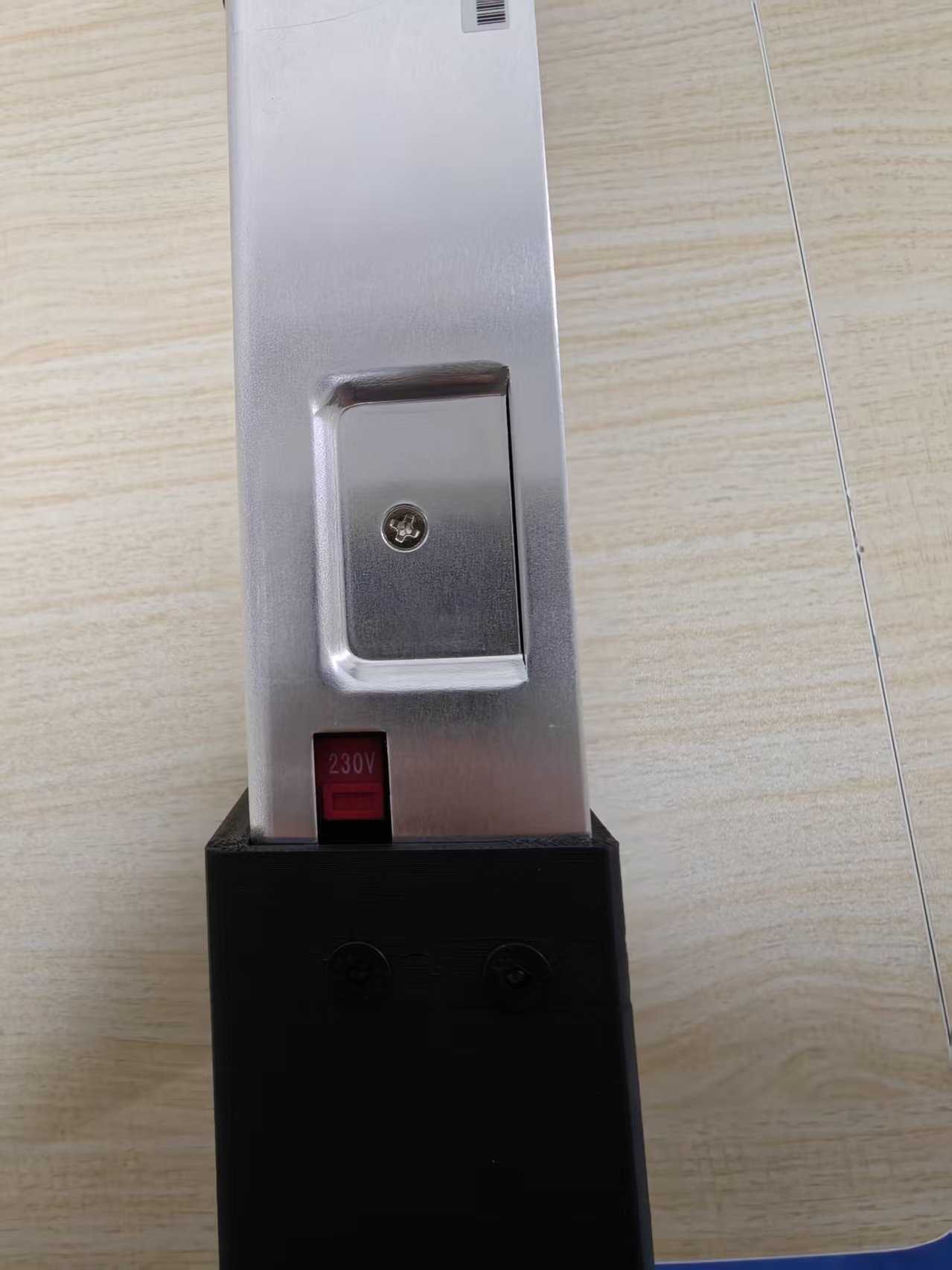

Set the voltage selector correctly!
If your household voltage is 220V, please set the DIP switch on the side of the power supply to 230V. If your household voltage is 110V, please set the DIP switch on your power supply to 115V.
220V → 230V110V → 115V
Power supply DIP switch 220VPower supply DIP switch 110V

For the reBot DM robotic arm, the lights of all joints will light up and turn red, at which point the robotic arm is in a disabled state.
The reBot RS robotic arm is no different from when it is powered off, and can only be determined through communication with the motor.
