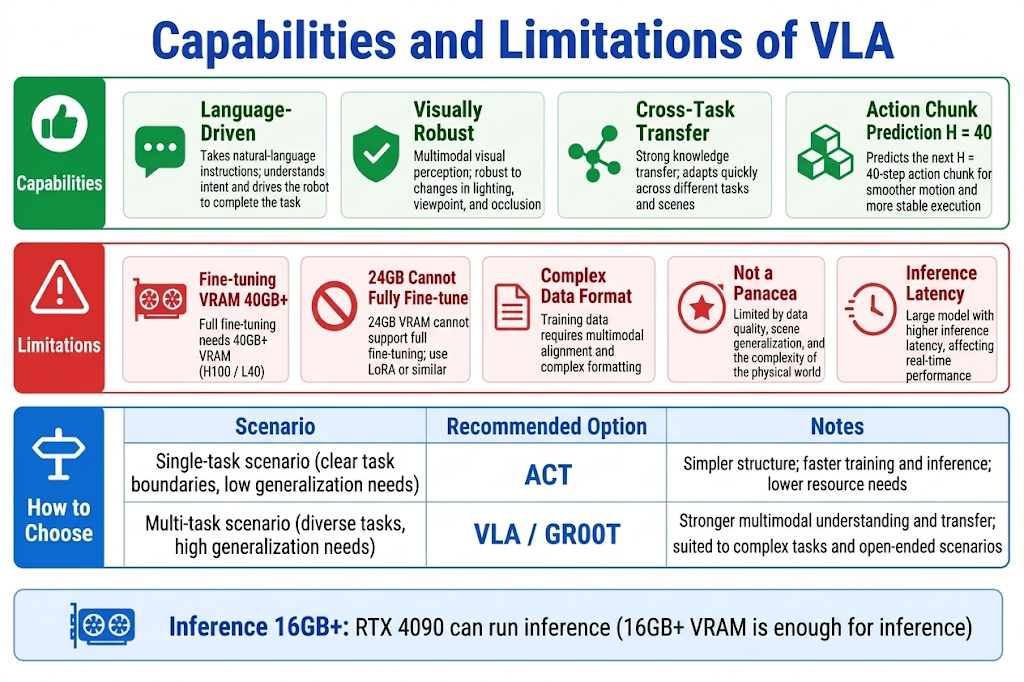

18.8 Capabilities and Limitations of VLA​
Capabilities
Capabilities and limitations of VLA
Capabilities​
  • Language-driven: one model, many tasks; switch behavior by changing the instruction.
  • Visual robustness: large-scale pretraining brings better scene understanding than small ACT.
  • Cross-task transfer: representations can be shared among similar sentence patterns and similar objects.
  • Action-chunk prediction: one inference outputs multiple steps, suitable for real-time control (with RTC inference policy).
Limitations​
  • High compute demand: N1.7-3B recommends 40 GB+ VRAM for fine-tuning (H100 / L40; training only the projector + DiT head peaks around 35 GB; the official simulation fine-tuning tutorial requires ≥ 48 GB). Inference needs only 16 GB+ (RTX 4090 can run inference). Full fine-tuning on a 24 GB card is basically infeasible unless using efficient fine-tuning such as LoRA / PEFT.
  • More complex data format: beyond standard LeRobot fields, a modality.json and embodiment tag are required.
  • Not a panacea: objects, instructions, and workstation layouts not covered by the training set may still fail.
  • Latency: large-model inference is slower than ACT; set n_action_steps and RTC parameters appropriately.
  • Sim-to-real gap: pretraining data is dominated by humanoid/specific platforms; desktop arms require sufficient fine-tuning.
When to Choose ACT, When to Choose VLA?​
ScenarioRecommendation
Single repetitive task, edge device, low latencyACT
Multi-task, language interaction, willing to invest in GPU and annotationVLA / GR00T
Already have ACT data, want to expand to multi-taskAdd language to existing LeRobot data -> GR00T fine-tuning
