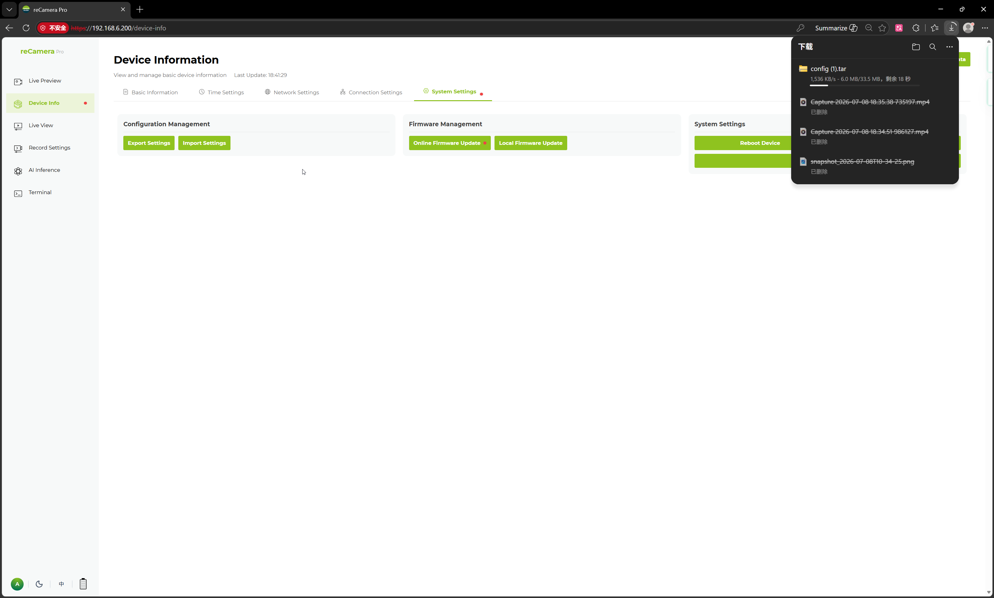

Device Info also reports hardware/software versions and resource usage — see Basic information at the bottom, and Back up and restore and Firmware update and recovery for the remaining System Settings items.

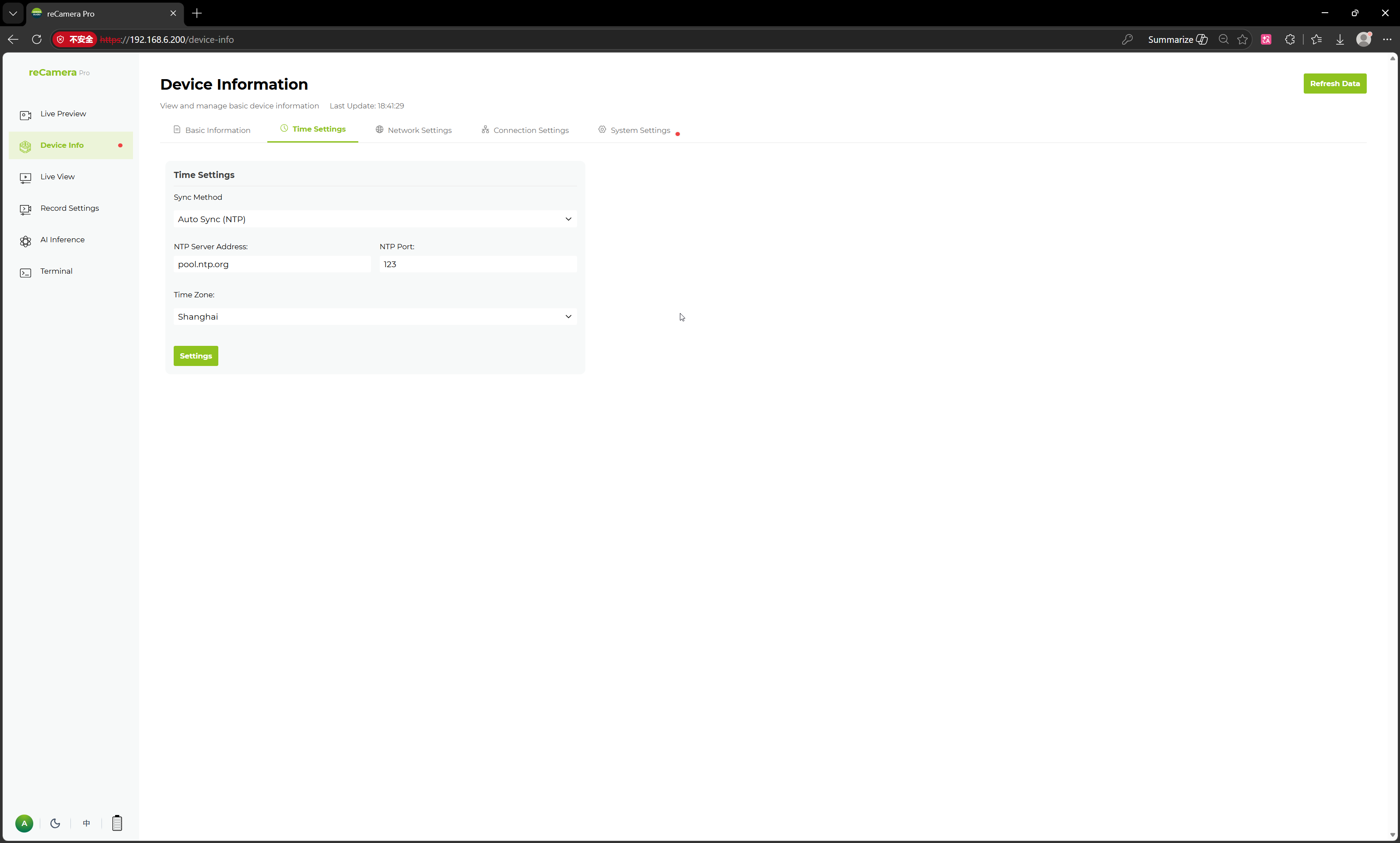

Time settings​
The system time drives recording schedules, file timestamps, and log entries. Set it in Device Info → Time Settings.
  • Verify the clock after every reboot and after moving the device to a network without Internet access.
  • If schedules or recording directories land at the wrong hours, check time first — a wrong clock is the most common cause.

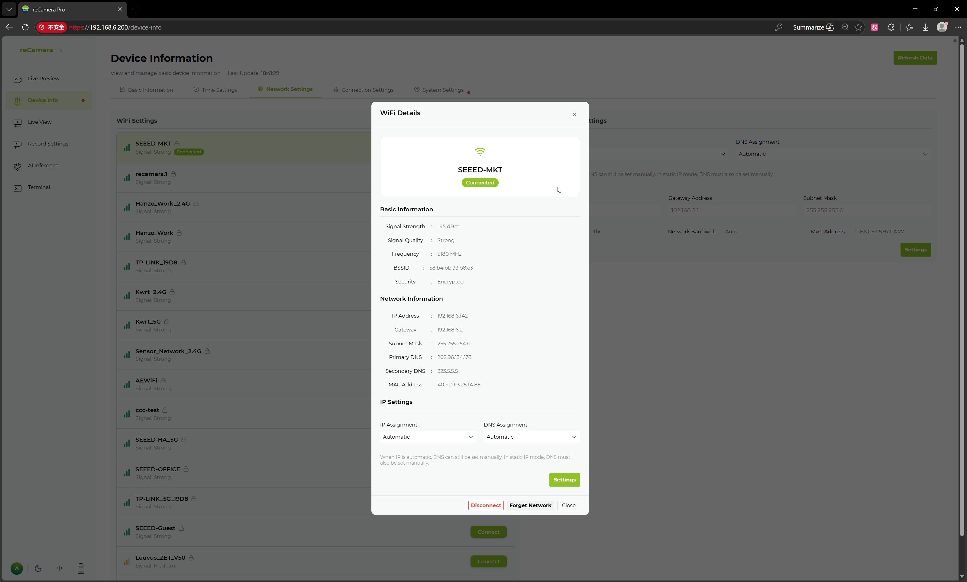

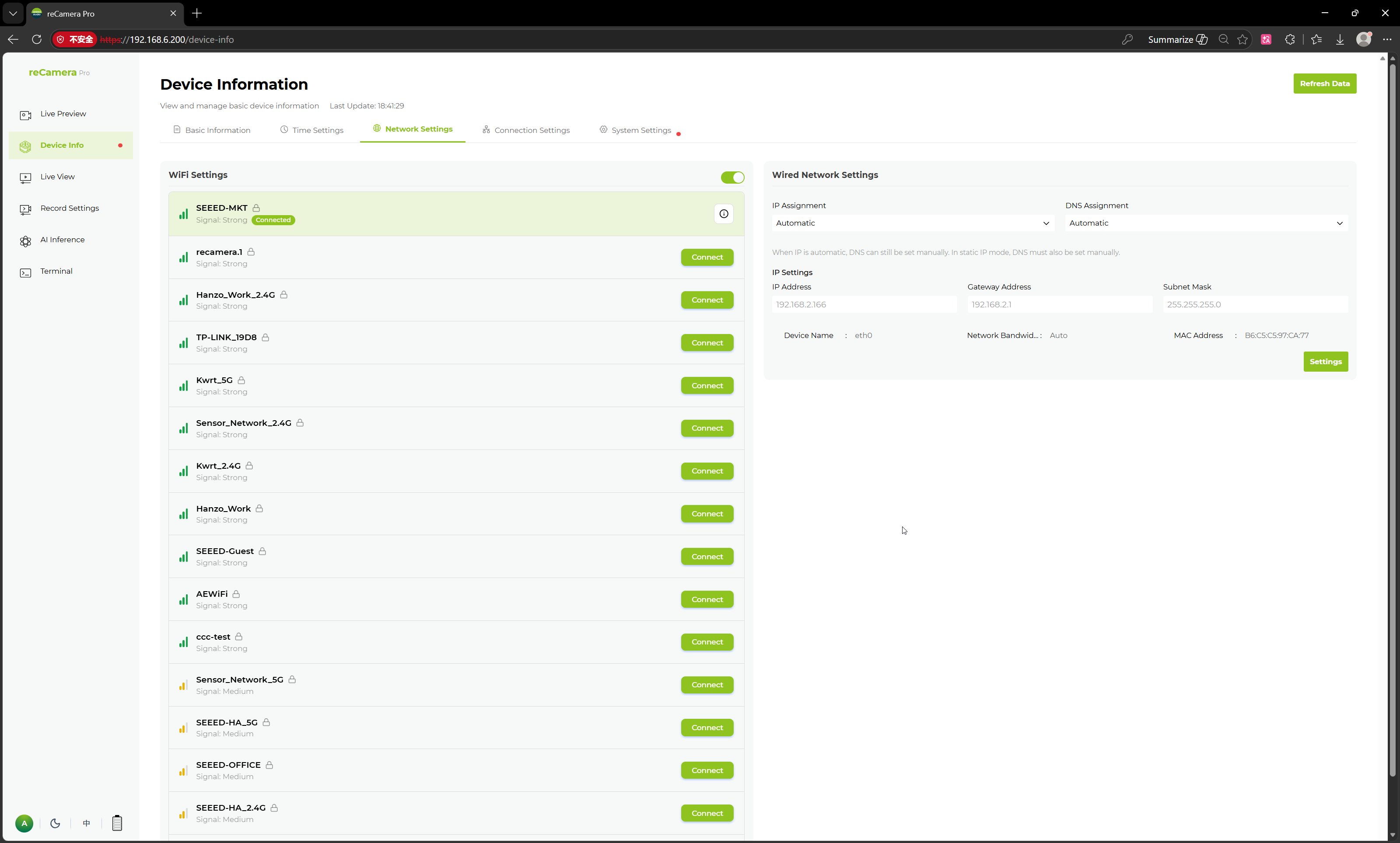

Device Info → Network Settings shows the Wi-Fi module state, connected network, and detailed network information (click the exclamation mark next to the connected network for IP/MAC details).
For a permanent installation:
  • Reserve a fixed IP for the device's MAC address on your router (DHCP reservation), or record the assigned address in your asset list.
  • Keep the device on a network segment where only intended clients can reach the Web UI and open services.

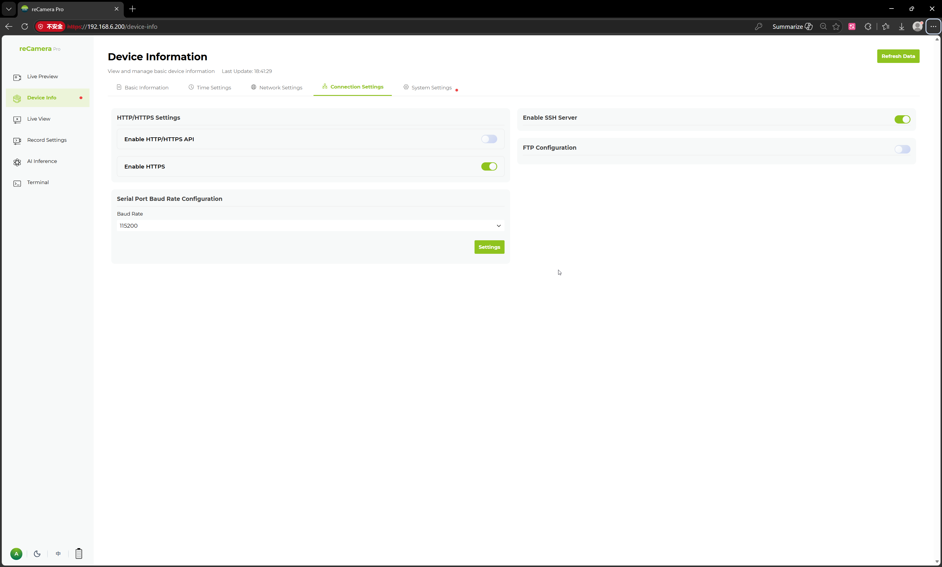

Device Info → Connection Settings controls how you connect to the device:
SettingEffectDeployment guidance
SSH remote connectionEnables/disables SSH access to the systemEnable for development and maintenance; disable on production devices you do not need shell access to
HTTP settingsConfigures the device's HTTP serviceRestrict exposure to trusted networks
Serial port baud rateSets the baud rate of the serial portMust match the external controller/MCU you integrate with
Access changes take effect immediately
Disabling SSH or changing HTTP settings can lock out your current remote session. Keep the Web UI (or the USB direct connection at 192.168.42.1) available as a fallback path while changing connection settings.

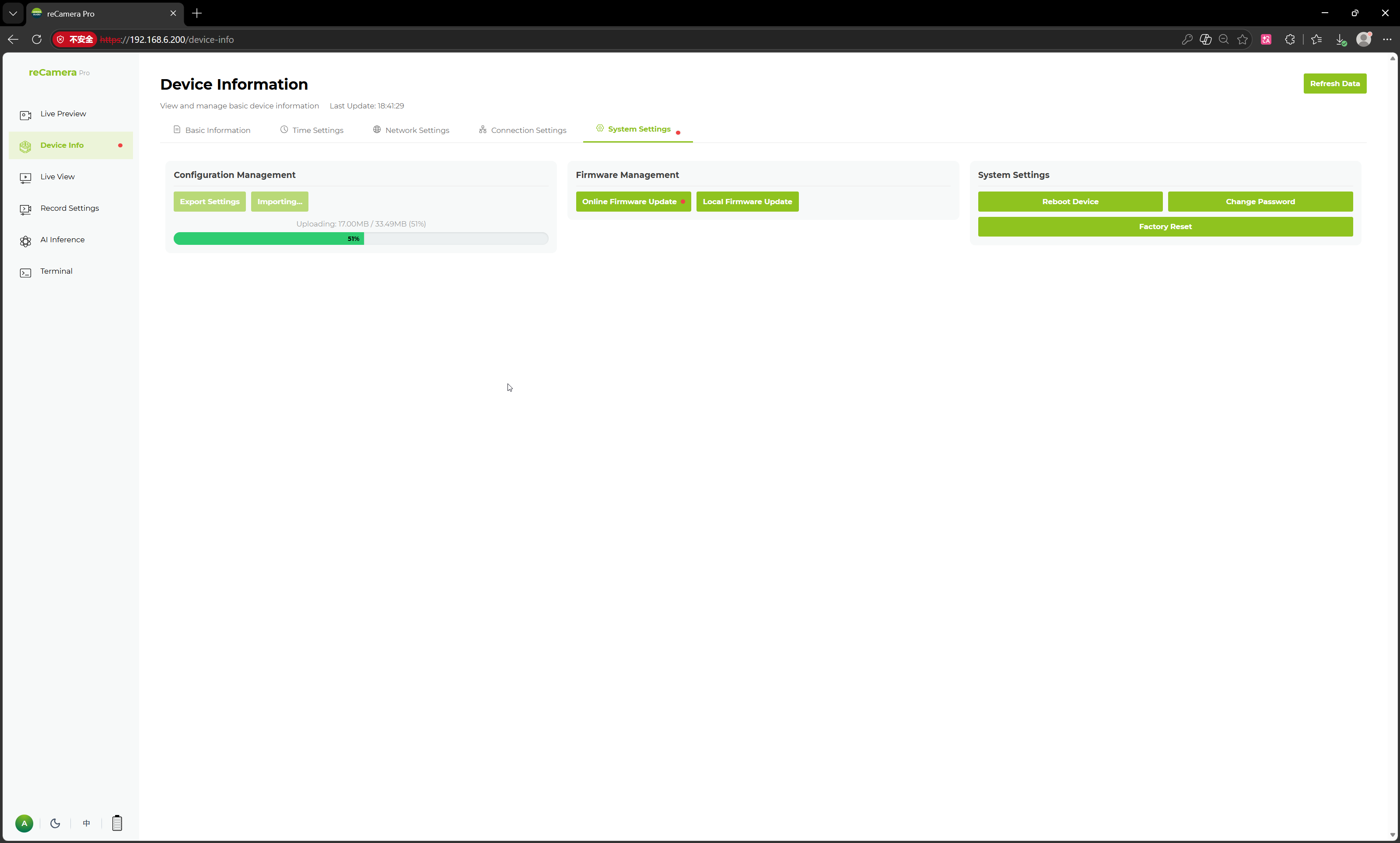

The admin password is changed in Device Info → System Settings. The Web UI login uses username admin; the initial password on a fresh device is recamera (you are asked to set a new one at first login).
  • Change the default password before deployment — anyone knowing the default can otherwise reach the Web UI, and the web terminal / SSH root login (root / recamera by default) share the device's credential state.
  • Changing the password affects Web UI login; record where the new password is stored.

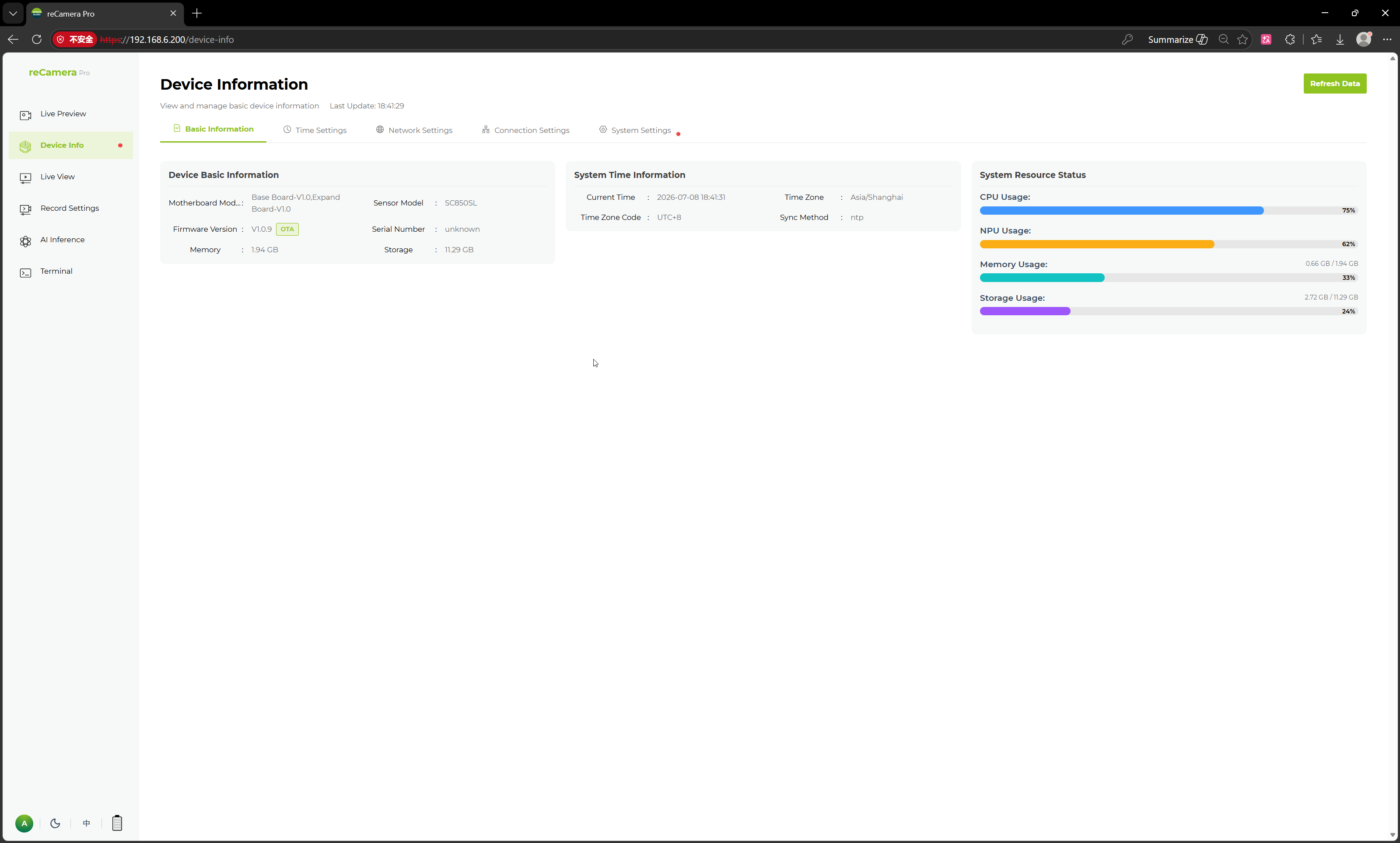

Device Info → Basic Information shows hardware and software versions and live system resource usage — the first thing support will ask for.
Quote the firmware version from this page when updating firmware or collecting logs for support.
