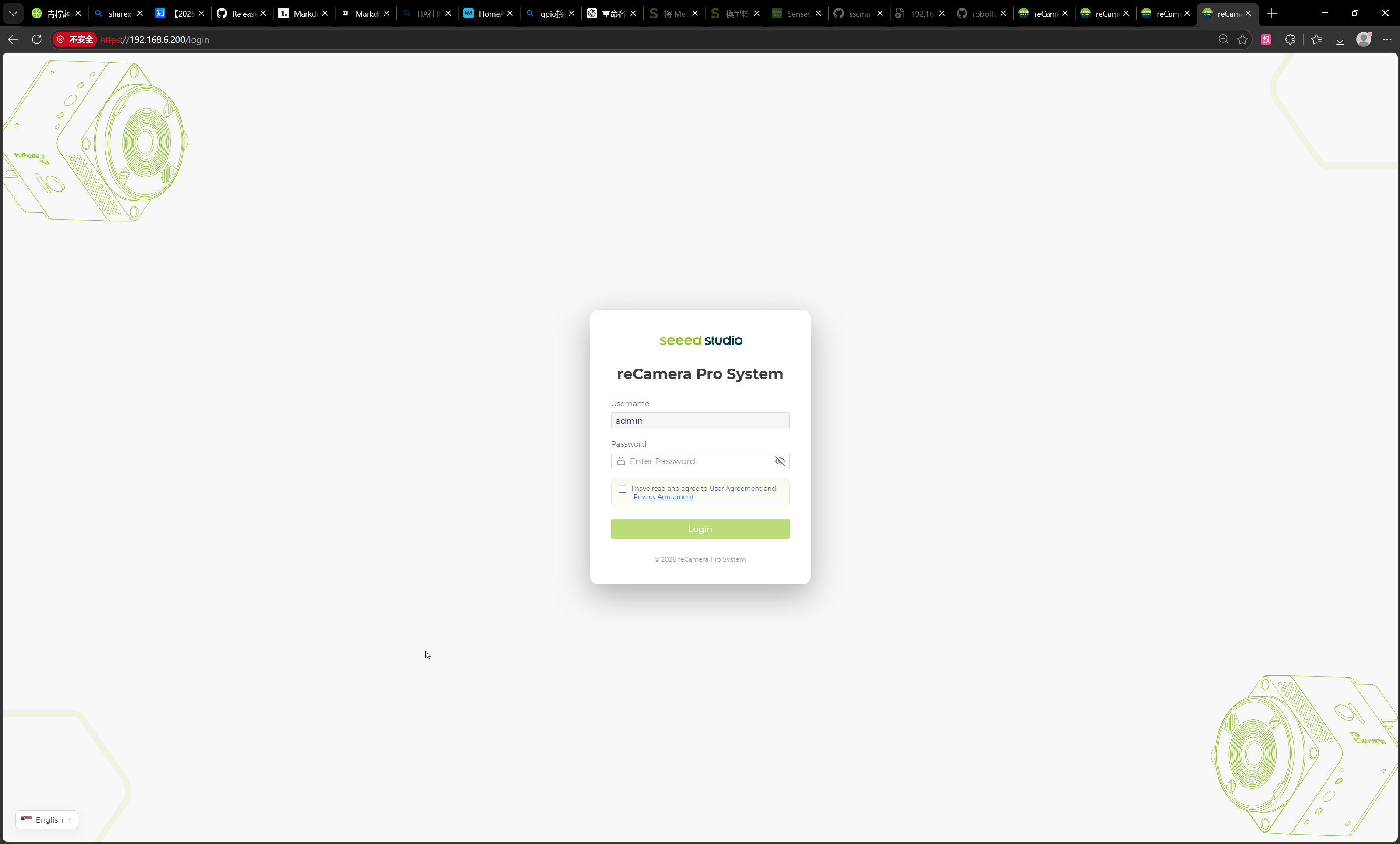

reCamera Pro has a built-in Web UI, so you never need to install extra client software. As long as your computer is on the same local network as the device, open a browser and go to:
http://<reCamera_IP>

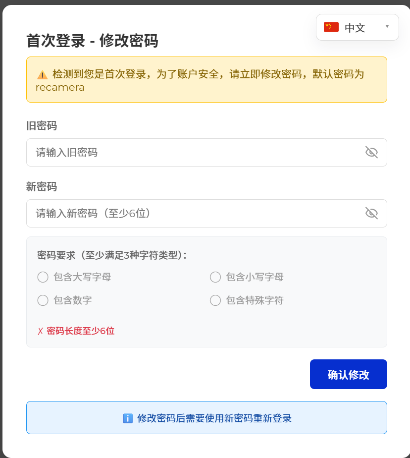

On first login the Web UI asks you to change the password. The initial password (old password) is recamera; enter a new password of your choice, then log in with the username admin.

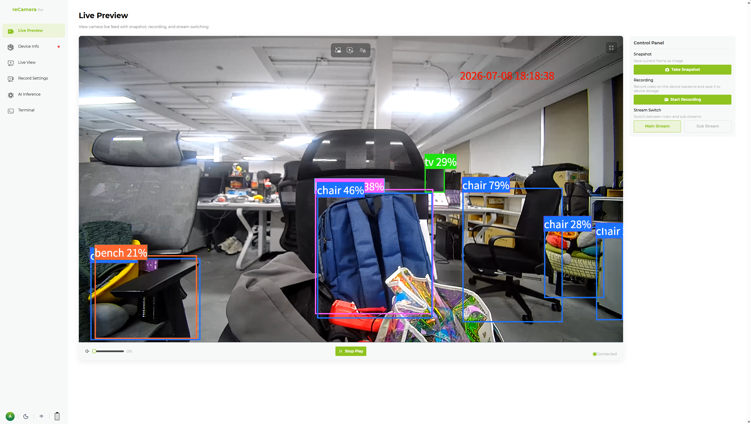

Watch the live preview
On the live view page, the left side is the video preview area and the right side is the function configuration area. Click Start Playback to watch the current camera feed in your browser.
The bottom of the preview area provides basic playback controls:
- Main Stream / Sub-Stream selection
- Start Playback / Stop Playback
- Volume adjustment
- Current connection status display

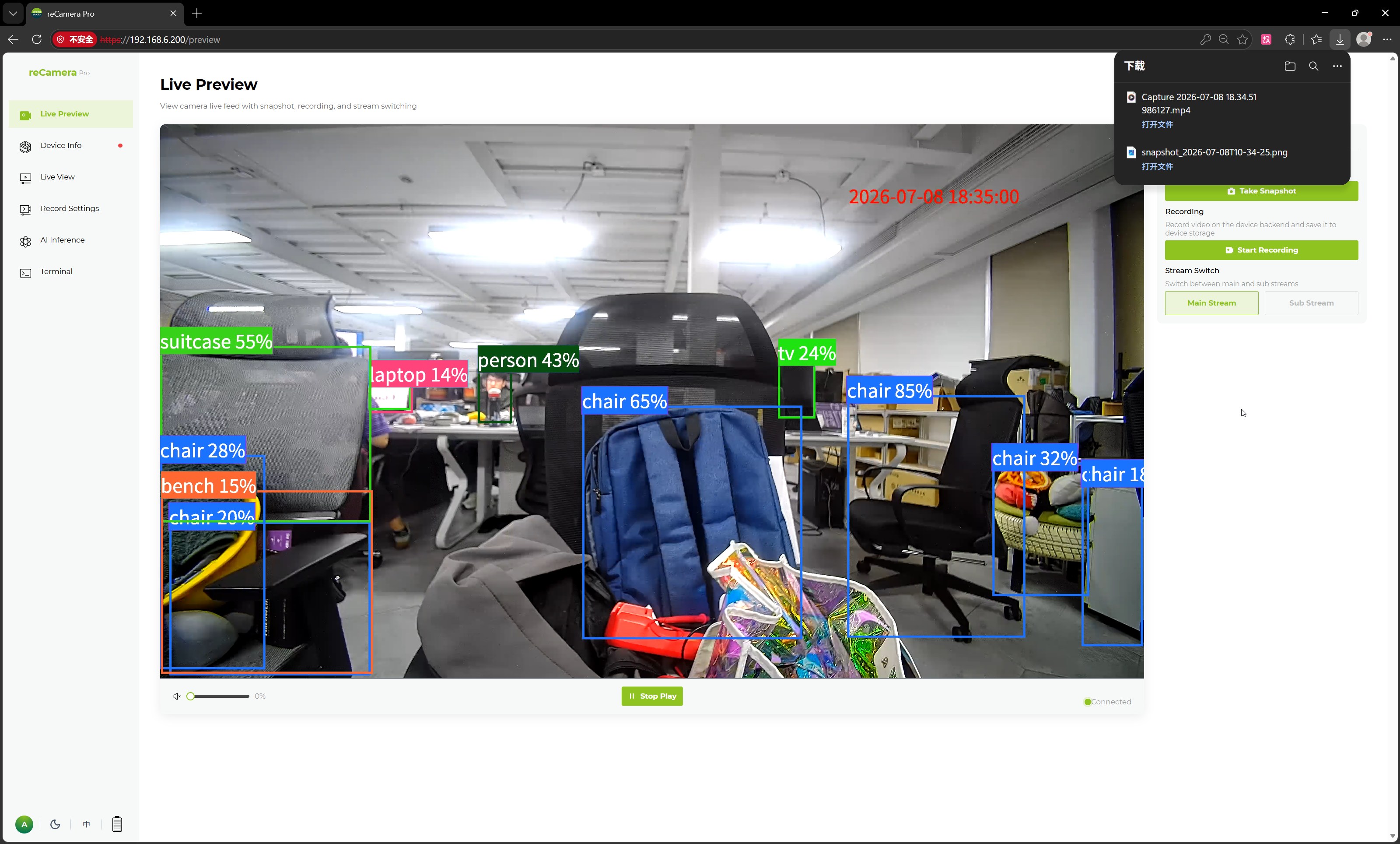

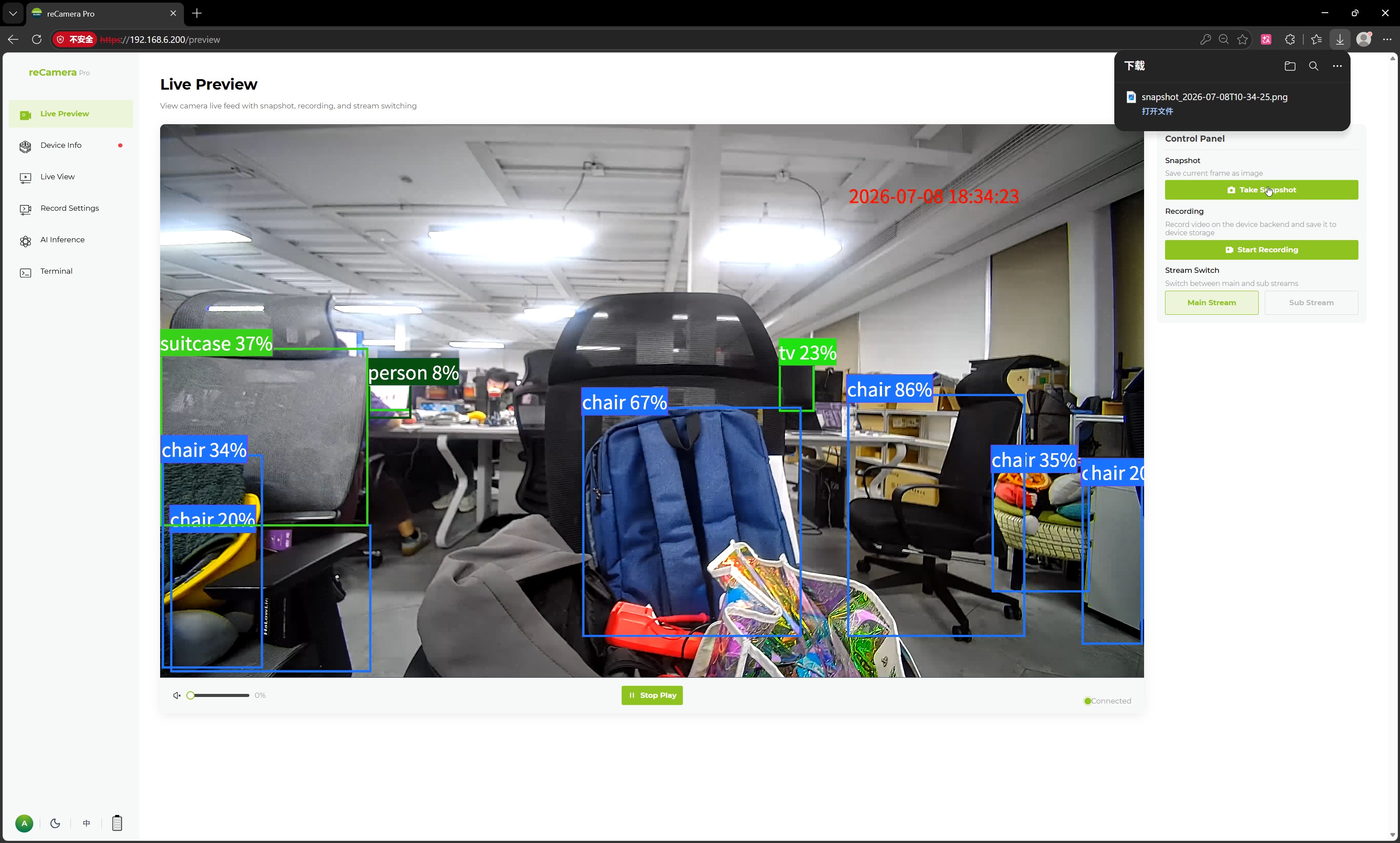

Take a photo
Take Photo saves the current frame as an image — useful for scene records, debugging archives, or data collection. The image is automatically downloaded to your browser's default download folder.

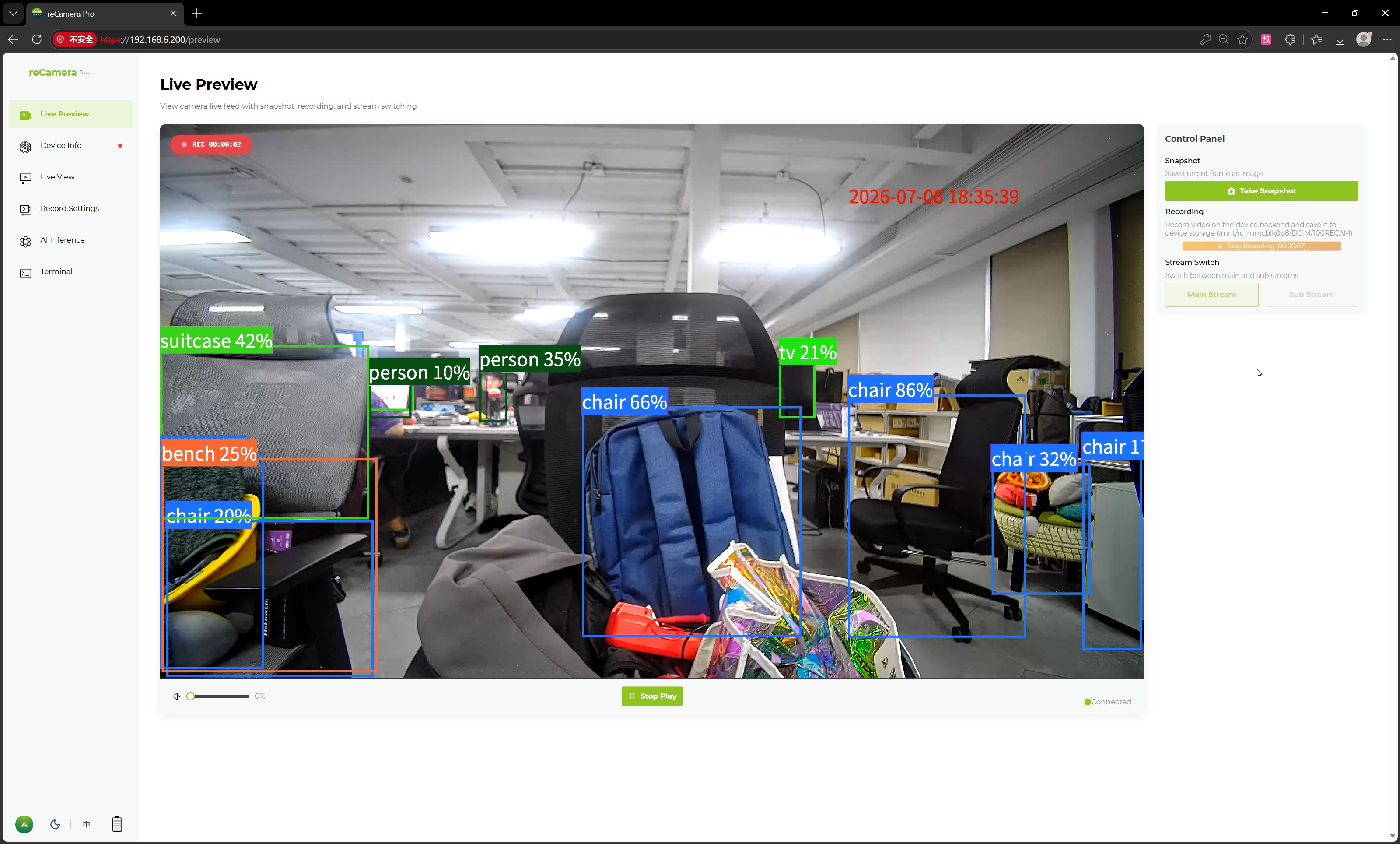

Record a video manually
You can start and stop recording directly from the Web UI.
- Click Start Recording. The button changes to End Recording.
- When you are done, click End Recording and wait a moment while reCamera Pro packages the video.
- The browser automatically downloads the recording as an MP4 file to your default download folder.
Manual recording from the preview page is different from AI/event-based recording. To record automatically when detections, sounds, or external triggers occur — and to keep recordings on the device's storage — see Configure Event Recording and Find Recordings and Storage.
