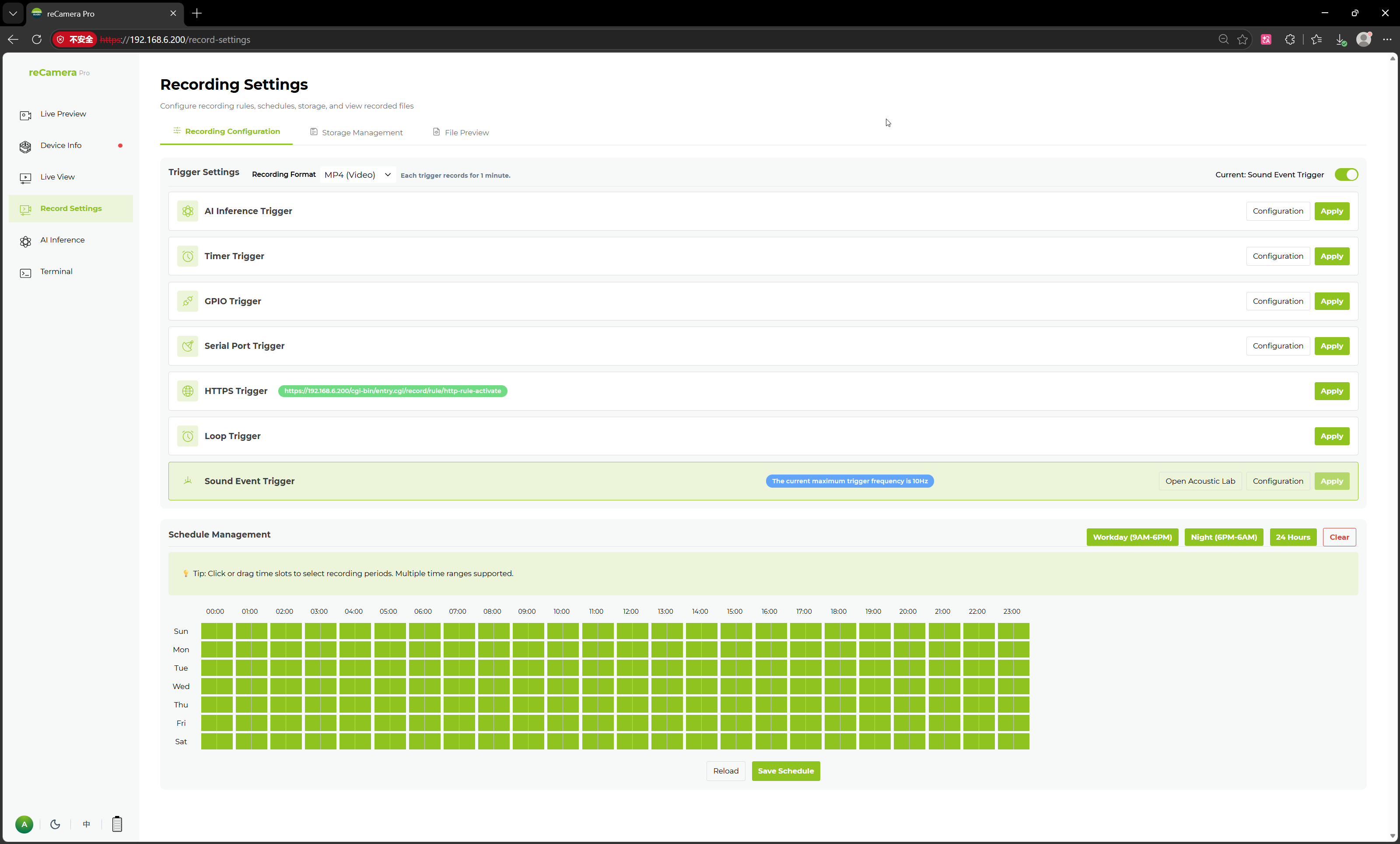

reCamera Pro supports rule-triggered video recording. In the Web UI, click Recording Settings in the left menu, then Recording Configuration.
The page has four modules:
- Recording Configuration — trigger rules, video format, recording schedule

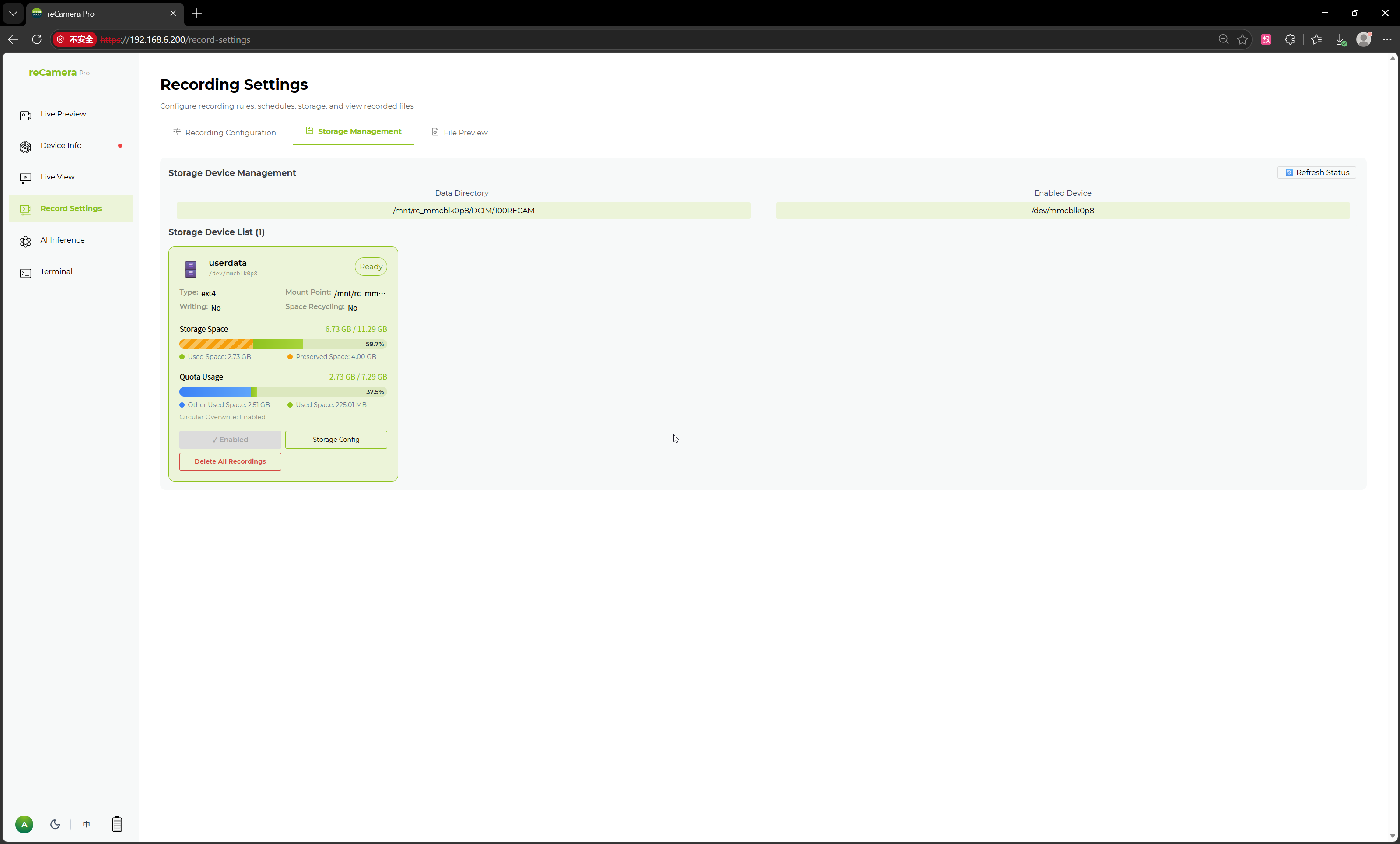

- Storage Management — device storage space

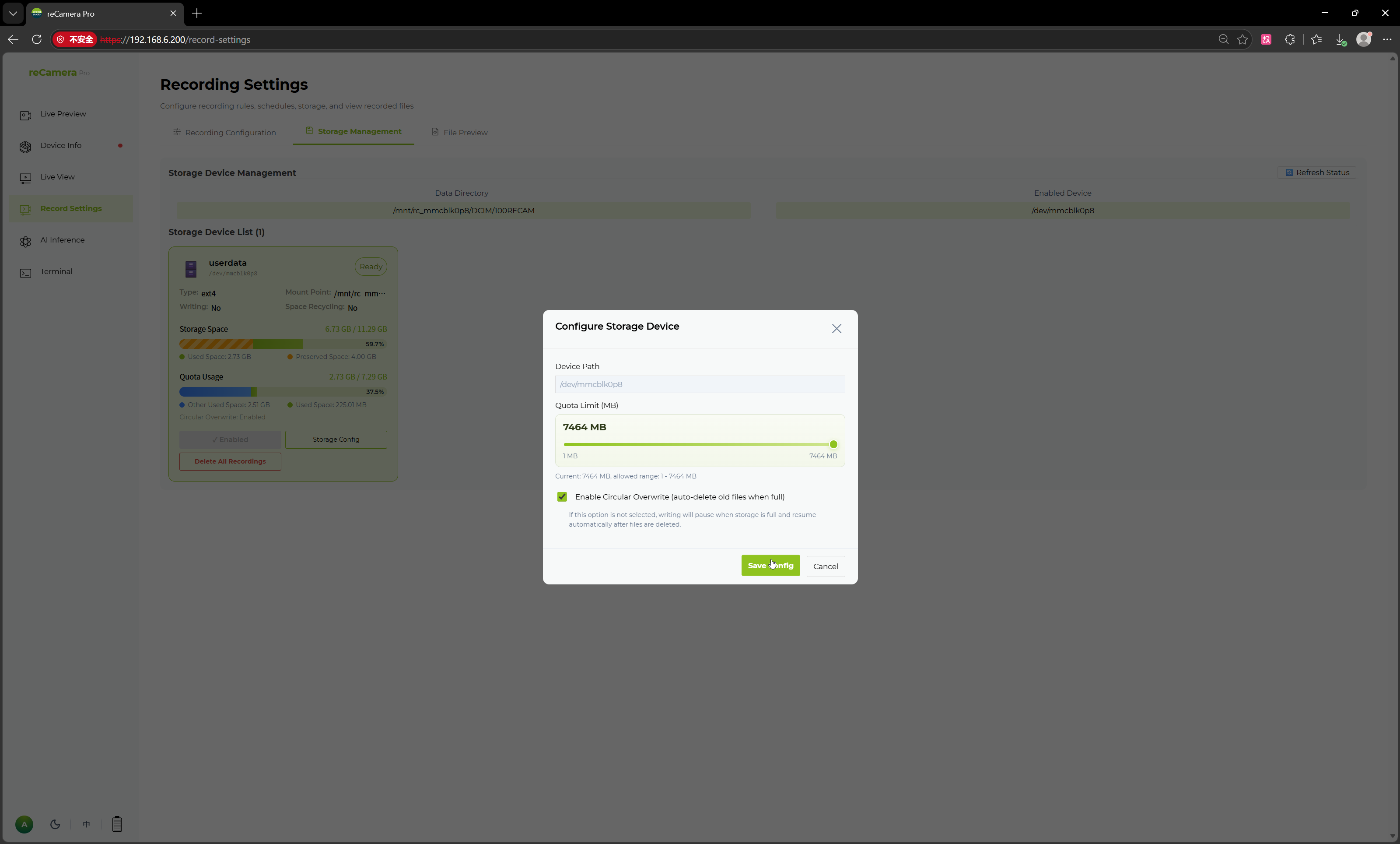

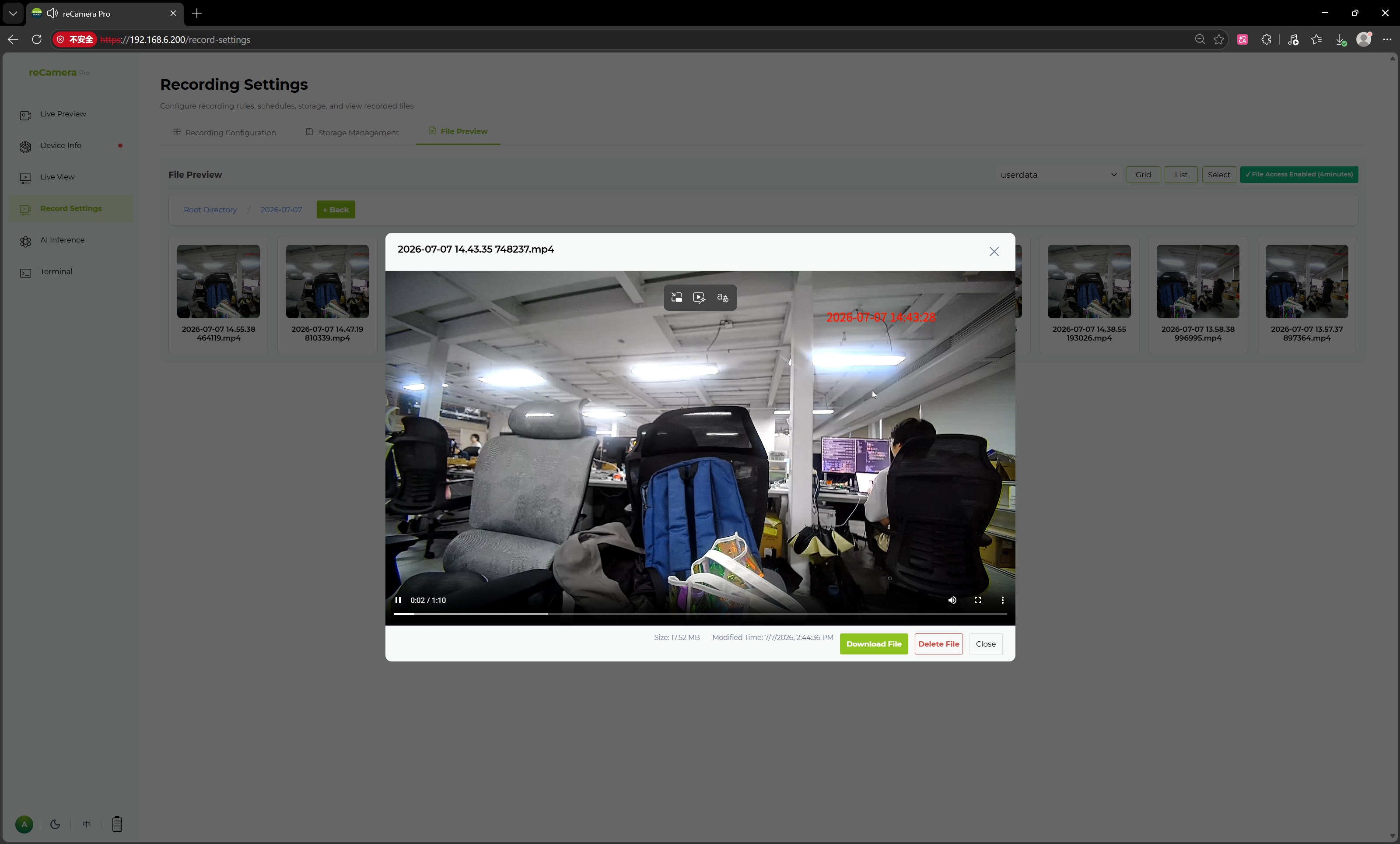

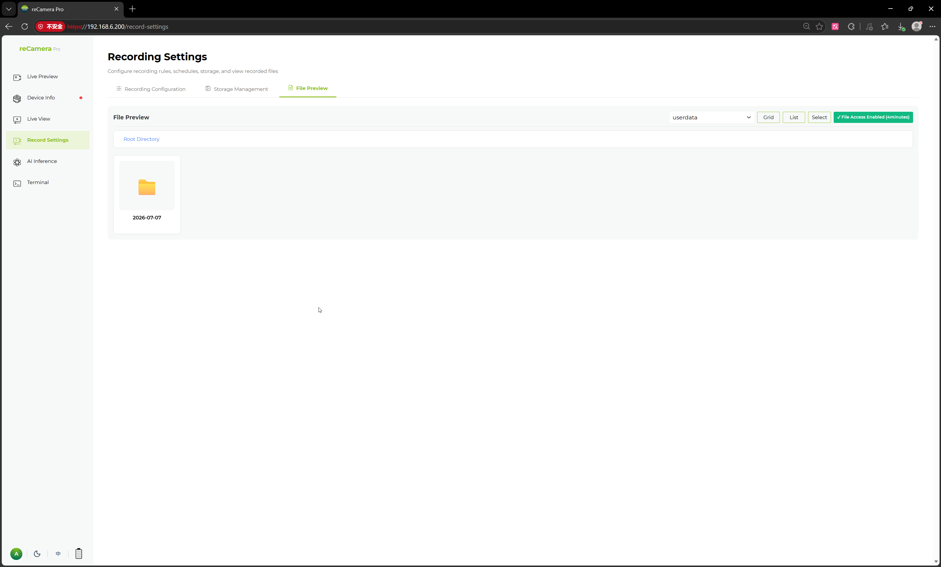

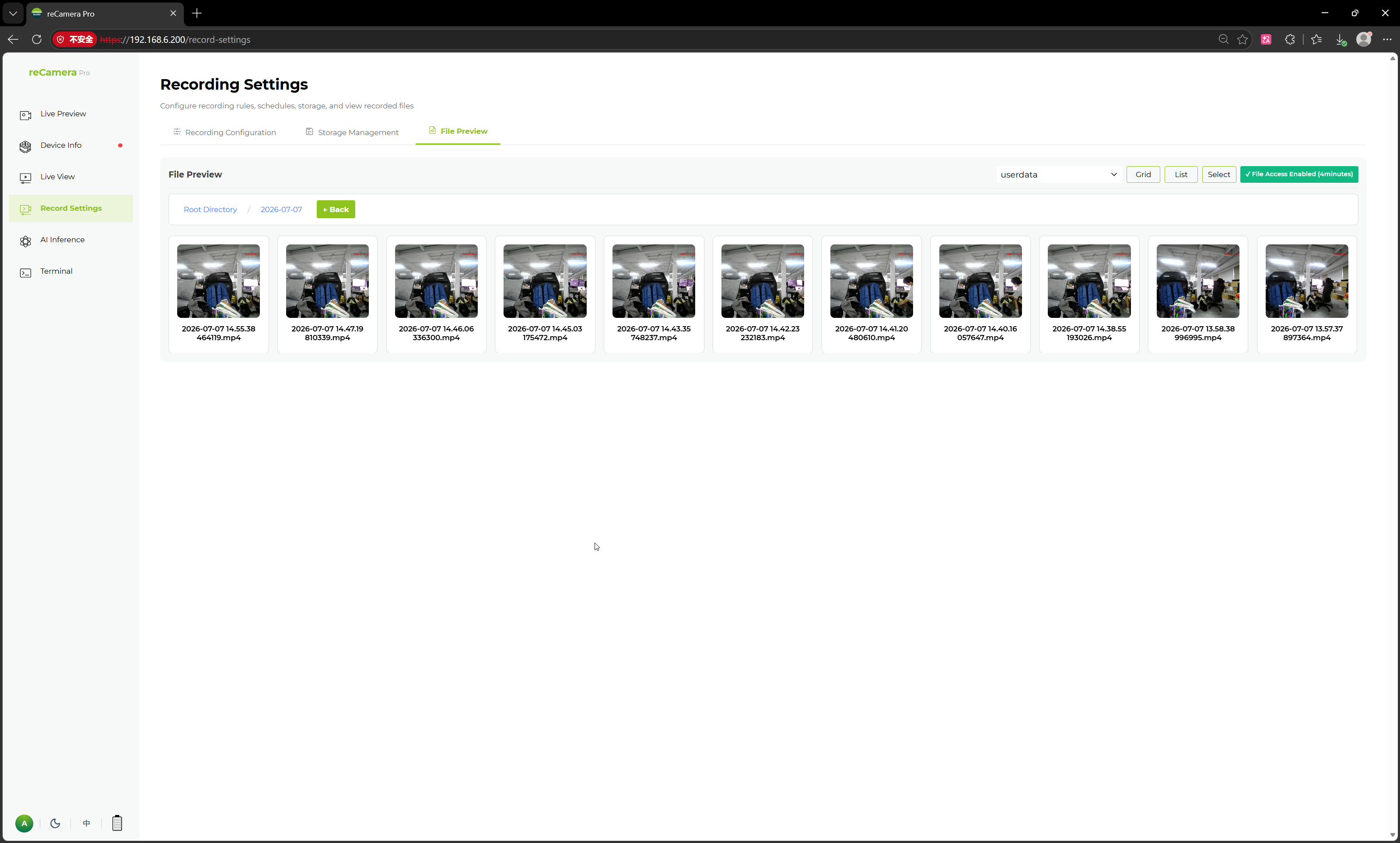

- File Preview — recorded video files

Trigger methods
On the recording configuration page, each trigger method has Configure and Apply buttons. Click Configure to set parameters, then Apply to enable it. The status at the top shows the currently active trigger method, e.g. "Current: Sound Event Trigger".

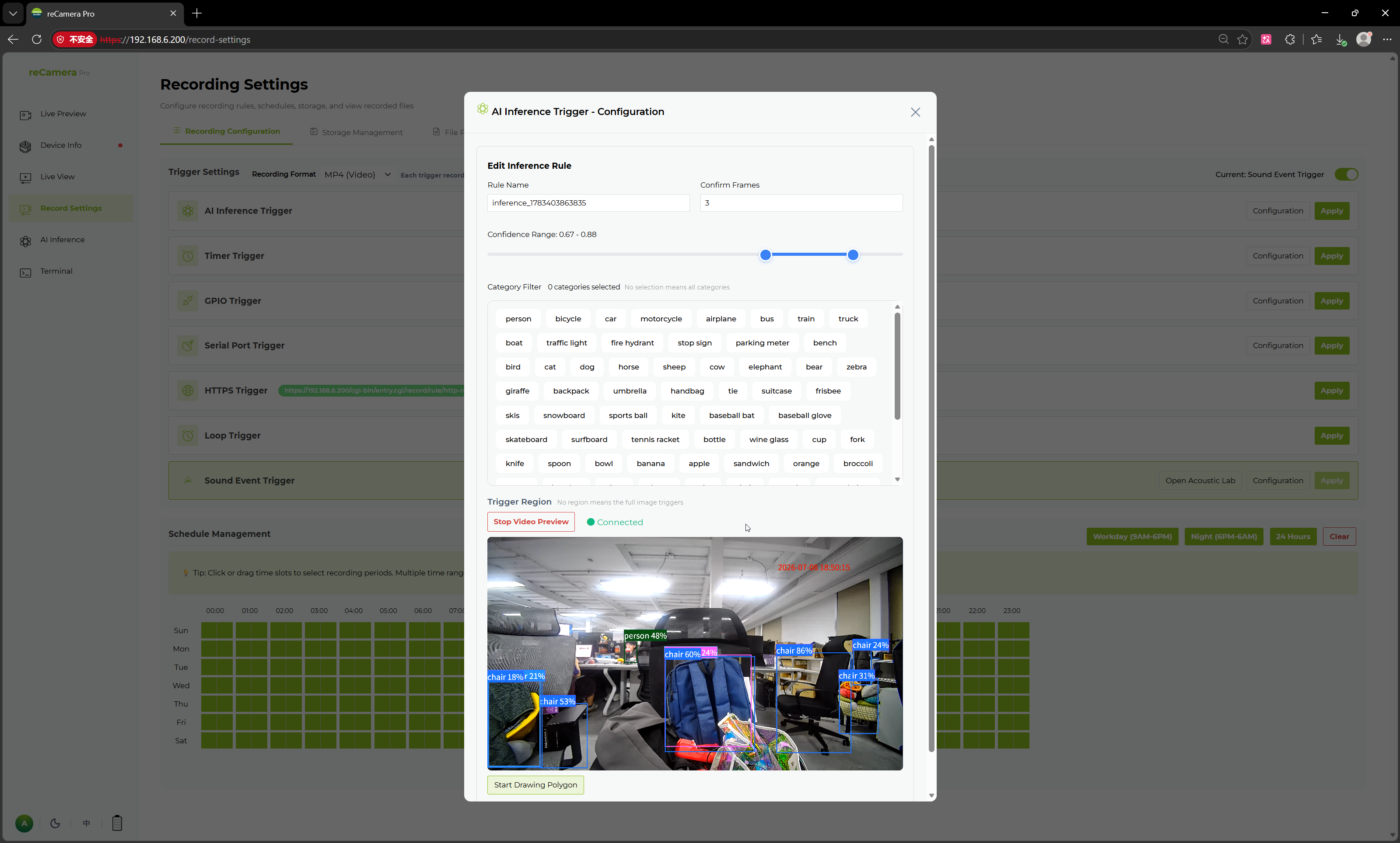

AI Inference Trigger
Automatically triggers recording when AI model recognition results match your conditions.
| Configuration Item | Description |
| Inference Task | Select the AI inference task to trigger recording |
| Confidence Range | Confidence threshold range for AI recognition results |
| Category Filter | Target categories to trigger recording (e.g. Person, Vehicle, Hardhat) |
| Trigger Area | Polygonal screen region for triggering; defaults to the entire frame |

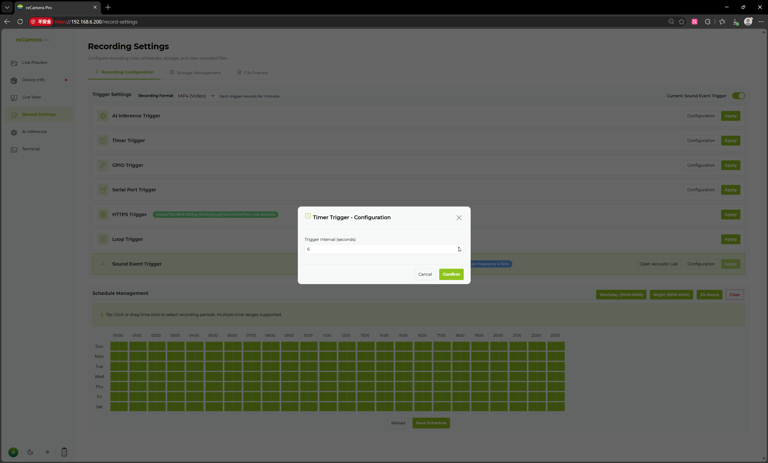

Scheduled Trigger
Triggers recording at fixed time intervals.
| Trigger Interval | Time interval in seconds |
Scheduled Trigger fires recording at a fixed interval. Schedule Management (below) controls when any trigger is allowed to fire. They are independent features.

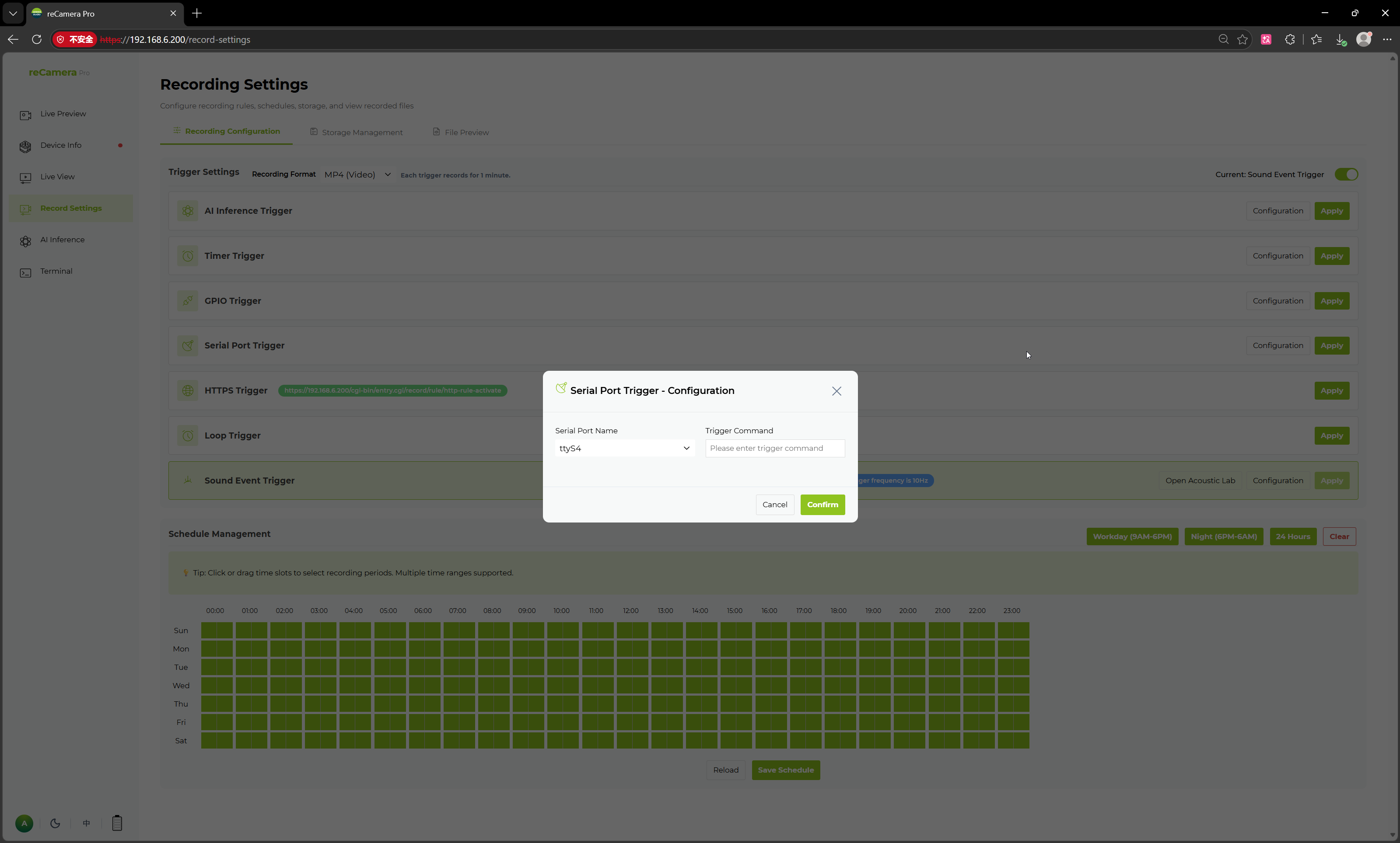

Serial Trigger
Triggers recording via serial commands.
| Serial Port Name | Serial port to listen on, e.g. ttyS4 |
| Trigger Command | Serial command to trigger recording |
Suitable for integration with external controllers, MCUs, or industrial equipment.

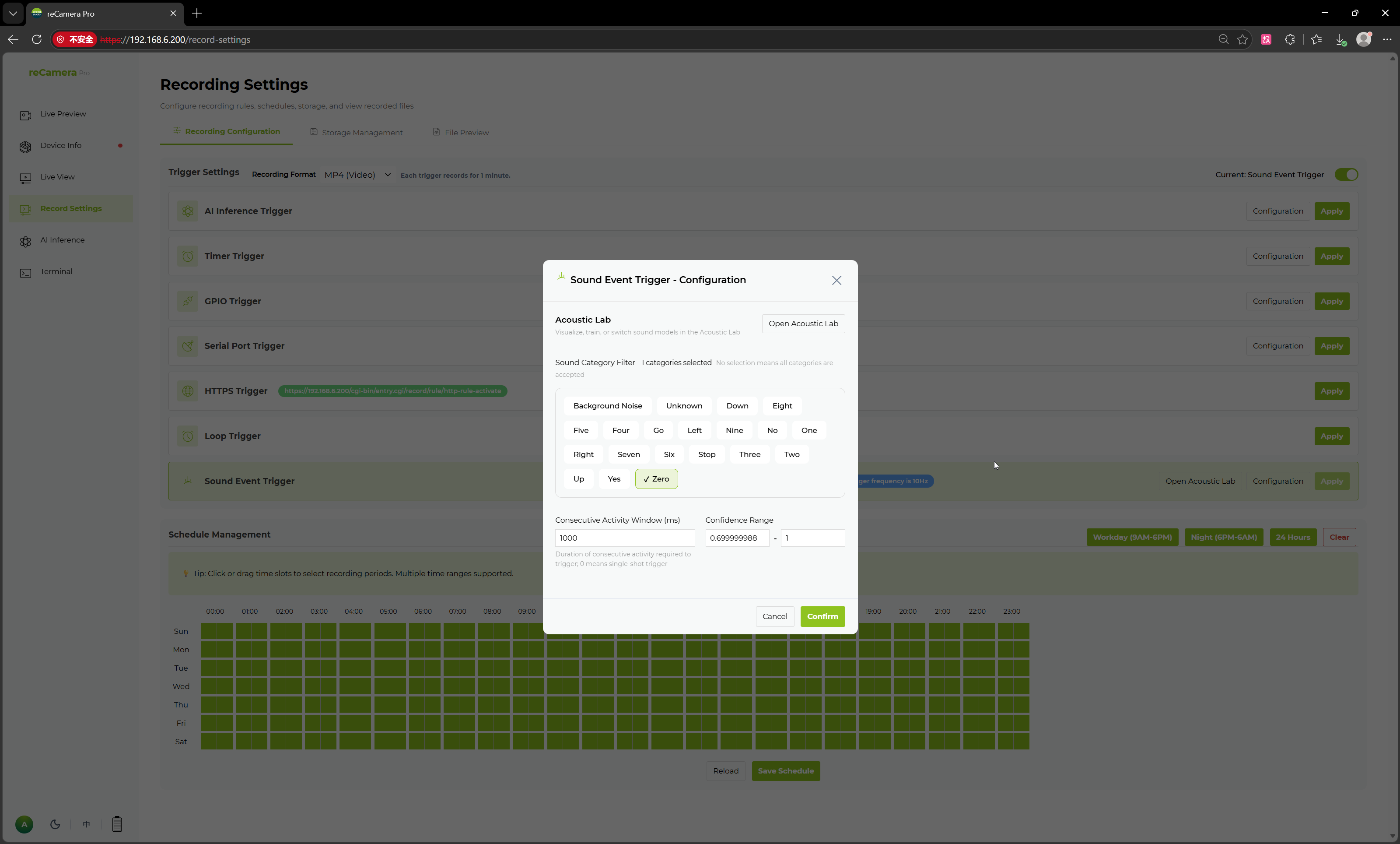

Sound Event Trigger
Triggers recording based on audio events recognized by the sound model.
| Sound Category Filter | Sound categories to trigger recording |
| Continuous Activity Window | Duration of continuous activity required (ms) |
| Confidence Range | Confidence threshold for sound recognition |
To train custom sound models, see Train a Sound Model.
Schedule Management
Set the effective time periods for recording rules using a weekly timetable (day × hour grid). Click or drag cells to select periods.
| Shortcut | Description |
| Weekdays (9 AM – 6 PM) | Daytime working hours |
| Night (6 PM – 6 AM) | Nighttime recording |
| All Day (24 Hours) | All-day recording |
| Clear | Clear selected periods |
