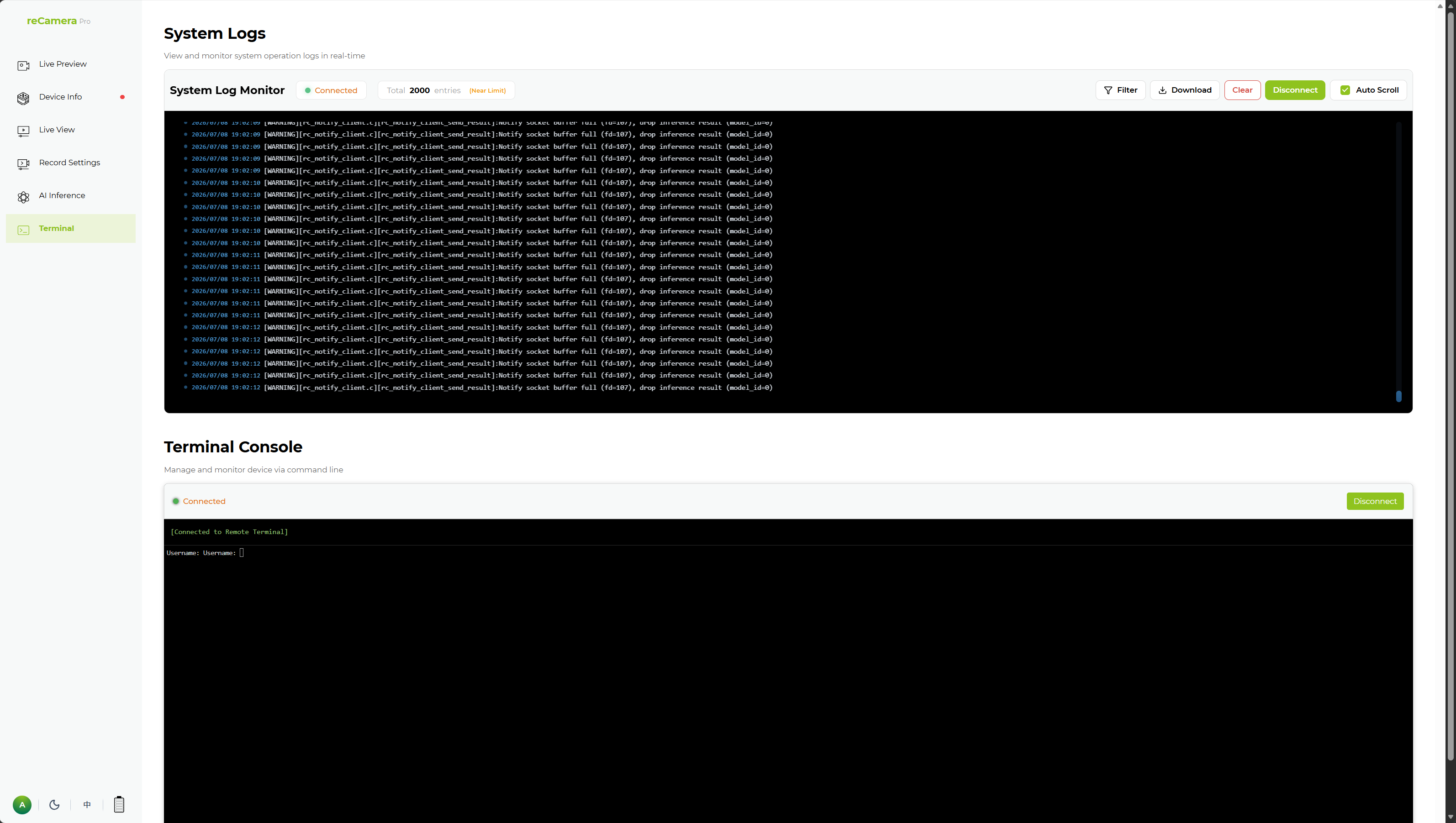

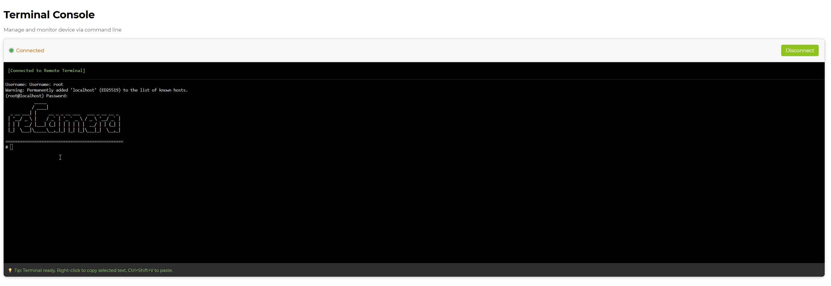

WebUI Terminal Console​
The terminal console lets you log in directly to the reCamera Pro system terminal from the Web UI, without an additional SSH tool.
Log in with the following default account:
Username: root
Password: recamera
The same Web UI page also provides a system log view for real-time log inspection, filtering, and download — see Collect Logs.
