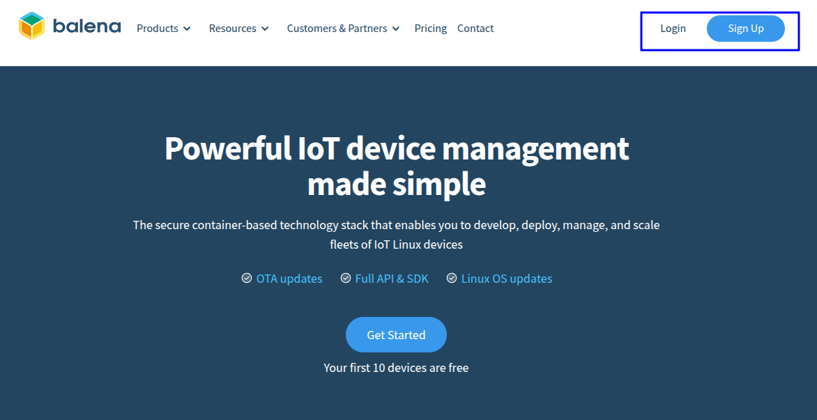

Software​
  • A balenaCloud account (sign up here) and get the first 10 devices free.

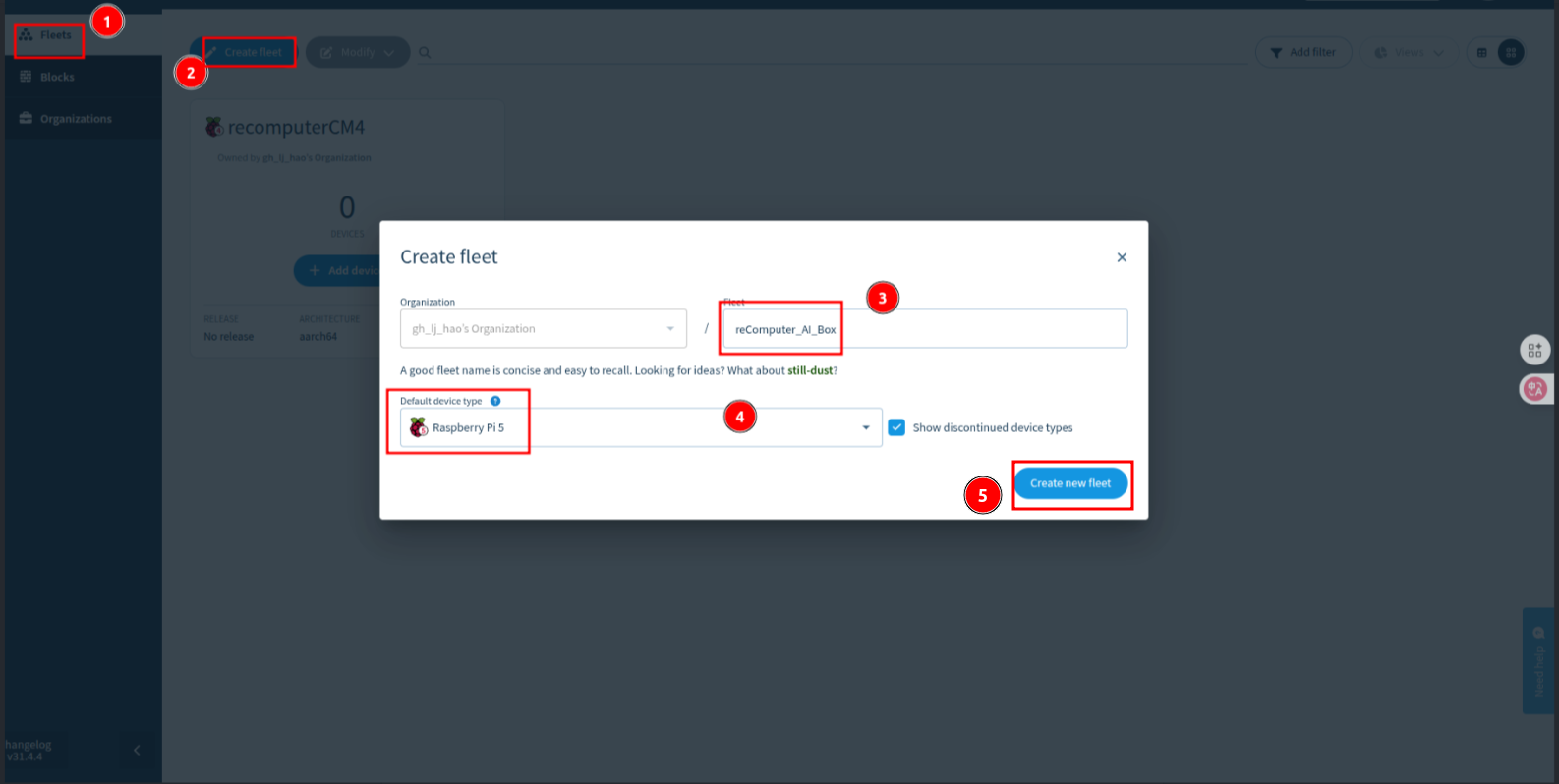

Creat fleet on balena cloud​
Please refer to the process in the image below to create the fleet:

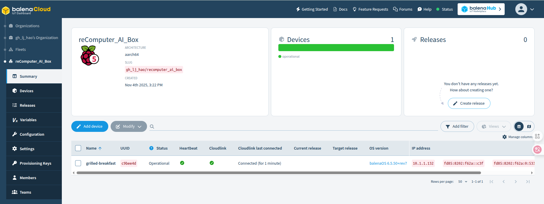

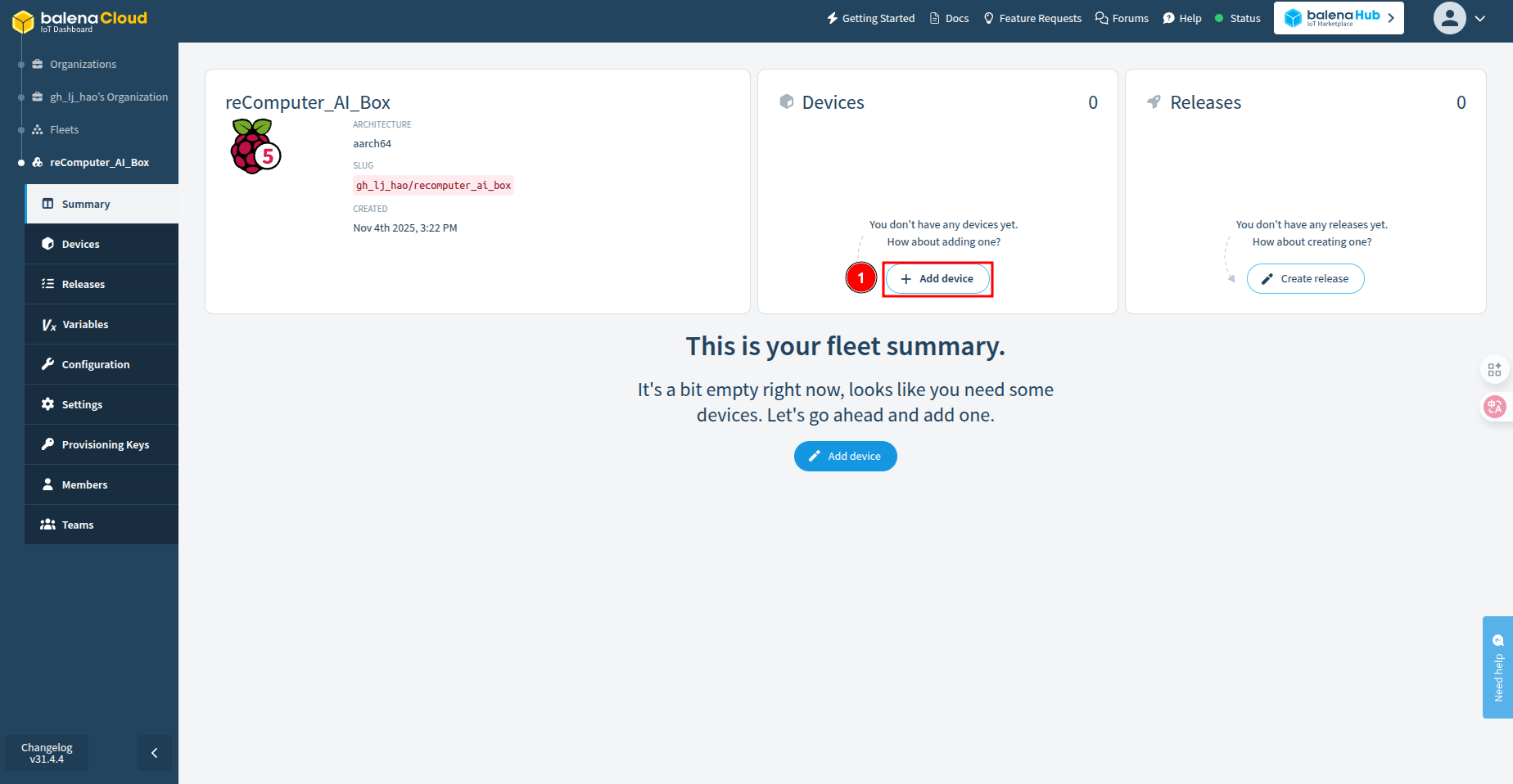

Add device​
Please refer to the process in the image below to add new reComputer AI R2140:
pir

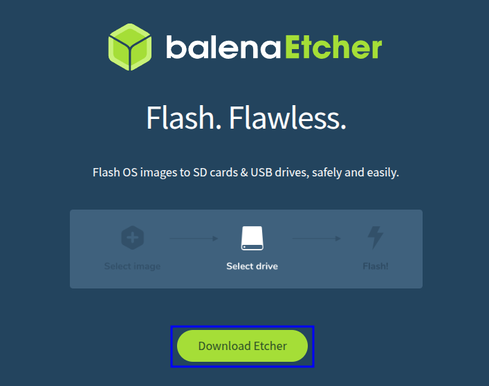

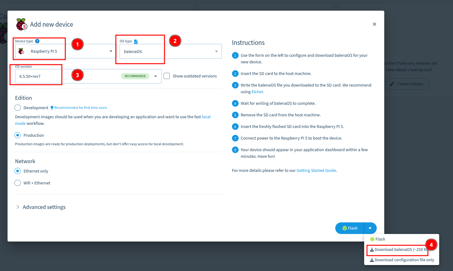

Install balena OS​
Please refer to the process in the image below to install balena OS:
pir

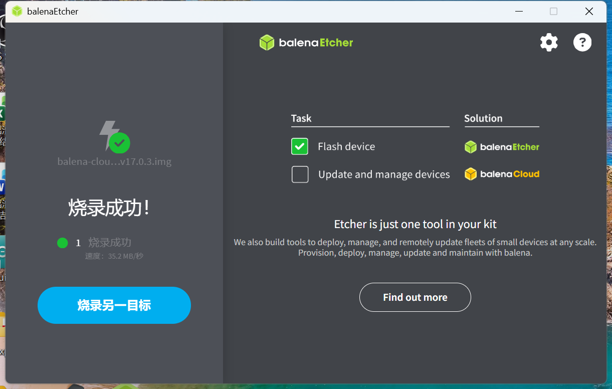

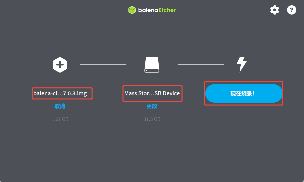

Flash balena OS​
Please refer to the process in the image below to flash balena OS to SD card:
pir
The image below shows what it looks like after the flashing is complete:

Test device​
Insert the flashed SD card into the recomputer AI box, then power it on and connect the Ethernet cable. After 2 minutes, you should be able to see the new device in Balena Cloud.

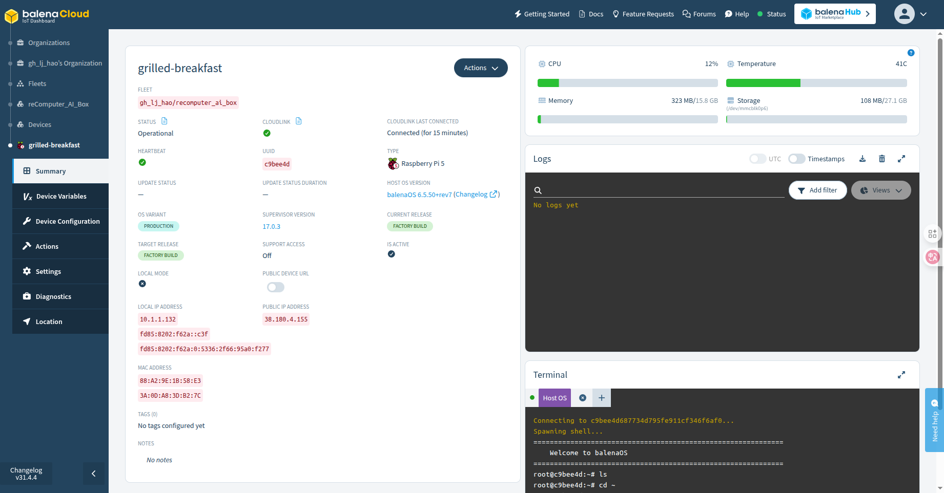

pir
When you click on the device, you'll enter the screen shown in the image below, which means you can remotely control the device.
