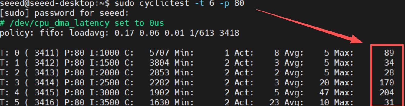

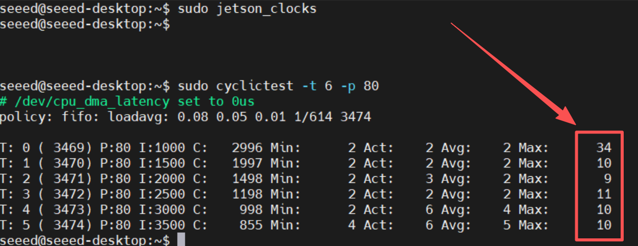

Run Cyclictest​
# Run cyclictest with 6 threads and priority 80
sudo cyclictest -t 6 -p 80
Before enable the jetson_clocks,you can observe that the latency of some threads is relatively high.So,we need to enable the jetson_clocks by fllowing command:
sudo jetson_clocks
info
Real-time Performance Analysis:
  • Maximum latency: 34 microseconds
  • Average latency: 2-6 microseconds
  • All 6 test threads show stable latency within 9-34 microseconds range
  • System load: 0.00
  • Latency distribution is uniform and consistent
This performance meets the hard real-time application requirement of under 100 microseconds, making it suitable for robotics control and industrial automation applications.

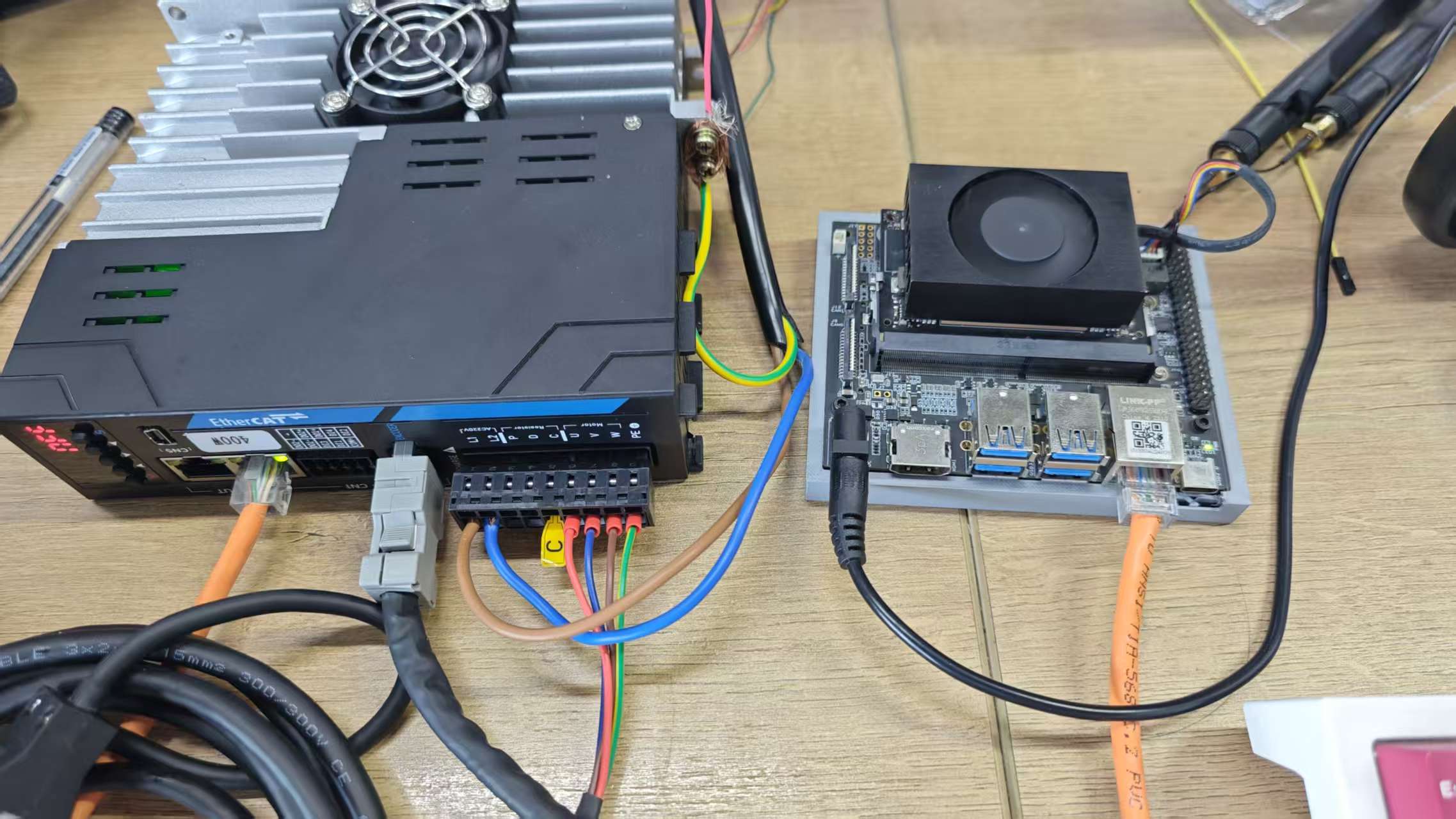

Hardware Connection​
Connect your EtherCAT network using the following setup:
  1. Use a standard Ethernet cable (Cat5e or higher recommended)
  2. Connect reComputer (Master) to EtherCAT Slave Device

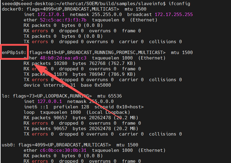

Step 1. Identify Network Interface:
# Check available network interfaces
ifconfig

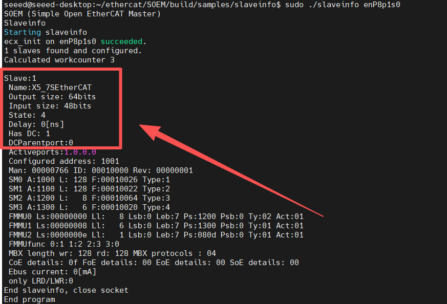

Step 2. Navigate to the slaveinfo sample and run the detection program:
# Navigate to slaveinfo sample
cd /path/to/SOEM/build/samples/slaveinfo
# Run slave detection (replace enP8p1s0 with your interface name)
sudo ./slaveinfo enP8p1s0
success
Verification Success: If you see "slave found" in the output, it confirms that:
  • SOEM software stack is working correctly
  • EtherCAT slave device is properly connected
  • Communication link is established

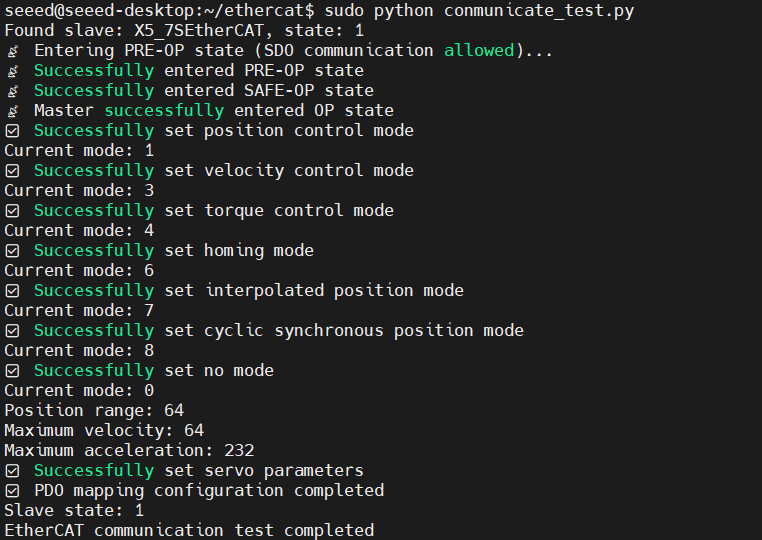

Create a simple C program to demonstrate basic EtherCAT communication:
ethercat_communication_test.c
#include <stdio.h>
#include <stdlib.h>

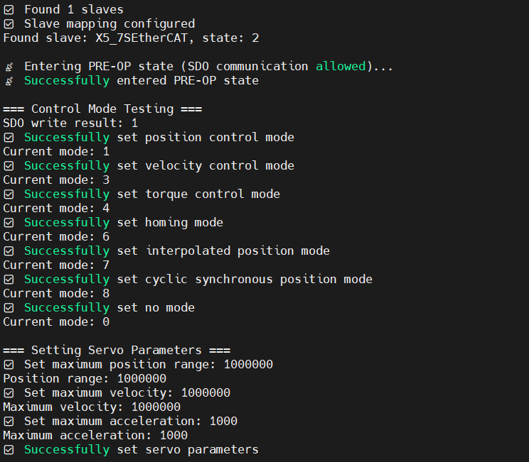

// Switch between different control modes
printf("\n=== Control Mode Testing ===\n");
set_control_mode(1); // Position control
set_control_mode(3); // Velocity control
set_control_mode(4); // Torque control
set_control_mode(6); // Homing
set_control_mode(7); // Interpolated position mode
set_control_mode(8); // Cyclic synchronous position mode
set_control_mode(0); // No mode
// Set servo parameters
printf("\n=== Setting Servo Parameters ===\n");
set_servo_parameters();

Compile and run the program:
make gcc -Wall -Wextra -std=c99 -O2 -I/home/seeed/ethercat/SOEM/build/install/include -c ethercat_simple_test.c -o ethercat_simple_test.o
sudo ./ethercat_simple_test
As shown above, successful EtherCat communication will modify the slave station's driving mode, and it will be able to normally read the status information of the slave station.

interface_name = "enP8p1s0"

Before running the Python script, you need to install the pysoem library:
pip3 install pysoem
# Run Python example with sudo
sudo python3 ethercat_python.py
