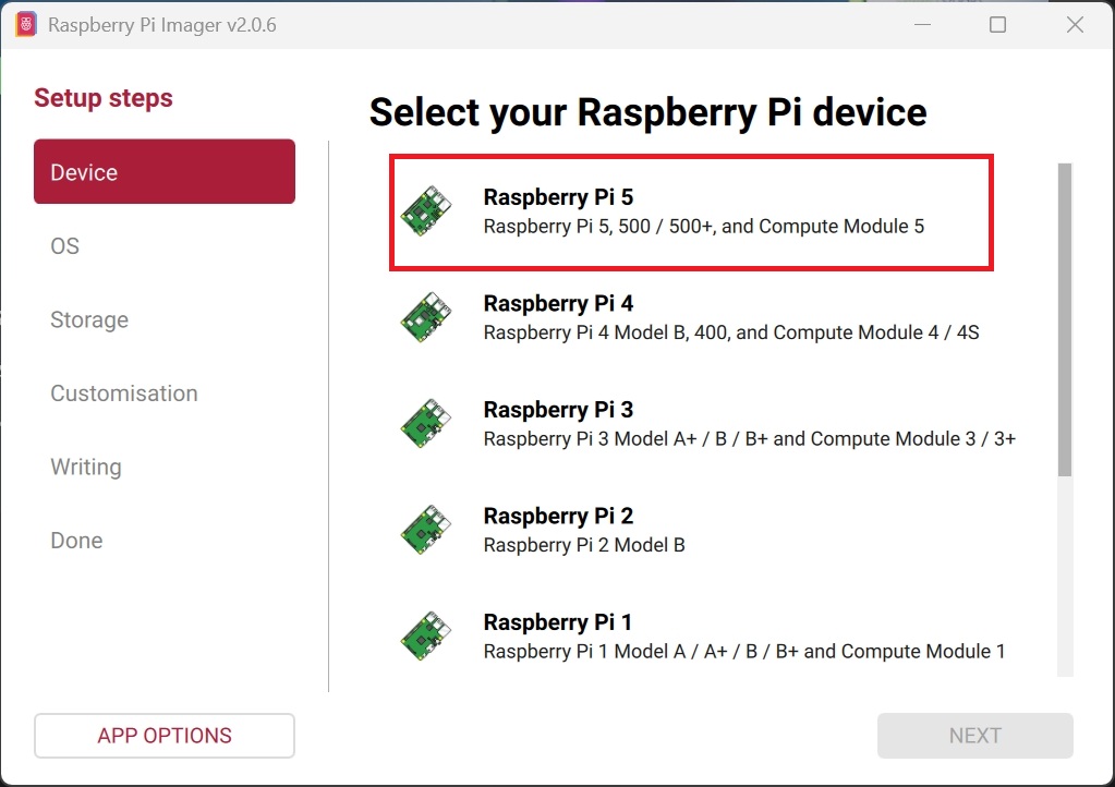

  • Step 3. Open Raspberry Pi Imager software,Under Device, choose "Raspberry Pi 5" , and click "Next"
pir

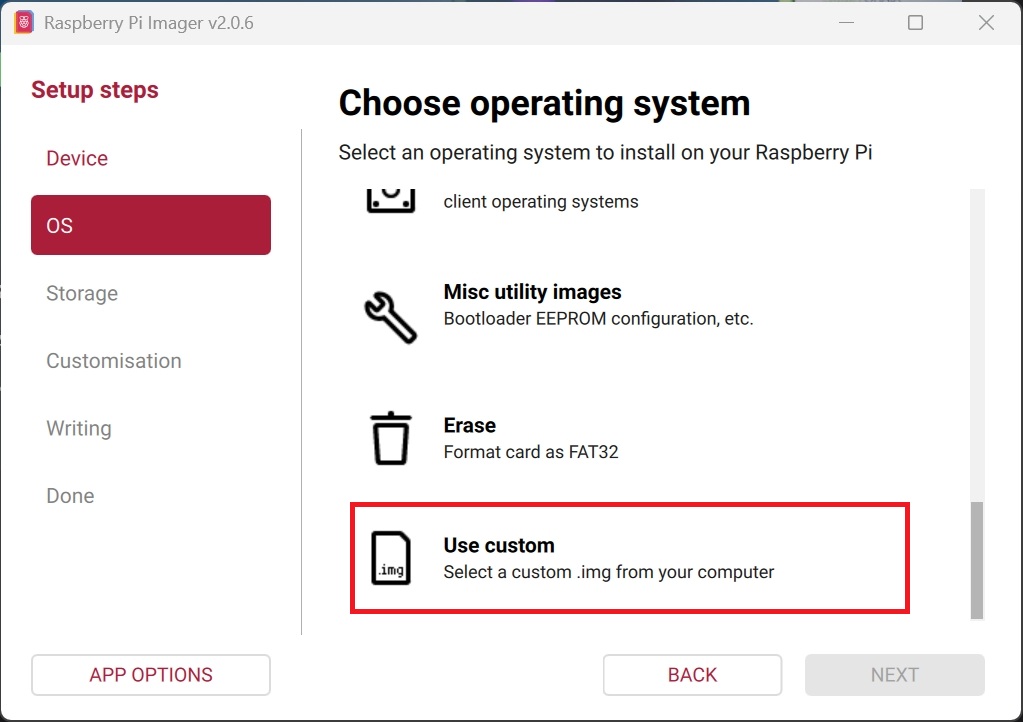

  • Step 4. Scroll down and click Use custom
pir
  • Step 5. then choose the previously downloaded mirror file.
