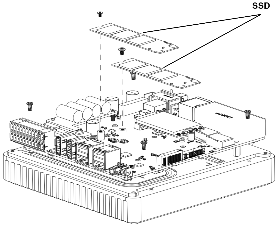

Installing an SSD​
Step 1: Remove the back cover following the disassembly guide.
Step 2: Load the SSD into the M.2 socket and lock the screws.

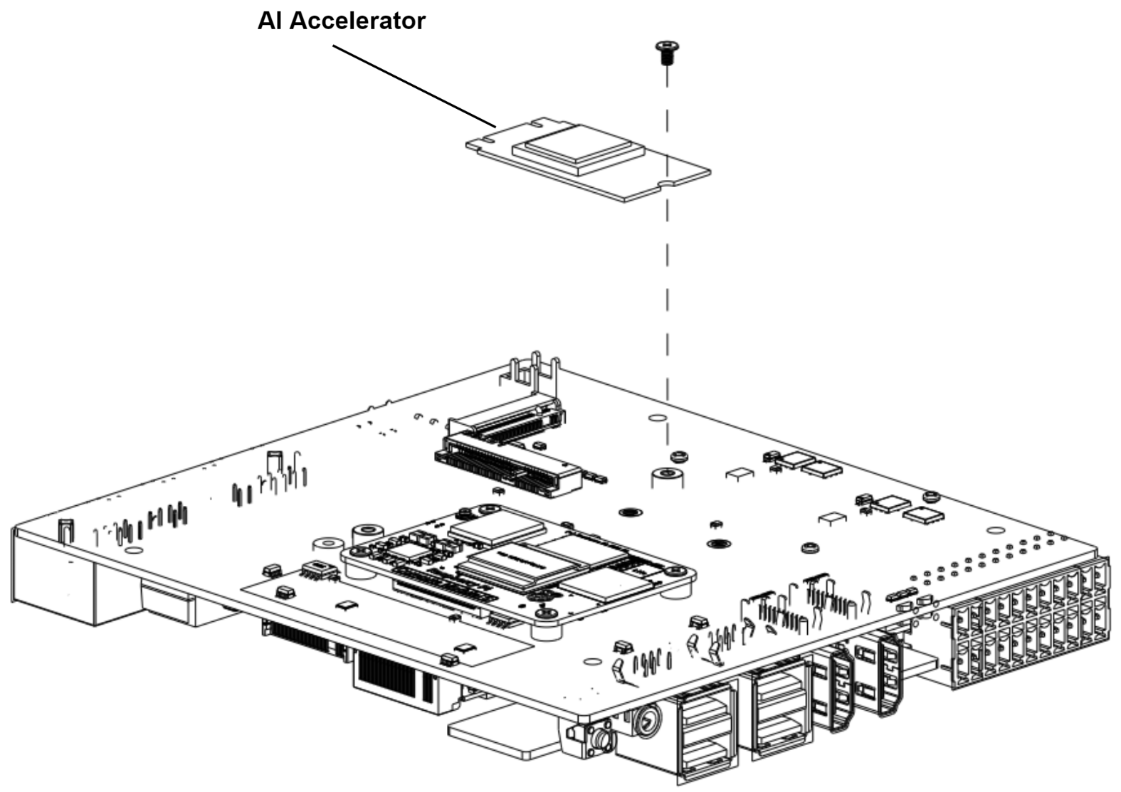

Assemble M.2 AI Accelerator​
Step 1: Disassemble the entire device following section 4.1 "Disassembly Guide". Step 2: Load the AI Accelerator into the M.2 socket and lock the screws.

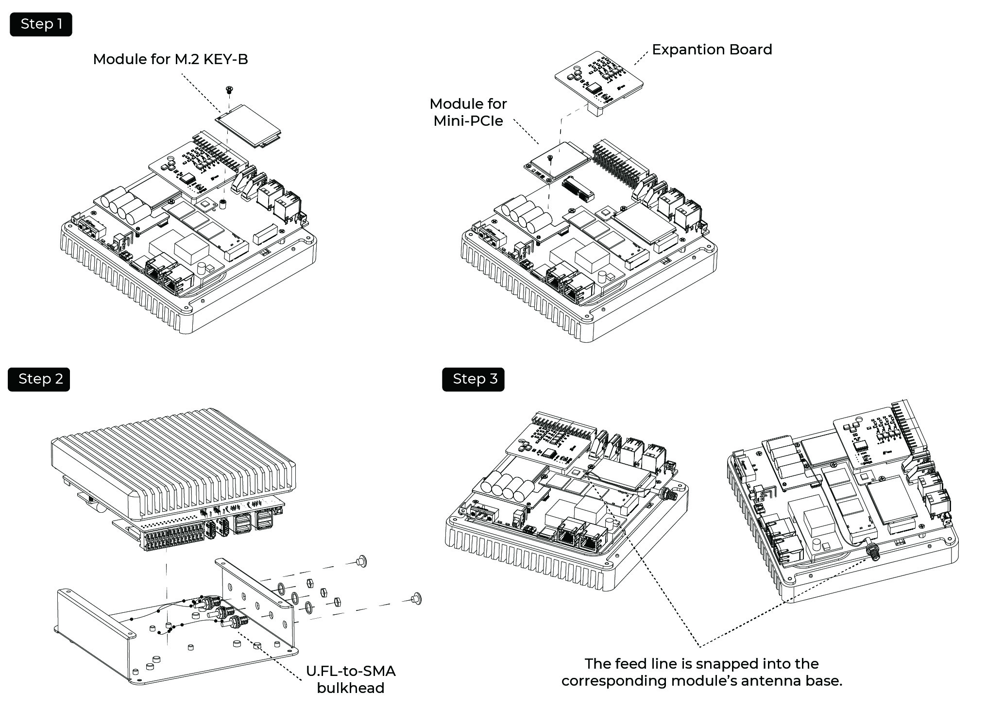

Assembling 5G/4G/LoRa® Module and Antenna​
Step 1: Remove the Expantion Board and load the 4G module/LoRa® Module into the Mini-PCIe/M.2 B-KEY slot and lock the screws.
Step 2: Connect the feeder to the antenna hole on the housing as shown in the following diagram.
Step 3: Install the feeder into the antenna base of the corresponding module.

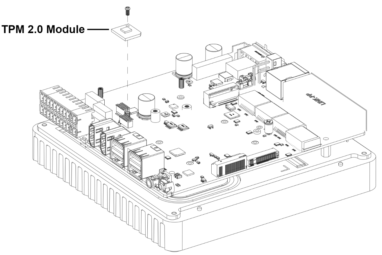

Assembling the TPM 2.0 Module​
Step 2: Load the TPM 2.0 module into the J26 socket.

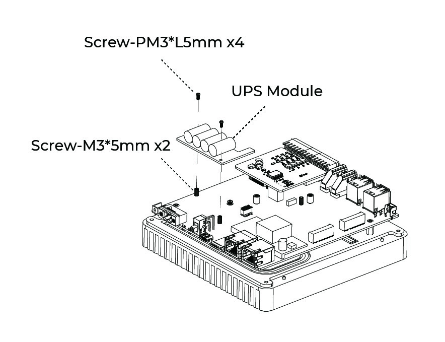

Assembling the UPS and PoE Module​
Step 1: Before installing the UPS and PoE module on the CM5 module side of board, disassemble the entire device following the disassembly guide provided.
Step 2: Install the UPS Module**
  • Using two PM2.0xL5.0 screws and M2.0x5.0 standoffs, secure the UPS module onto two holes without metal contact pads.
  • Make sure the UPS module is aligned properly and firmly attached using the provided screws and standoffs.
