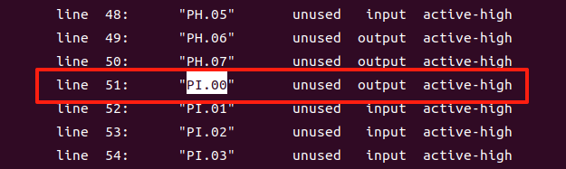

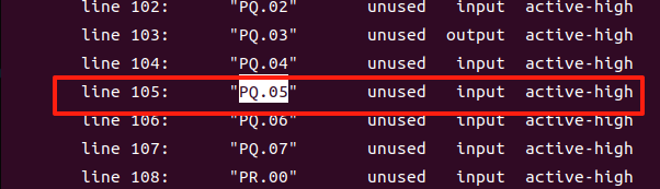

Before connecting PoE cameras, you need to enable the PoE function for the 4 Ethernet ports. Enable it as follows:
- Jetpack 5.1.x
- Jetpack 6
sudo -i
cd /sys/class/gpio
echo 315 > export
cd gpio315
echo "out" > direction
echo 1 > valuesudo apt update
sudo apt install gpiod
gpioset gpiochip2 15=1

Connection Overview for DI
You can make the connection for DI by following the diagram below. It is better to add a resistor in series for the DI line. Here we have tested with a 4.7kΩ resistor connected to the DI1 pin.
Usage for DI
You need to input a voltage of 12V on the DI line in order to get detected as an input. The command to enable DI / DO is different between Jetpack 5 and Jetpack 6.
- Jetpack 5
- Jetpack 6
Step 1: Make the connetions as shown above to DI1 pin and input 12V
Step 2: Open the GPIO for DI1 as follows
sudo su
cd /sys/class/gpio
echo 453 > export
cd PQ.05
You can refer the DI/ DO Pin Assignment Table to find the GPIO number and BGA number. In the above example, for DI1 pin, GPIO number is 453 and BGA number is PQ.05
- Step 3: Execute the following to check the status
cat value
If it outputs 0, that means there is 12V input. If it outputs 1, that means there is no input voltage.
Step 2: Check the line offset of DI1 on chip0, :
gpioinfo gpiochip0
Find the corresponding line offset based on the BGA number. The line offset of DI1 is 105.
- Step 3: To read line offset 105 in gpiochip0, corresponding to DI1:
sudo gpioget gpiochip0 105
An output of 0 indicates a low level. An output of 1 indicates a high level.

Connection Overview for DO
You can make the connection for DO by following the diagram below. It is better to add a resistor in series for the DO line. Here we have tested with a 4.7kΩ resistor
Usage for DO
Here you need to connect a load as mentioned in the above diagram. The easiest way to test this would be to connect a multimeter if you have access to one, or else connect a load that requires less than 40V maximum voltage. The command to enable DI / DO is different between Jetpack 5 and Jetpack 6.
- Jetpack 5
- Jetpack 6
Step 1: Make the connetions as shown above to DO1 pin and input 40V as max
Step 2: Open the GPIO for D01 as follows
sudo su
cd /sys/class/gpio
echo 399 > export
cd PI.00
echo out > direction
You can refer the DI/ DO Pin Assignment Table to find the GPIO number and BGA number. In the above example, for DO1 pin, GPIO number is 399 and BGA number is PI.00
- Step 3: Execute the following to turn on the pin
echo 1 > value
Step 2: Check the line offset of DO1 on chip0, :
gpioinfo gpiochip0
Find the corresponding line offset based on the BGA number. The line offset of DO1 is 51.
- Step 3: Use the following command to control the state of DO1:
# set to 12v
sudo gpioset --mode=wait gpiochip0 51=0
# set to 0v
sudo gpioset --mode=wait gpiochip0 51=1
The command format is as follows sudo gpioset <gpiochip> <line>=<value>.
If the load is turned on or the multimeter outputs the voltage that you have input, the test it is functioning properly.
